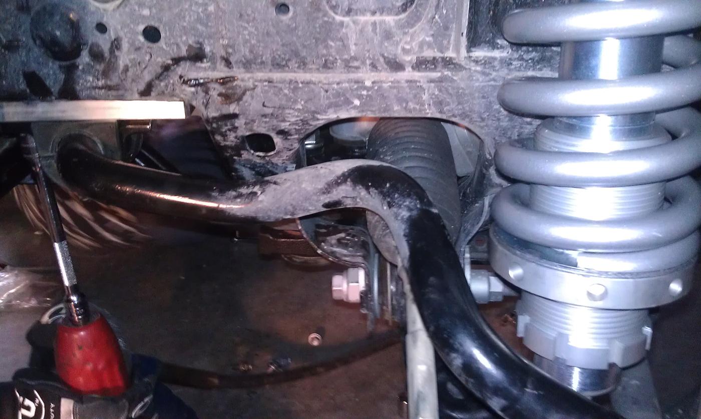

The sway bar relocate is primarily used due to the shocks used. For me, running a 2.5 setup, the sway bar would hit the coilover without the relocate. That is probably why toytec said it's not needed in the kit you have listed, the spring diameter isn't big enough.
Yeah the diff drop is not really needed if you stay under 3" up front.
And I agree on the UCAs. Eventually you will want them.
Here's a pic. It's just a simple (silver) spacer that relocates the mounts forward and down.

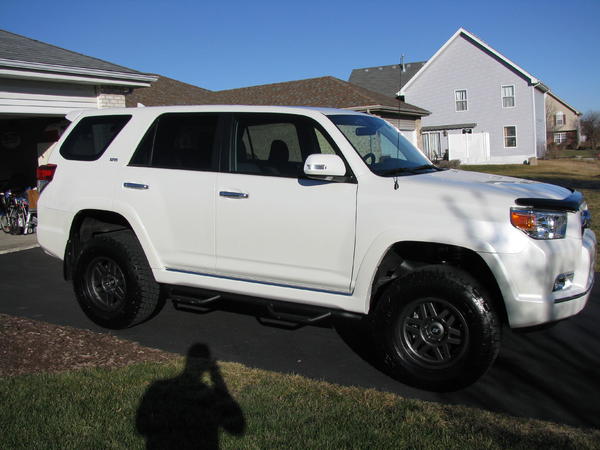

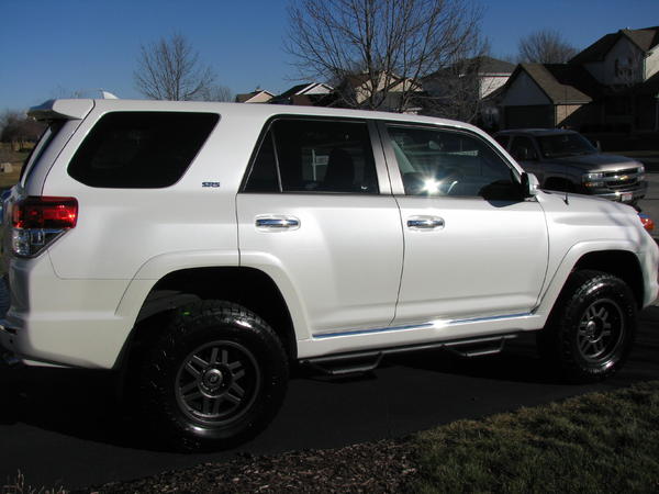

Got the lift install and all the other mods I'm going to do for a while. I love the SCS wheels! Rides better than factory in my opinion!
I can't figure out how to post pics to a thread but I was able to put them in an album in my profile. Heres the link...hope it works! Thanks for all the advice here! Seriously, this isn't possible without everyones help and the time others have put into this for other people. Great community here!!
Toyota 4Runner Forum - dk7191's Album: Blizzard Pearl
Dan
Dan looks good. I have always told myself if I had to do it all over again it would be in Blizzard Pearl.

Your lift looks awesome!
