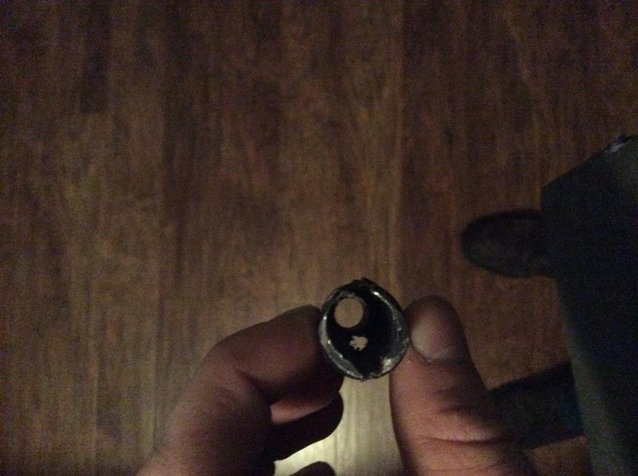

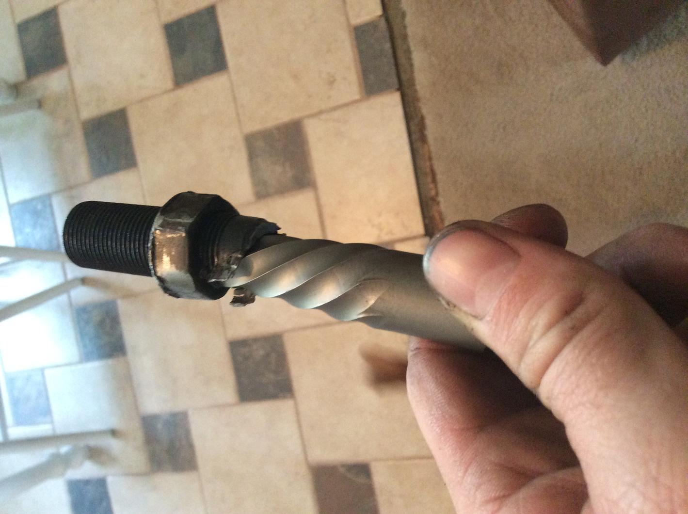

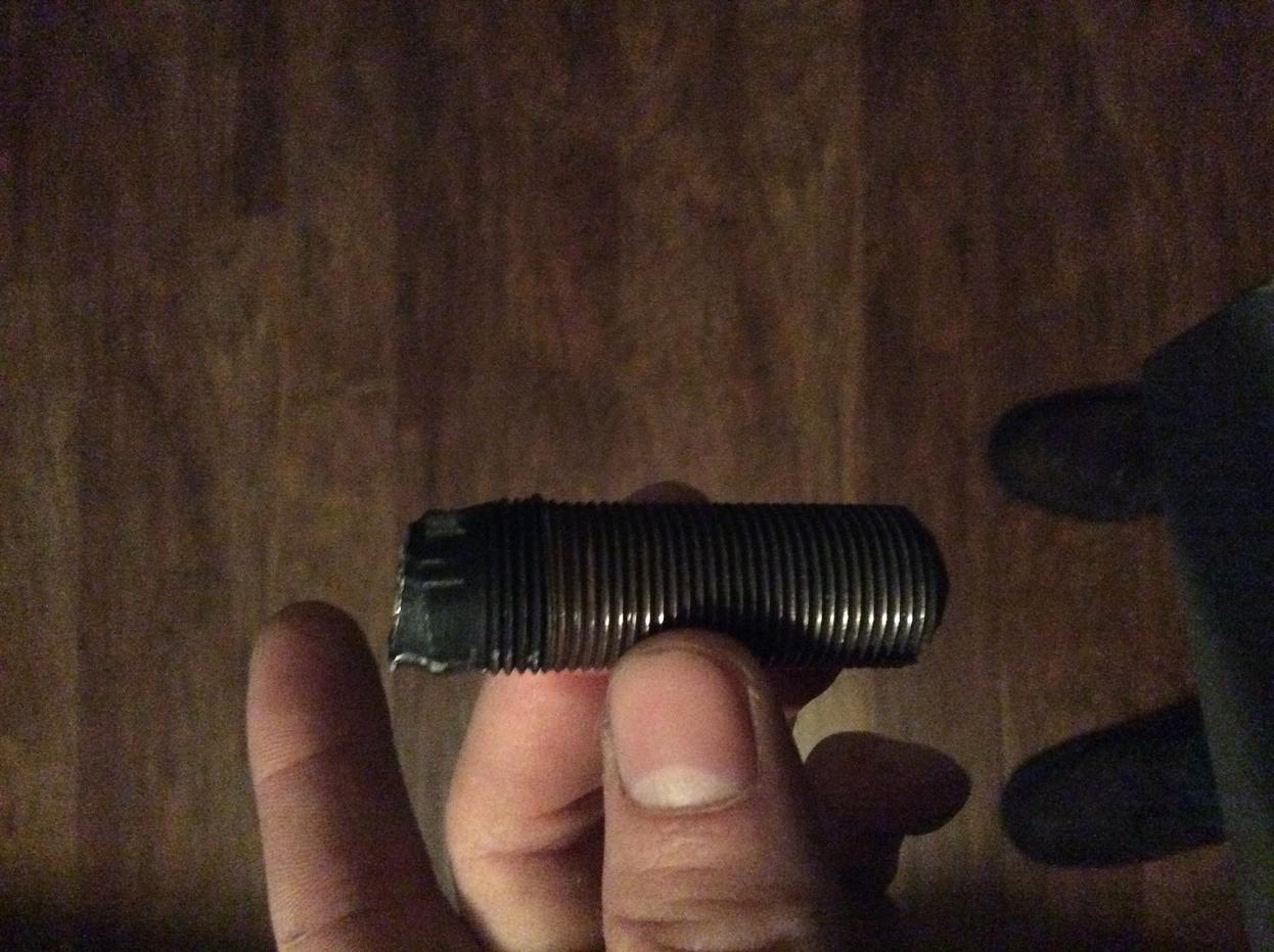

I managed to get it though. Drilled it out with a 1/2" drill bit and then used a screw extractor. Had to use my cheater bar and put a significant amount of torque on it before it finally broke loose. Ill post a picture of it when I get home.

as promised.....
