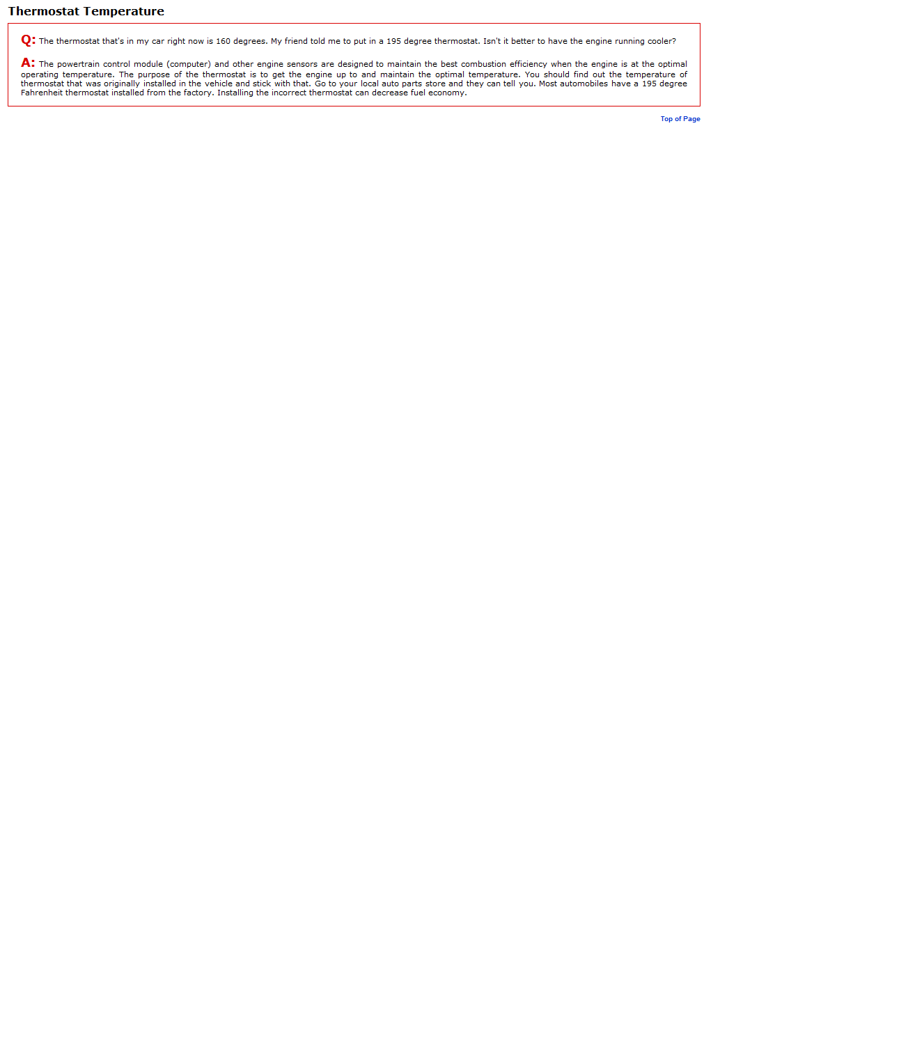

running with out a t-stat will make it over heat more because there isnt enought time for the heat to transfer before the water moves
Explain this a little more please.
From my understanding, there are certain temps of thermostats for a reason. Basically to keep the engine within a target heat range.
In my mind, running without a thermostat will cause the motor to run too cool... Not heat up to the proper temp range to make the motor run most efficiently. kind of the opposite of what you're saying.
*EDIT* Found from a quick google search:
Auto Upkeep - Frequently Asked Questions about Automotive Cooling System
For the clicky impaired :)
