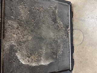

only fix for this problem is to remove radiator and clean all the bugs and dirt from it or just replace the radiator. Included a photo of my 2022 limited radiator with this common problem.
