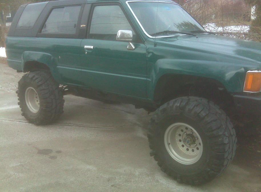

Have a '88 4runner that randomly overheated I think while driving it the other day. Typical steam started coming out ront left of the hood and when I pulled over and popped the hood the coolant was all over the inside, mostly down towards the front driver's side wheel well. In looking for a leak however I couldn't find one but the coolant was drained. From the spraying it looked to be a tiny hole as it spray all over the place. The car started back up no problem but I didn't drive it and opted for the tow home. Any suggestions? Much appreciated.
