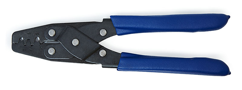

I watched the video... I noticed you decided to solder the terminals on the Bussman box.
Do you know which crimp tool is recommended for those who prefer a crimped connection?
[MENTION=172861]WanderlostOverland[/MENTION]
This is a quote from where we gained our info on assembling the Bussmann box. We provide a link to his DIY website in the video description on Youtube;
"In order to crimp Metri-Pack and Weather-Pack terminals, you’ll need a special crimper. The T-18 crimper is a low-cost tool that allows you to crimp 24-14 AWG wire as well as Weather-Pack, Metri-Pack 150 and Metri-Pack 280 cable seals. This tool can be purchased from Amazon or Del City."
Although this special tool will work better, we saved money by simply crimping our terminals with needle-nose, like shown in the video. You likely also noticed that, in addition to soldering our terminals that were installed into our box, we also crimped them.

Thanks... I didn't realize its the same connector as the GM / Delphi stuff. I actually have a crimper for that already.
I really like soldering, I have a professional soldering station, a couple of them actually, but for automotive application I much prefer crimping...
Without turning this thread into a soldering vs crimp debate, there are some cons surrounding soldering in automotive or vibration applications.
A proper crimp is also mechanically very strong when done right, I can't pull apart my crimps without tearing the wire from the connector.
