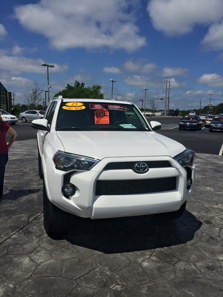

Got the 5th gen in May of 2015 after going on an Overland Trip to South Dakota in out 2wd 4th gen and getting hopelessly stuck.
Whether that has always been the driving factor in how the truck has turned out today I'm not sure but probably lol.
Anyway it started out simple.
overlanding_usa-albums-5th+gen+4runer-picture43700-0551235b-3924-4eb4-89c2-7e15e11e9581.jpg
But didn't last to long:

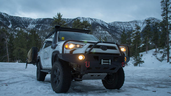

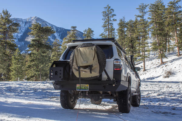

Current Mods:
Suspension:
Front
-Bilstein adjustable shocks set to .85 inches,
-OME 887 springs
-Light Racing UCA's
Rear
-Bilstein 5100's
-OME 889 springs
Wheels and Tires:
-TreadWright Guard Dog 285/70/17 MT tire (33.2 inches)
-Stock 4th gen 4runner wheels
-Spidertrax 1.25" wheel spacers front and back
Armor:
-Relentless Fabrication Predator front bumper
-Relentless Fabrication Bolt on Rock Sliders
-Relentless Fabrication Front Aluminum Skid Plate
-Relentless Fabrication Rear Bumper w/single swing arm
Exterior/Storage:
-LabRak full length roof rack
-Rino lined Fender Flairs
-Mud Flap deletes
-Land Cruiser Prado 150 Snorkel kit
Overlanding Gear:
-Geo Adventure Gear GT-165 roof top tent w/annex
-Geo Adventure Gear Manta Awning (coming Soon)
Recovery Gear:
-Smittybuilt 9.5 winch with Synthetic line
-Traction Jack Recovery Boards
-54" Highlift Jack
-Relentless Fabrication BigFoot Highlift base.
Lighting:
-Relentless Fabrication ditch light brackets
-Baja Design Sport Squadrons (currently on ditch brackets but soon to be fog lights)

[MENTION=142543]Overlanding USA[/MENTION]..Curious how are those 889's coupled w/the Bilstiens treating you with a load out? A lot here have questions on rear spring choices with suspension setups balancing weight load-outs..
So far not to many issues, the only complaint I think I would have is under high stress situations they start to overheat and not work as well. Only real time that I have noticed it though is at the end of a long trail day like when we run the Mojave rd. At the end of the day the ride can get a little rough, but for 99% of the stuff we do it is great. Plus they are still good on road which is most of my driving.
