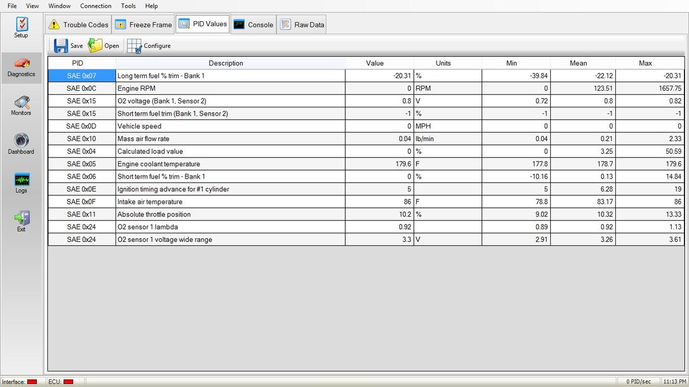

First post for me and saw this thread describing a similar situation I'm having with my 2000 4Runner. Everything began with a bad #4 injector. So I replaced all 6 injectors, cleaned TB, IAC, MAF, new intake gaskets, plugs, wires, upstream O2 sensor. Truck ran great for a few hours but on the way home it started to idle rough and stall at a stop. Seems to improve once you get out of the gate but not completely. Here is a look at codes:
Trouble Code Report
Date: 8/28/2017 7:41:49 PM
Code Type Status Description
P0300 PowerTrain Stored Random/Multiple Cylinder Misfire Detected
P0301 PowerTrain Stored Cylinder 1 Misfire Detected
P0302 PowerTrain Stored Cylinder 2 Misfire Detected
P0306 PowerTrain Stored Cylinder 6 Misfire Detected
P0172 PowerTrain Stored System Too Rich
I also have the PID data. I'm wondering if the sequence of misfires 6,1,2 points to a bad (new injector).
Appreciate any help I can get on this one.
PID Info:
