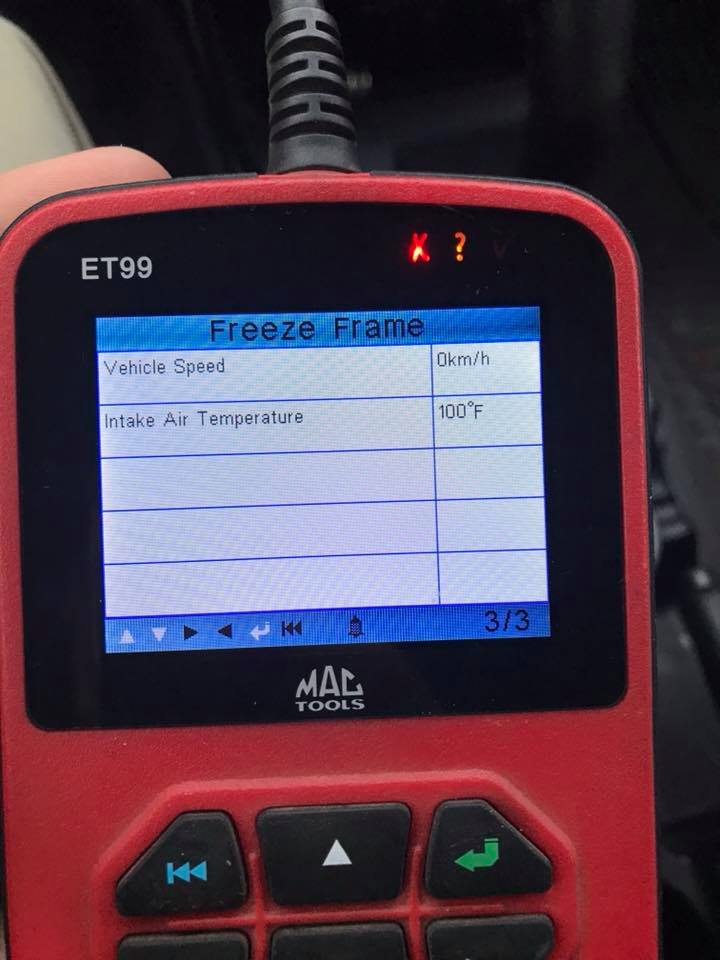

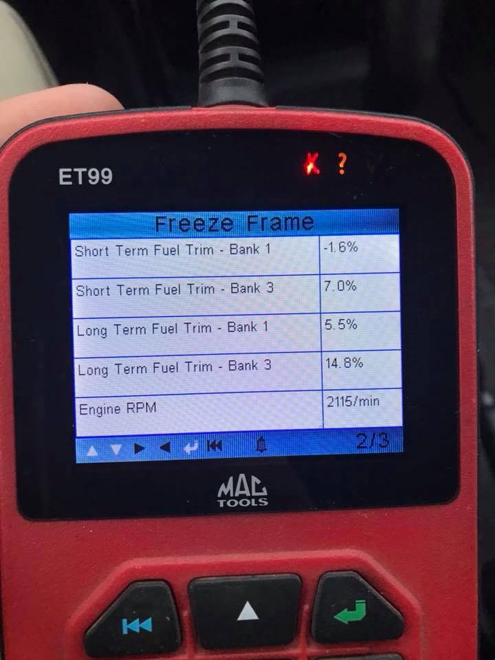

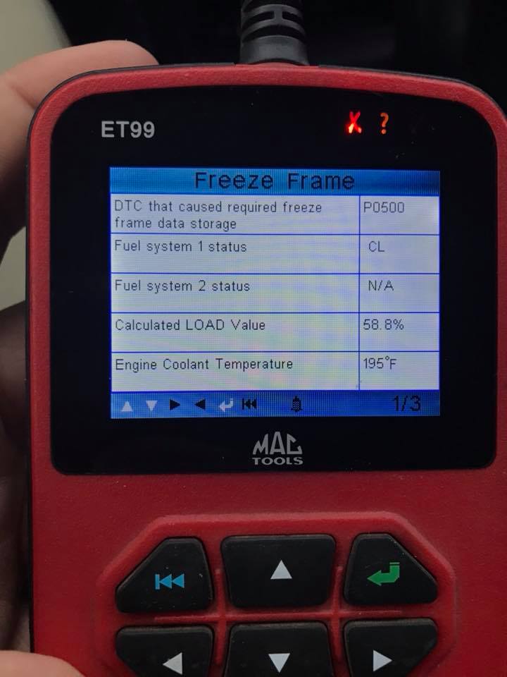

What up all? I have done the research on here and everywhere else but could not find similar symptoms as others.
I have a p0500 check engine light on. Vehicle speed sensor A malfunction.
The tranny shifts good and the speedometer works fine. I have replaced the no. 2 speed sensor on the tranny and the CEL still comes on. Also,the cruise control does not work...
The pics I’ve posted is a freeze frame from the computer reader and hopefully it has some clues
Ideas???
Thanks!

The freeze frame says you are running under load at 0km/hr. Looks like the speed signal is dropping out - sounds like it is intermittent if your tests are coming back ok. If the signal drop is momentary, you might not see it on the speedometer. You have replaced the sensor - have you looked closely at the connectors & wiring harness? Wiggle & pull during the testing.
