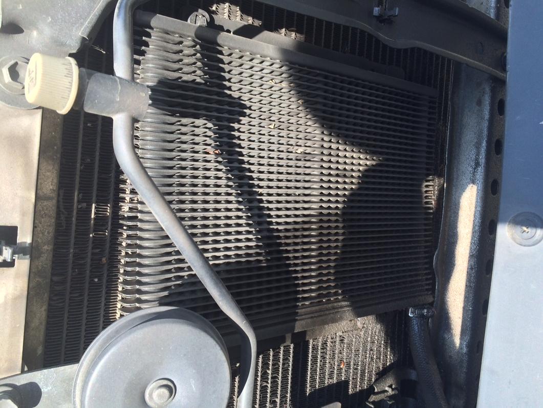

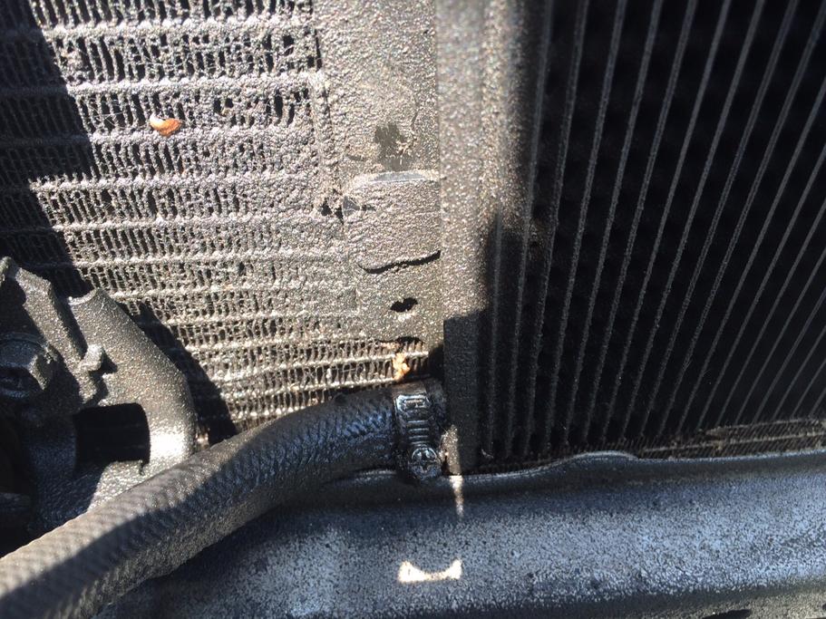

Detailed photos/diagnosis: The cooler was mounted at a slight angle which caused the lower line to rub on the bottom support. To fix this I simply clipped the two zip ties on the bottom and straightened the cooler putting in new zip ties to hold it in the proper angle. I also cut a piece of tranny tub and put it over the support to protect against anything potentially rubbing in the future.
Looks like your lines have been leaking some. That trans fluid all over your condenser and probably radiator is attracting dirt which will clog them up. You should degrease and clean that off.
