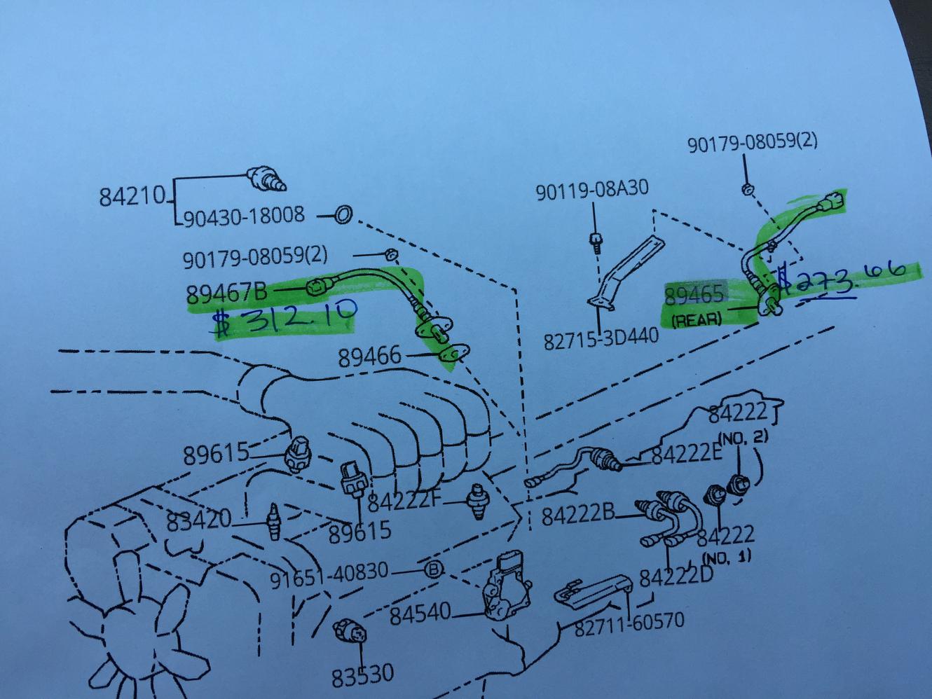

I went to the dealer and they hit me with $500 quote for the 2 sensors.
$312 for one & $273 for the other. Ouch
They had to look it up by my VIN.
You can get OEM Denso on Amazon at about $200 for BOTH, less if the front is an O2.
