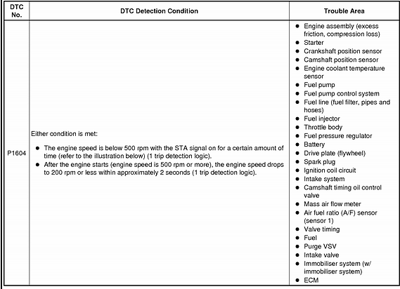

Toyota P1604 - Startability Malfunction
Possible causes might include (1) Starting system / low battery charge, and (2) Fuel system - low quality fuel / fuel filter clogged.
There is a long list of other possible trouble areas with the P1604 code - see attachment.
