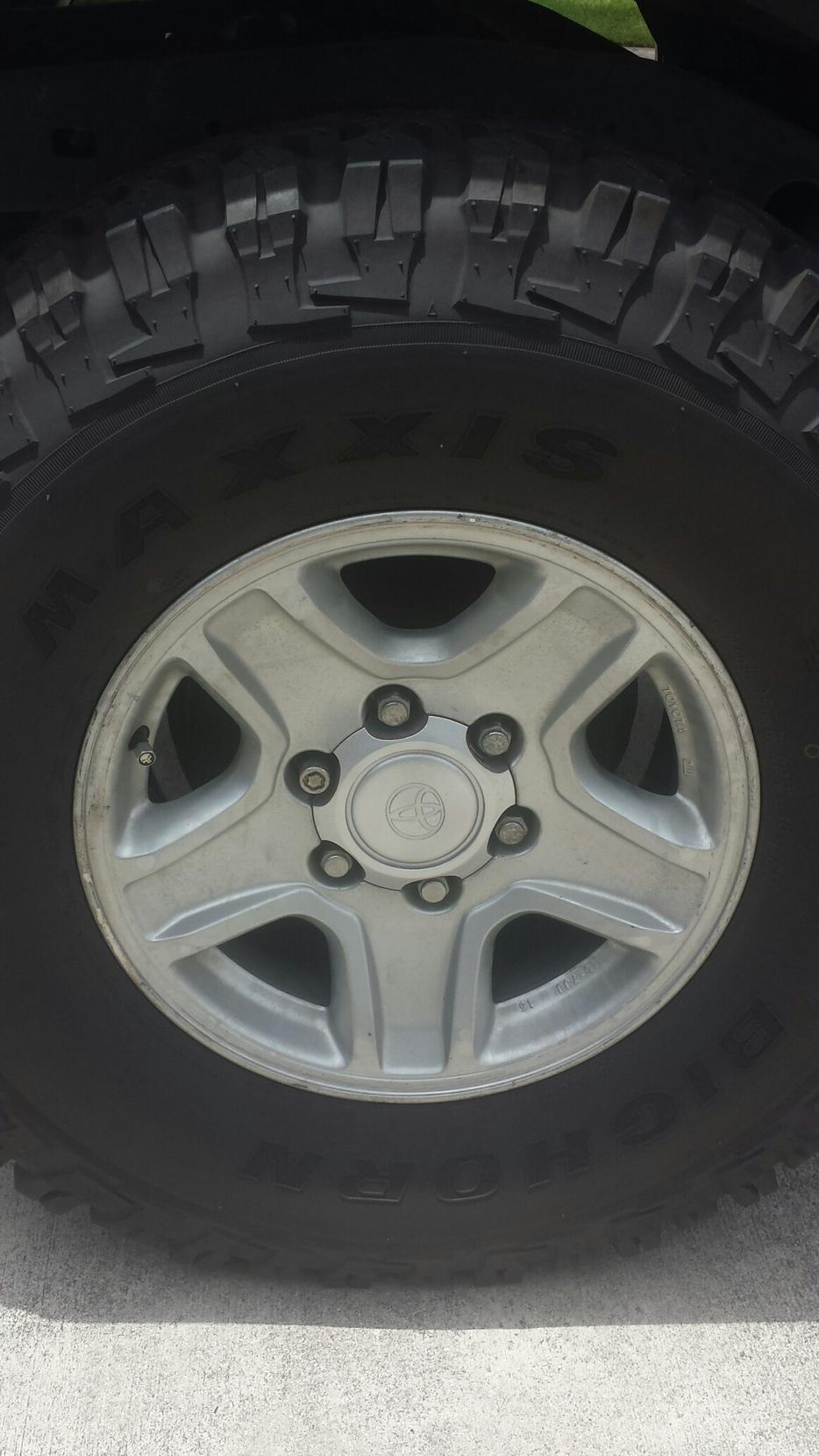

After 17 years of tire shops mishandling our center caps, mine are almost completely devoid of silver paint

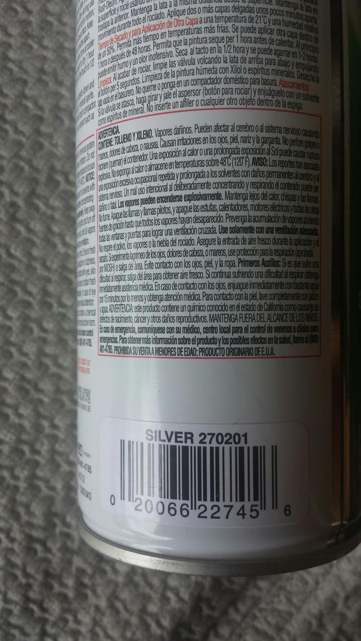

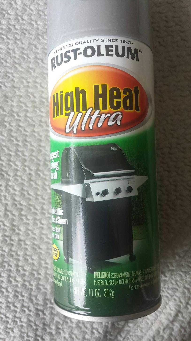

I got tired of mine looking like crap and them off and sprayed with Rustoleum high heat silver #270201 (because that's what I had on the shelf) and they came out remarkably well. The wheels are dirty but the color is quite close. Paint is cheap also.

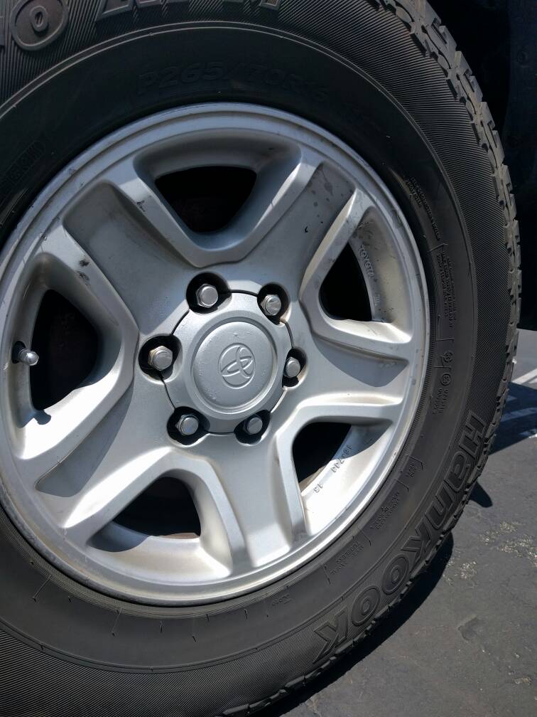

First try, did ok
I pulled the center caps and washed them inside and out with dish soap and warm water this past Friday.
After they air dried over night (yes I drove around without center caps) I hit them with acetone to loosen any remaining paint - there wasn't much, but the acetone didn't do squat.
So I hit them with some 2K steel wool and got a bit more paint to flake off and figured that was it. Cleaned with isopropyl alcohol and let air dry once again. Yep, still driving around with naked centers ;):

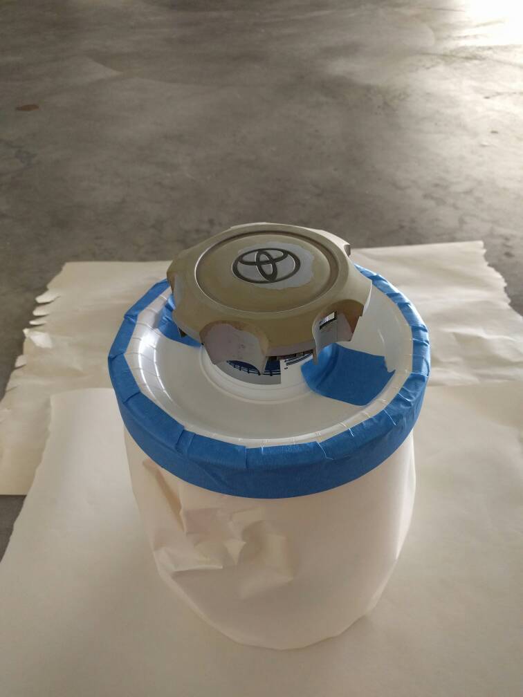

I made up a painting jig using a lazy-susan type rotating spice caddy covered in paper with an empty cream cheese jug taped on top, so I can rotate the center caps while painting. Placed that on a small bucket and went to work.
I hit each cap 3 times with the adhesion promoter then three coats of the silver metallic paint (all per instructions on the cans). I noticed some of the old paint starting to bubble up under the new paint but was like F-it and kept going, figuring I would have to redo this at some point anyhow.

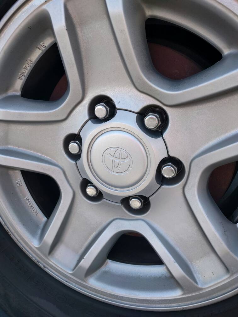

Here is how the caps look on the car after letting them air dry over night.

They look fine to me. I might have to break out the lazy susan next time I paint mine. I have one from Goodwill holding chemicals in the garage. You must be an engineer.
