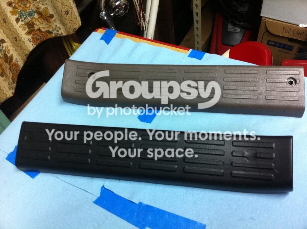

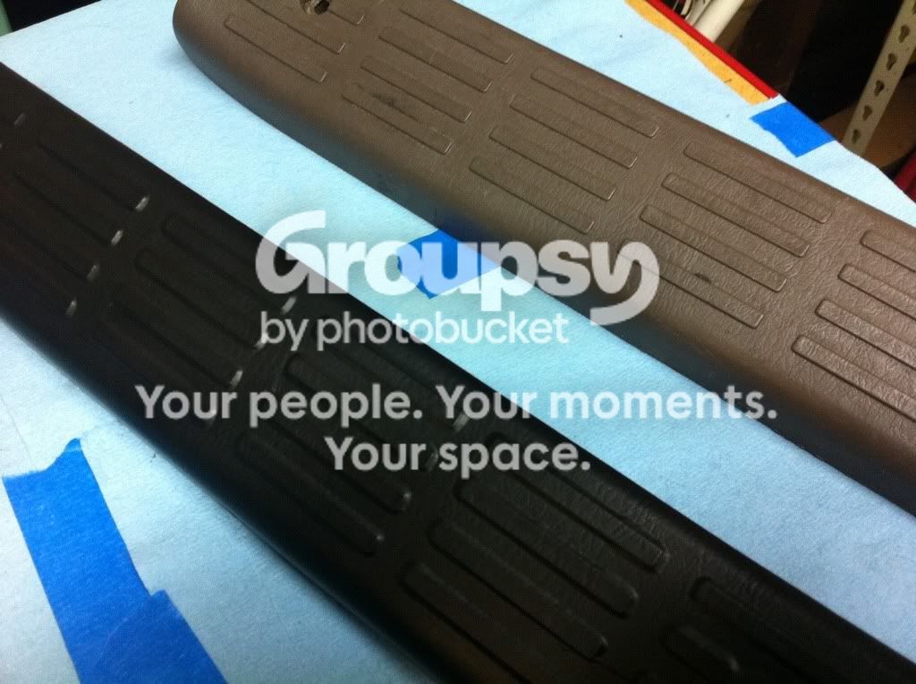

ive painted my door handles about 6 months ago and they are holding up great!
1 coat of adhesive promoter
2 coats of primer
3 or 4 coats of black
2 coats of clear
it can be done!

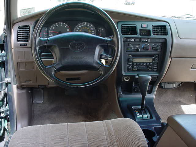

Bumping a old thread....I'm trying to do this vinyl wrap thing too. I want to do it for the whole dash and the trim, im talking dash, inside the doors, basically whatever isnt black im trying to make it black...is that possible using vinyl wrap?? heres a pic of what im trying to vinyl wrap....basically all the none black parts...
