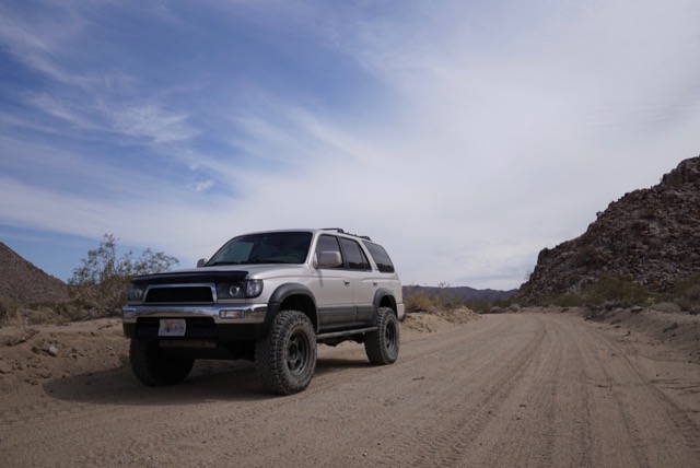

I did mine (white runner with silver cladding) as black spray on bedliner. I used duplicolor. I tried various black rattler can paints, as well as the rustoleum bedliner and liked the duplicolor best. I'll take pics once the sun comes up. Been about a year and has held up well
There are some other write ups on here. I didn't remove the cladding to paint (just the bumpers). Lots of time prepping. I also used 'adhesion promoter' just before the liner.

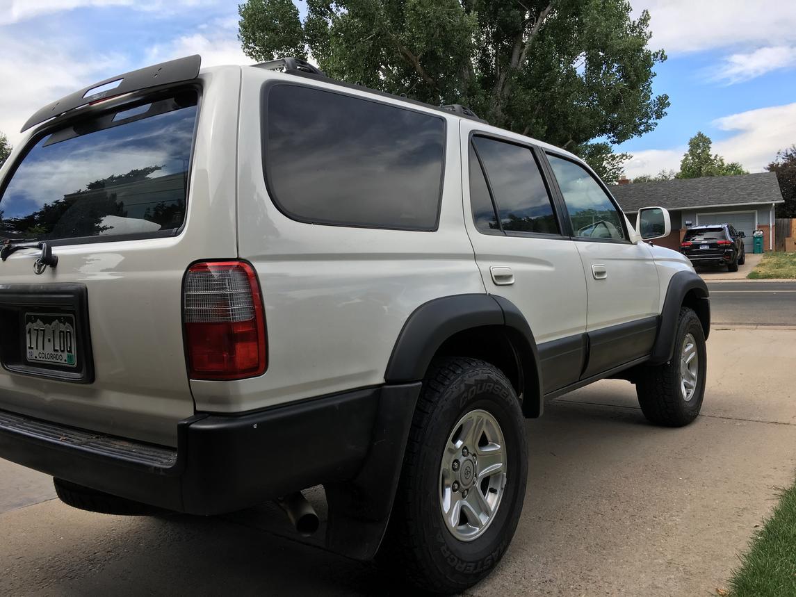

i plastidipped it black as a 'trial' but it lasted for almost an year.
I plan to strip it and do a roll-on monstaliner in silver or beige.
