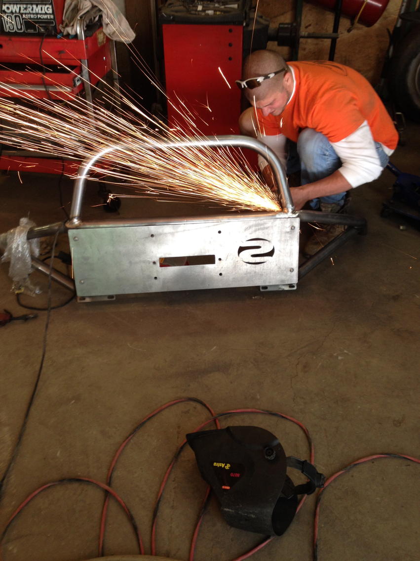

Got the grill guard welded on yesterday.
This is the second picture I've seen on T4R in the last week or so of someone grinding with no eye/face protection at all.
It's completely my opinion but I think you guys are nuts.
Carry on...
