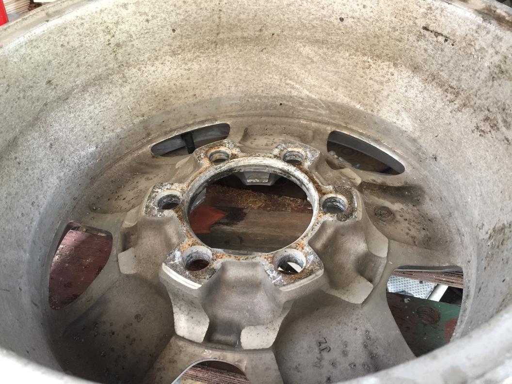

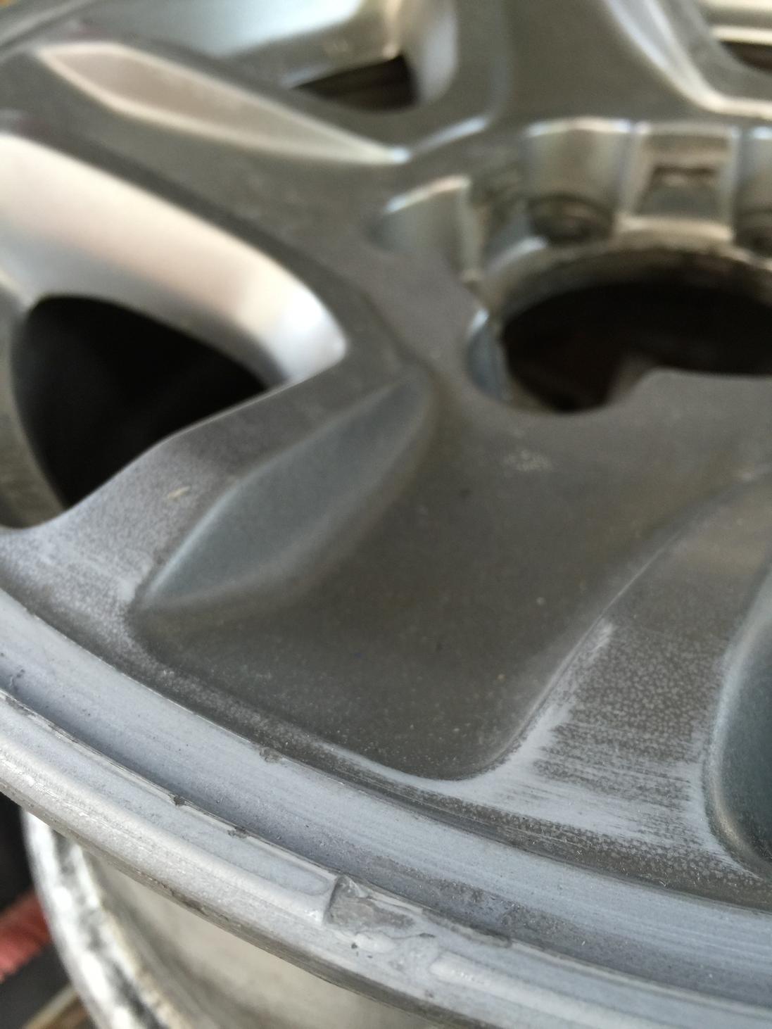

1st: thanks for NOT telling me to go read a paint your rim thread because all i do is troll this website and I've read all the painting threads...
just curious how thorough i need to be on the chips and dings on the rim...
I'm starting to sand with 220 and i feel like i am going to end up sanding everything until its all shiny metal... not just scuffed so the paint will stick,...
def going to use etching primer... so when i do that,,, should i spray then sand again more than once?
also,,,, what should i do about the inside of the rim>???
it looks so bad... maybe just cleaning it (with what product????) with something instead if sanding inside there?....
or should i even bother with the inside?
thanks for the input guys on what you think i should do..

First, spray the front of the rim with aircraft stripper. It will remove EVERYTHING, and u will be glad you did. Second, stop sanding and get yourself a wire wheel attachment for a drill.
Trust me, I've done it twice, 8 rims, both ways and the wire wheel is way faster and probably more thorough at scuffing the surface for the paint to stick. 3 light coats of self etching primer and 3 light coats of paint and they will look amazing.

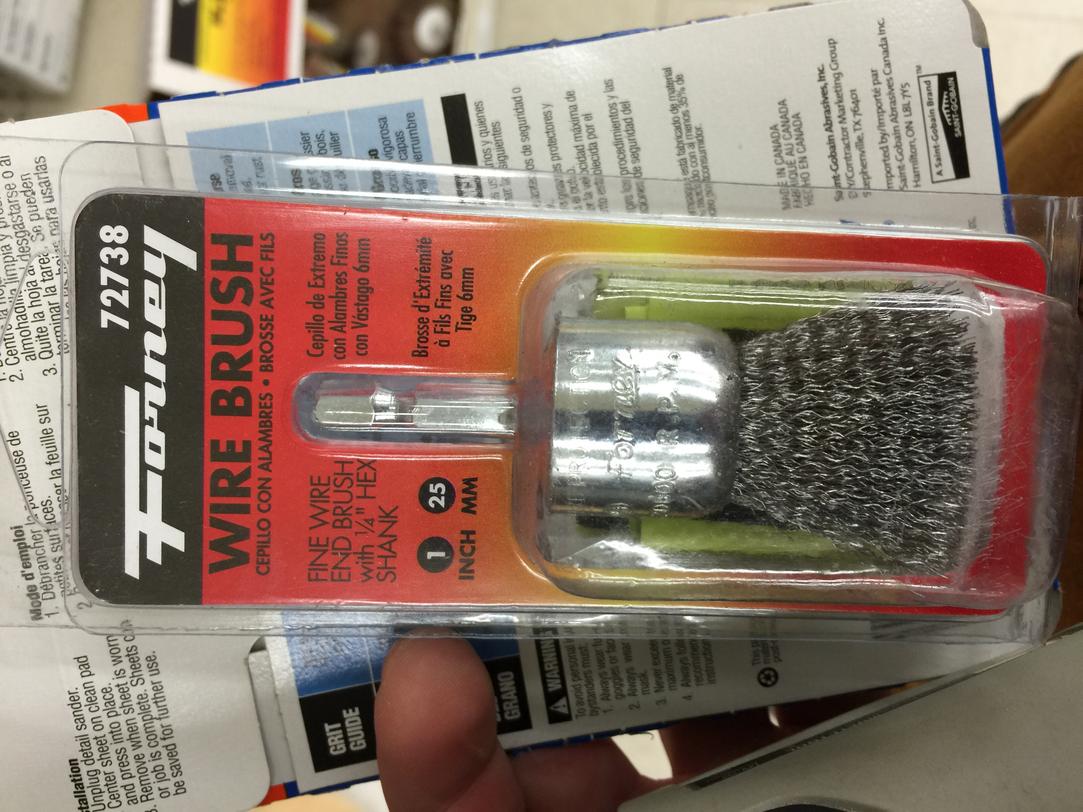

Any fine or corse wire wheel will work?...

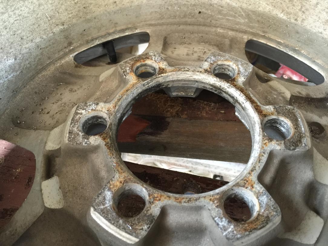

To cover your question on the back I would clean up just around the lug nut area were the rim meets the hub.. I've had vibration happen when rust builds up there.

Would this work?...

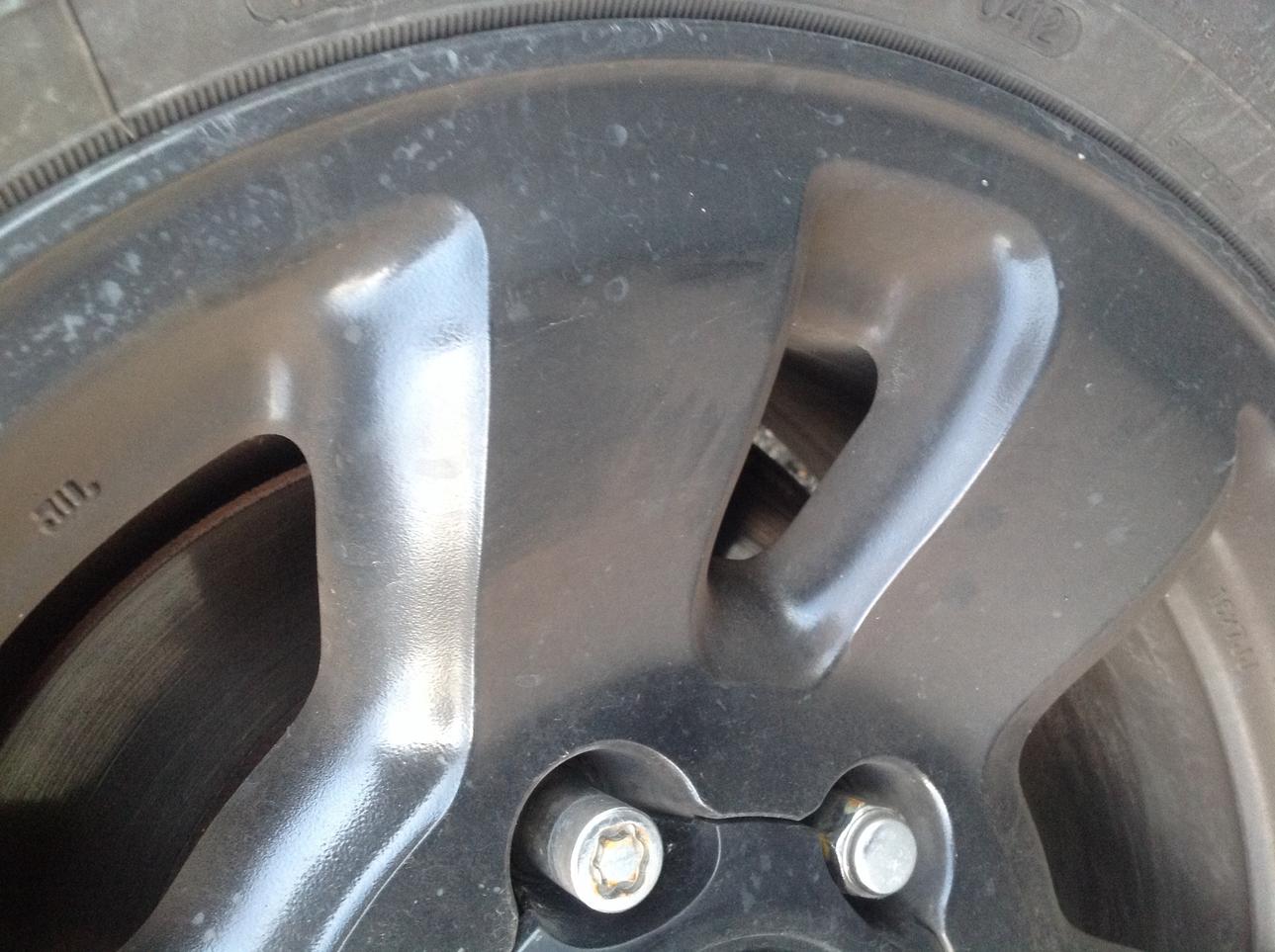

It seems like the wire wheel is scratching up the surface WAY too much.. I can get my finger nail in the little groves.....
Once you've wheeled the thing down to bare metal, use an etching primer and then a filling primer and all those little nicks and scratches will disappear.
Thanks guys.. I guess I'm just concerned these little scratches caused by the wire wheel won't fill in after the etching primer and paint... But it sounds like the primer and paint do a pretty good job at filling in these imperfections.. Like Brian said... Not going for showroom quality but if I'm going to do it, I want it to at least look a little nice if your going right up to it and looking...

I would not recommend using the wire wheel on the front of the wheel.
The wires are steel and the wheel is aluminum. It COULD make scratches that will show up later. As I mentioned - probably best to only use the "wire wheel" on the inside crevices of the truck wheel vs. the curb facing side.

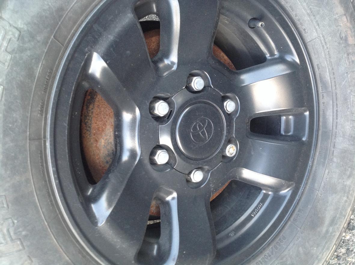

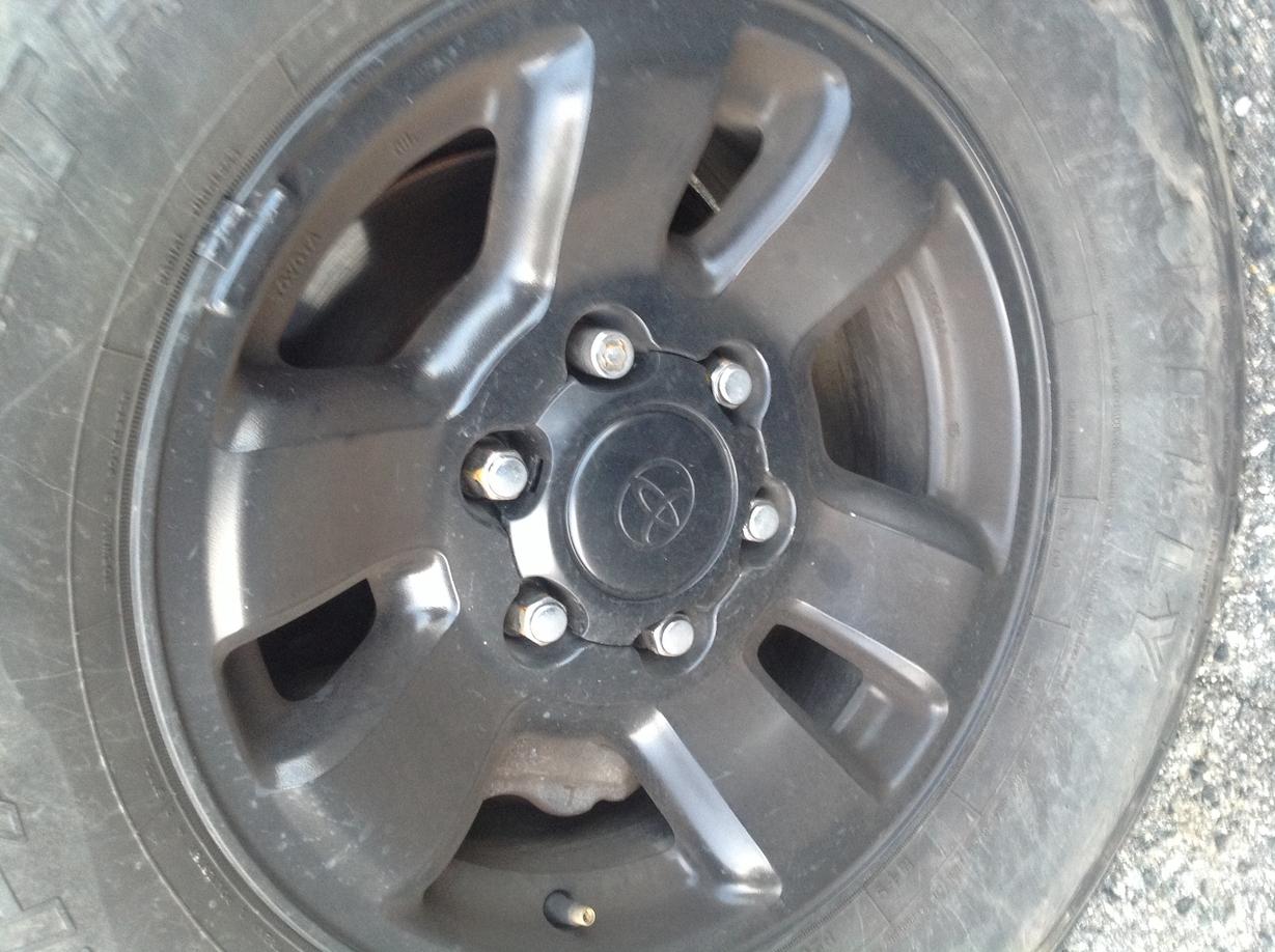

I wire wheeled the living shit out of these. After 6 total coats of paint and primer, ur good. These pics are very dirty, havnt been washed in months.
That paint remover will work fine for the tight areas that are hard to reach that still have clear coat.

I used paint remover and then a sander with 300 grit on the flat surfaces. Etching primer and VHT black[F2LJM6QCF38WIMG]http://tapatalk.imageshack.com/v2/14/12/21/96ff51f919eadab0c4b97b3722e81a5f.jpg[/IMG]

inside where lugs go
its relatively difficult to get a piece of sandpaper inside where the lugs fit...
how crucial do you think it is to get in there if using many coats of self etching primer....?
