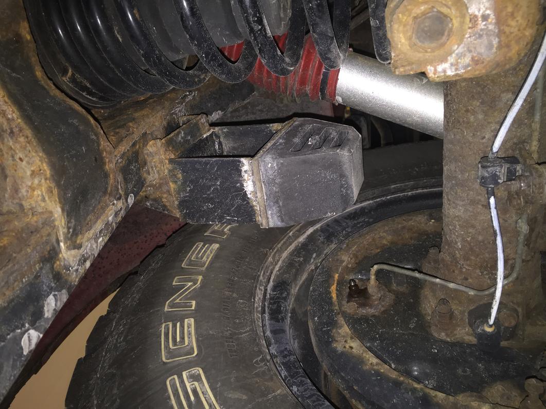

So I checked my clearance for a panhard lift this weekend and I found that I could possibly raise the axle side maybe an inch max without hitting the crossmember. I pulled the coils and bottomed out the suspension and it was pretty close. I also moved my panhard back to stock location on the frame side which had a 3" drop bracket. I noticed it was quite a bit more stable. So from what I learned this weekend is that if you extend your bump stops you should definitely go with a axle side panhard lift. It will raise your roll center and feel much more stable. I also noticed that my suspension binds more with the panhard back at stock location. My suspension actually binds up before the shocks are fully extended. So what I think I may and up doing is cutting off that crossmember and building a new and higher mounted panhard setup. We'll see if I ever get around to doing it, but I could raise the roll center a few inches and still have my axle centered and less wobble when hitting bumps.
Pic for reference of axle on stock bump stops
No problem bud. I actually noticed a difference with the panhard raised but I also get a little side wobble on bumps since the panhard is back at an angle. I'd really like to get the most out of raising the axle side but obviously that isn't going to be a simple way to go. I'm thinking cutting off the stock cross member and welding in a 2"x4" tubing as a new crossmember. That way I could probably raise the axle side 5-6" and make the frame side equal. Sounds like a lot of work but it would definitely be worth it. I'm glad I saw this thread because I would have never paid much attention to this.
Basically you can raise your panhard as much as you lowered your bump stops. I still have stock bump stops so I can't do much with the stock crossmember still there. Glad you are able to make it work with your setup though
