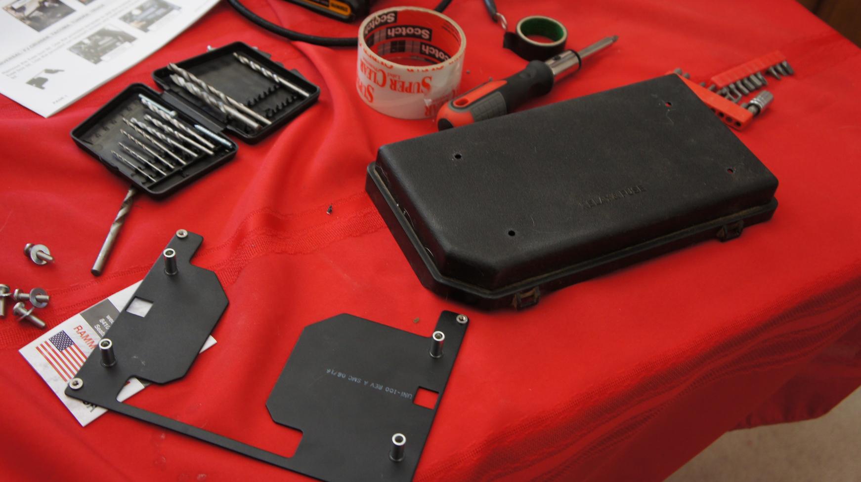

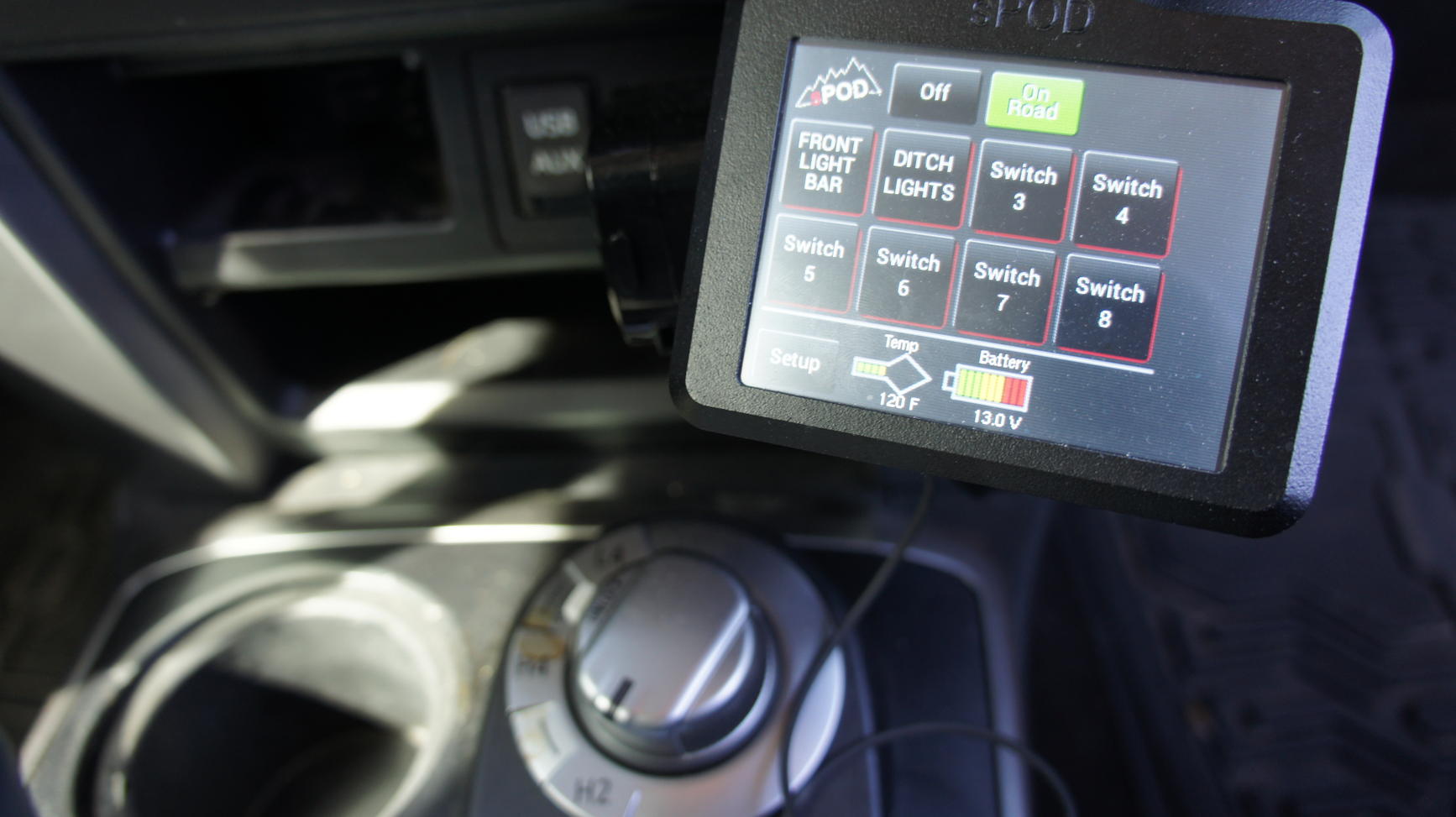

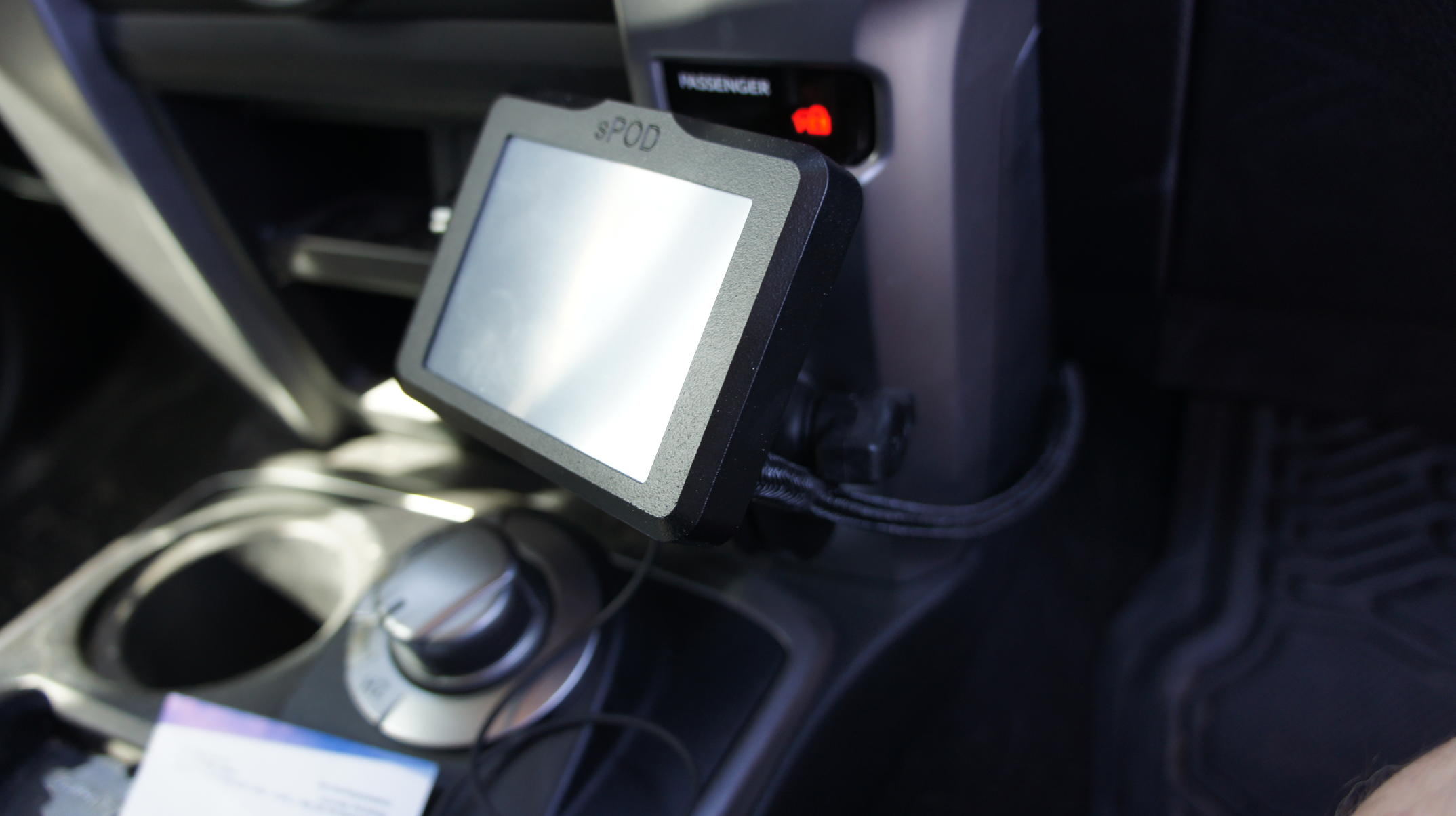

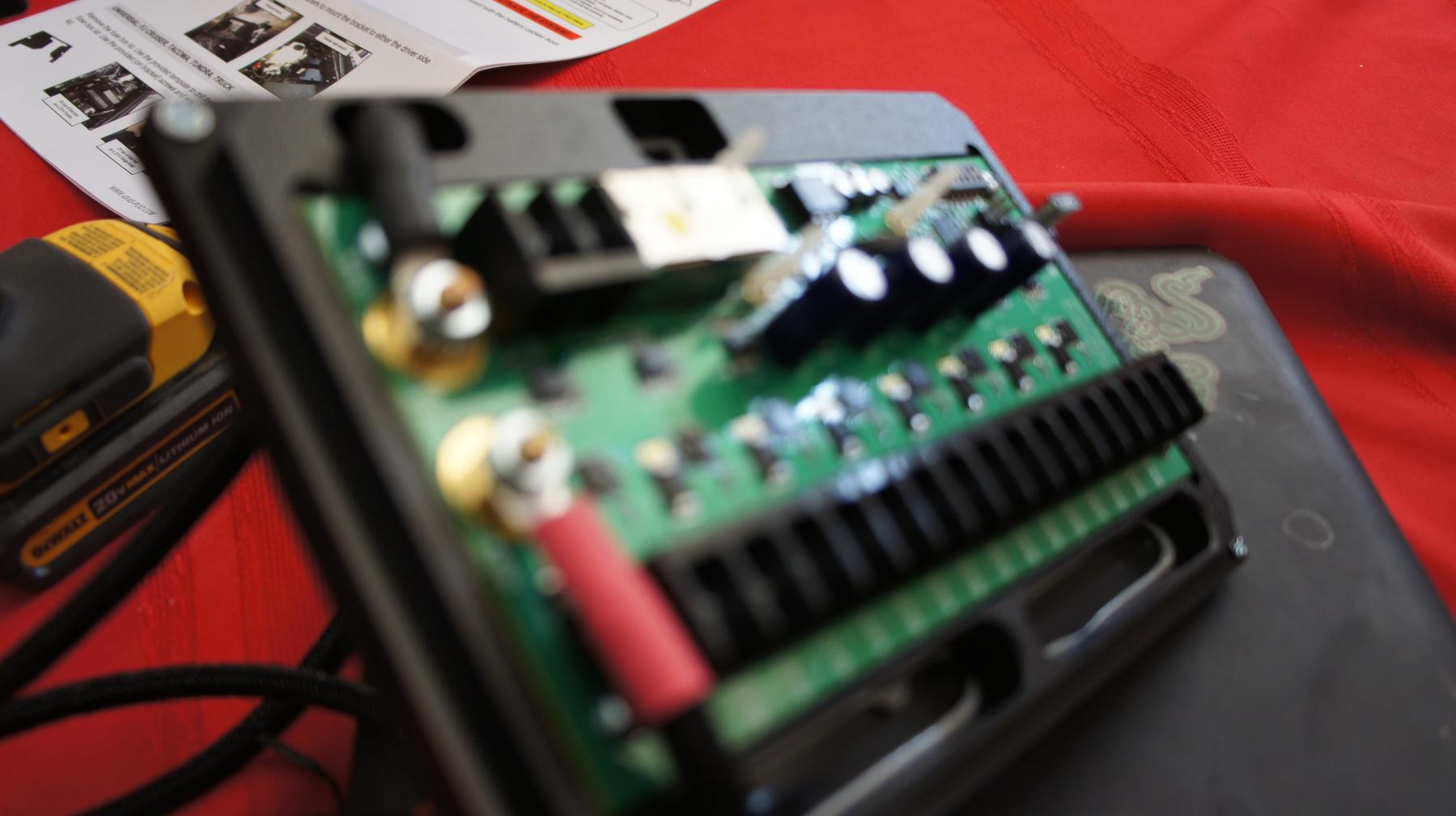

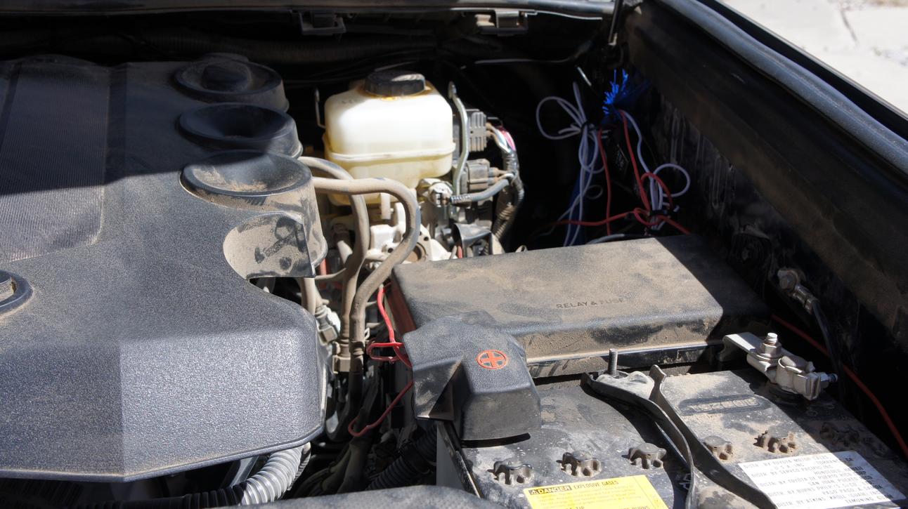

Touch Screen Spods installed. Super clean wiring worth the investment for me. Before you can see it was well a Sh1t show...

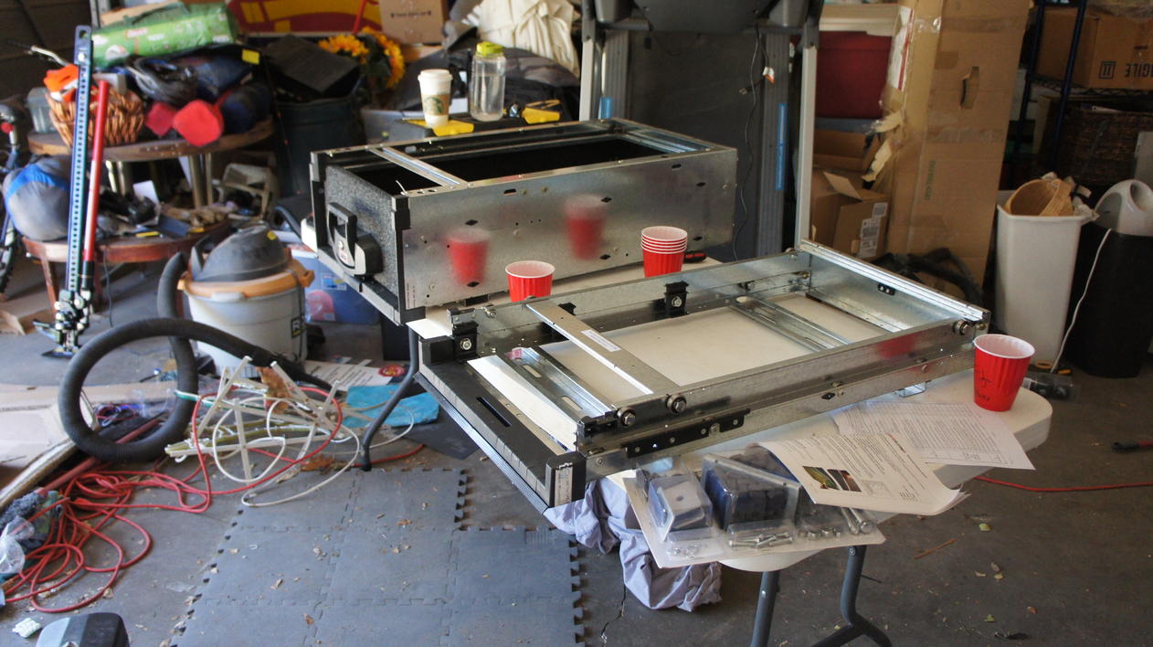

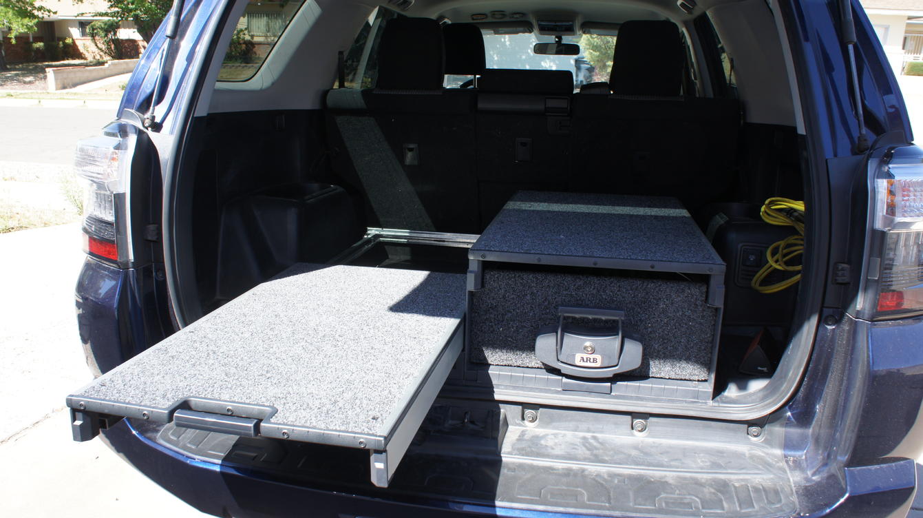

ARB Drawers installed
Arb drawers are officially mounted. Drilling into the back of my 4runner was well heart breaking but its came out nice so ill get over it. Also mounted my hi jack in prep of overland expo next month..

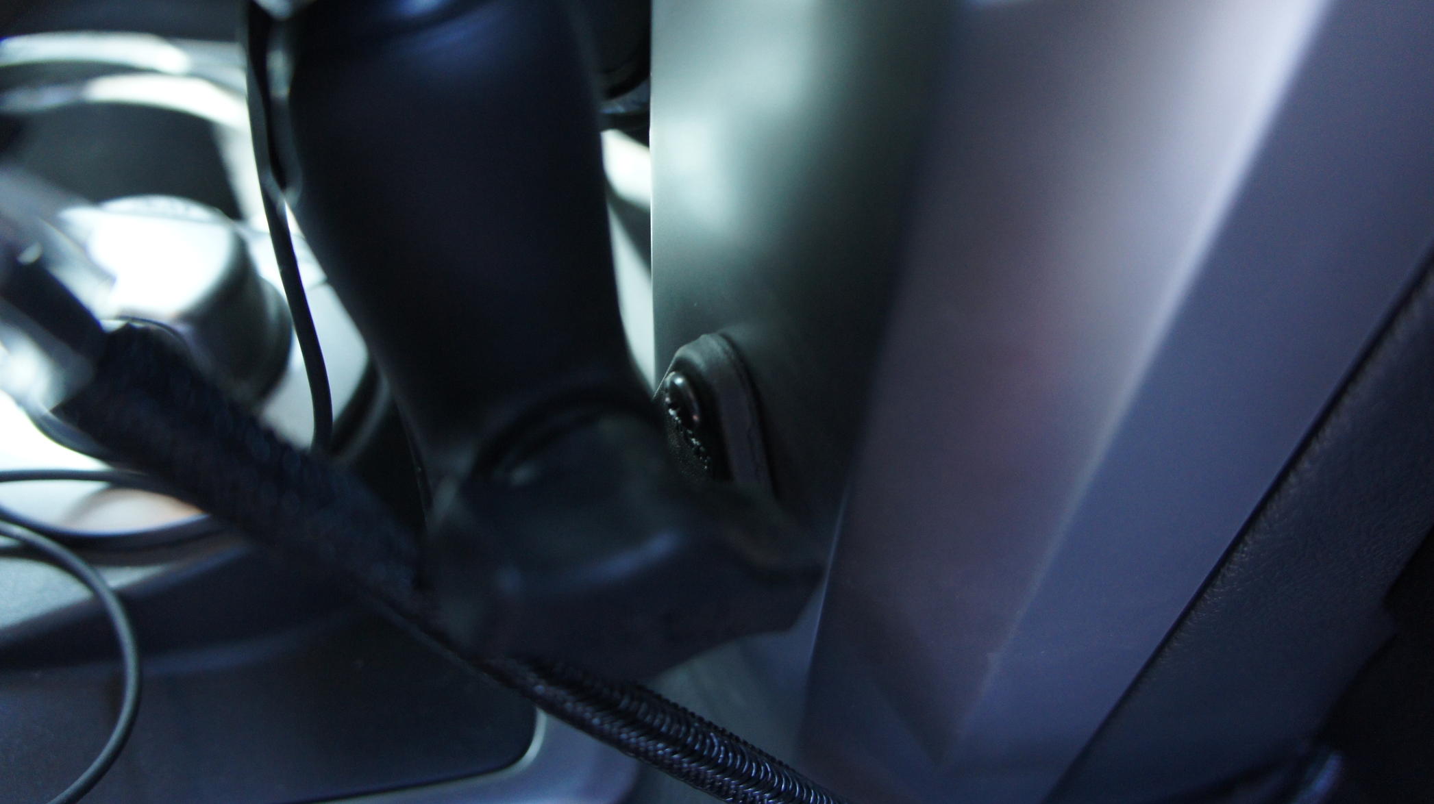

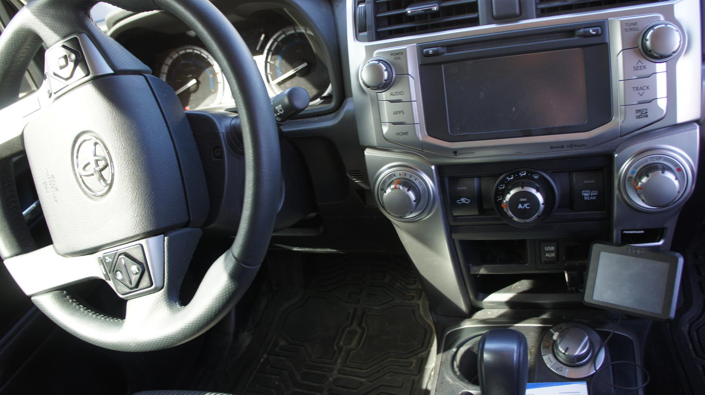

I have it mounted right above the 4wd controller knob. On the pillar along the stereo. It seemed like a good location to me but to each their own its very easy to mount anywhere you think is best, and the cable is very long so you have lots of room to work with.

Some notes about the arb drawers and installing. If you get the fridge slide just leave the slide on and take out the drawer when installing, it is impossible to reinstall the slide stops once the drawers are bolted together because they screw in from the side. Poor instructions on this given from ARB but just leave the slide on and you will be fine plenty of room to bolt it down and work on with the slide on.
Second i had some rattling the past couple days but that was because my tools were loose in the drawers, i ordered some foam and plan to cut it this weekend so the tools lay nicely pics on that once i get it going.

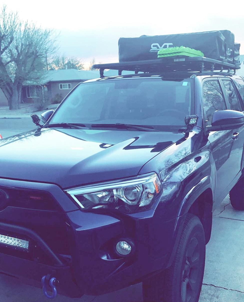

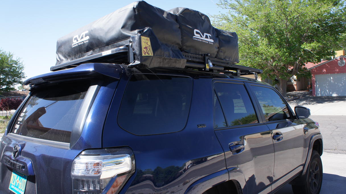

Installed Arb awning to the k9 rack this past weekend. Looks really nice can't wait to make good use of it this summer.
Just some weekend fun wish I could post some videos

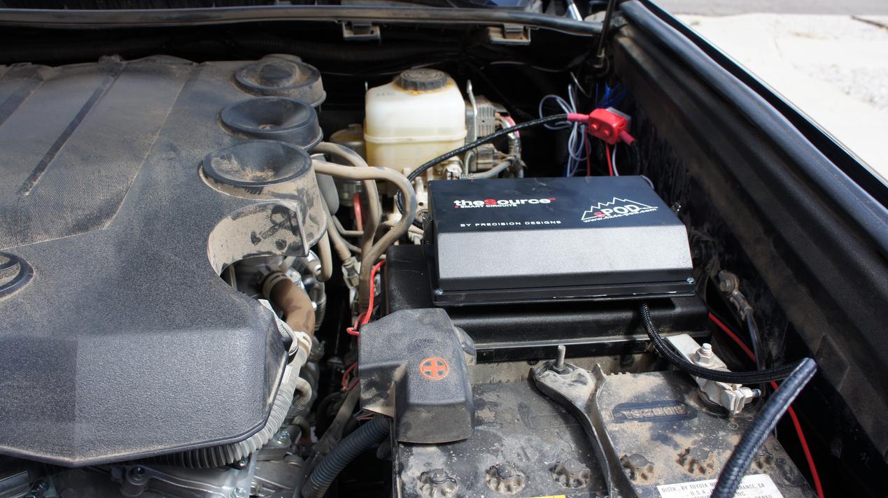

Driveway! I have lots of stuff to upload, winch installed ARB onboard compressor installed, and ham radio...
