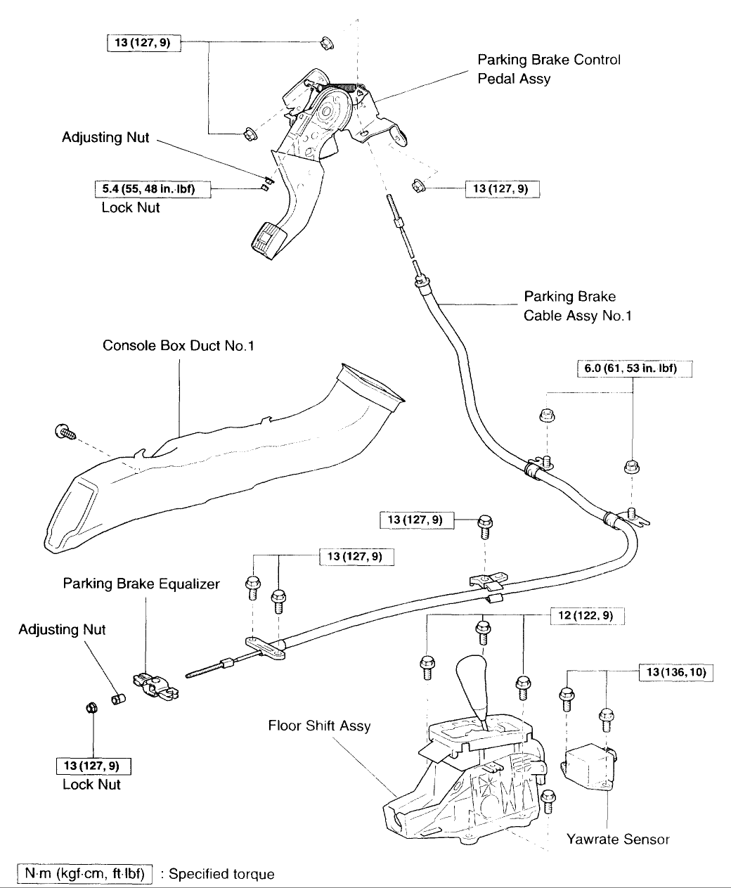

Sure, here's pics from the service manual. You have to remove the whole center console to get in there and be able to get wrenches on the adjustment screws, but it doesn't take that long..... Plus you get to find all your spilled coins and French fries once removed :)

It seems like a rather stupid design if you have to take off wheels to adjust parking brake and the put them back on to try again. I’d imagine the screw adjuster under the console is an easier trail and error process plus likely better fine tuning.
