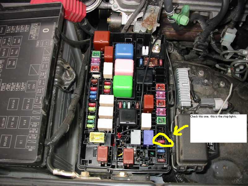

hoping you can help. My parking and rear lights doesn't come on anymore, only the headlights come on. I've looked over all the small fuses and couldn't indicated which is the issue (none were broken as far I can see) wondering if anyone know exactly which fuse it is and can point it out. I came across the issue when replaced my headlights set. Thanks.
4runnerFuses.jpg~original
Just an FYI- It's better to use a meter to check your fuses. It's possible to have a "partially blown" fuse- looks good, but just enough resistance to keep it from working.
