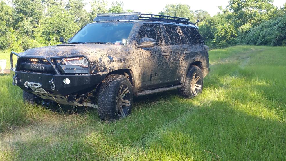

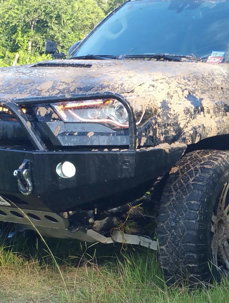

Shrockworks did mine for me. It looks like the just drilled a hole and snapped the front piece from front and back piece from back
Do they work OK, or do they constantly go off like [MENTION=50186]adio3x[/MENTION] said?
Sent from my XT1254 using Tapatalk
The work great
