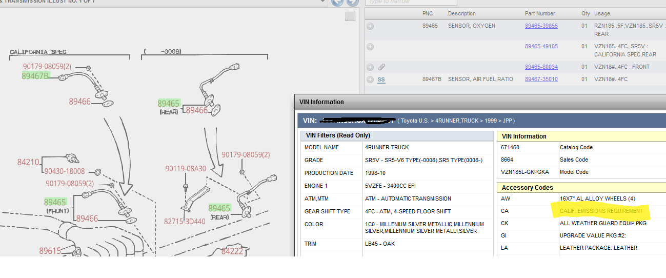

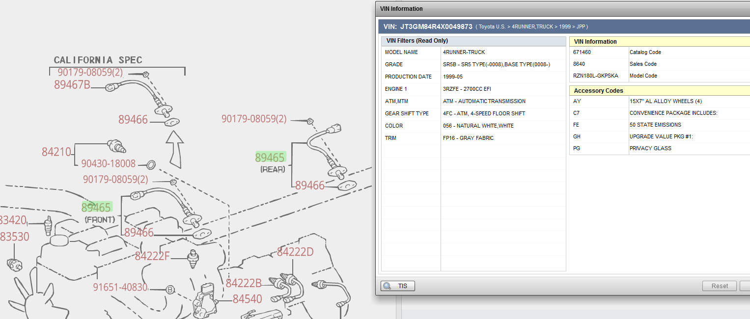

If you look at the picture you do NOT have a cali emissions truck IF YOU LOOK TO THE RIGHT yours says 50 state emissions. that is different my brother has a cali state ill post a picture showing the vin explosion similar to this first one
THE PART NUMBER FOR THE FRONT O2 Sensor is 89465-39735. The REAR sensor is 89465-39825. Those are factory part numbers
As you can see the second picture is my brothers truck and it says california emissions.

Listen to that guy ^
I plugged in your VIN and your truck shows that it's a 50 state vehicle, not a California emissions vehicle and his provided part numbers are correct.
