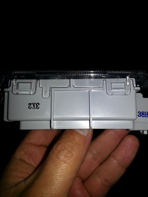

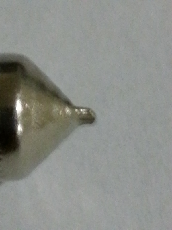

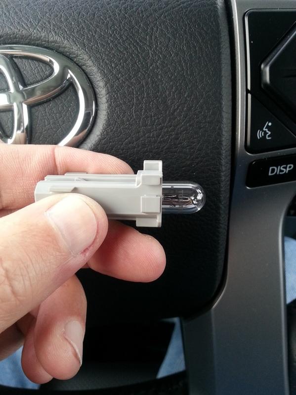

ok got the dome light in after some mod to one end. apparently the ends on the OEM buld has tapered/pinched ends and the ones from vled are rounded to a point which doesn't work for the dome on the DE3175.
you have to pinch one end to get it to sit correctly or you end up shorting out the circuit it seems.

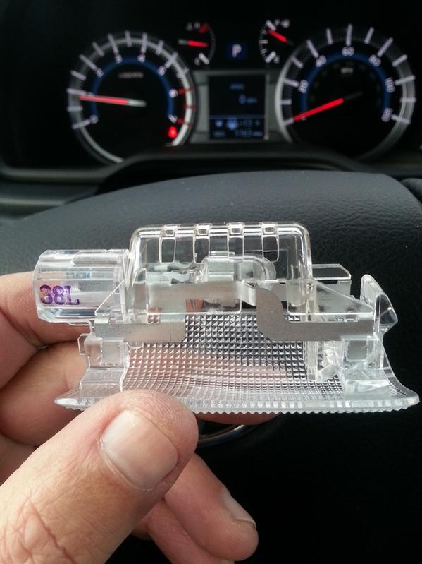

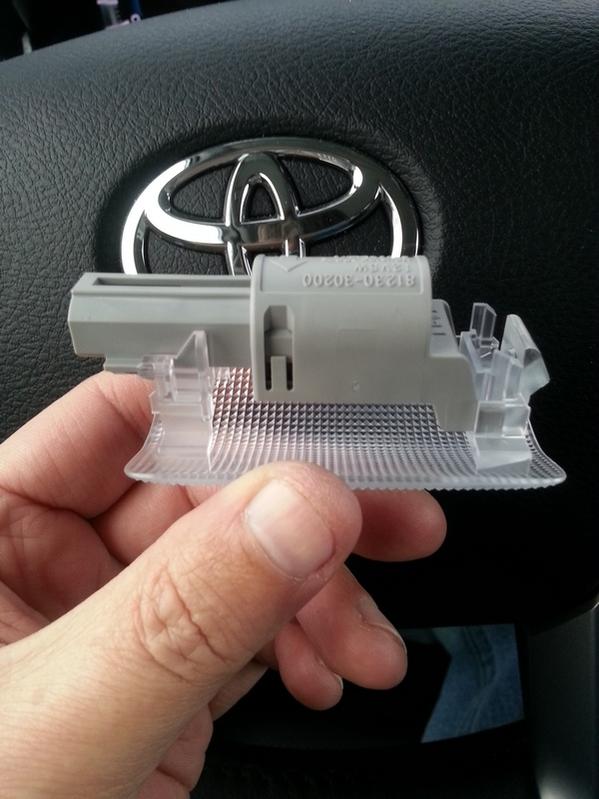

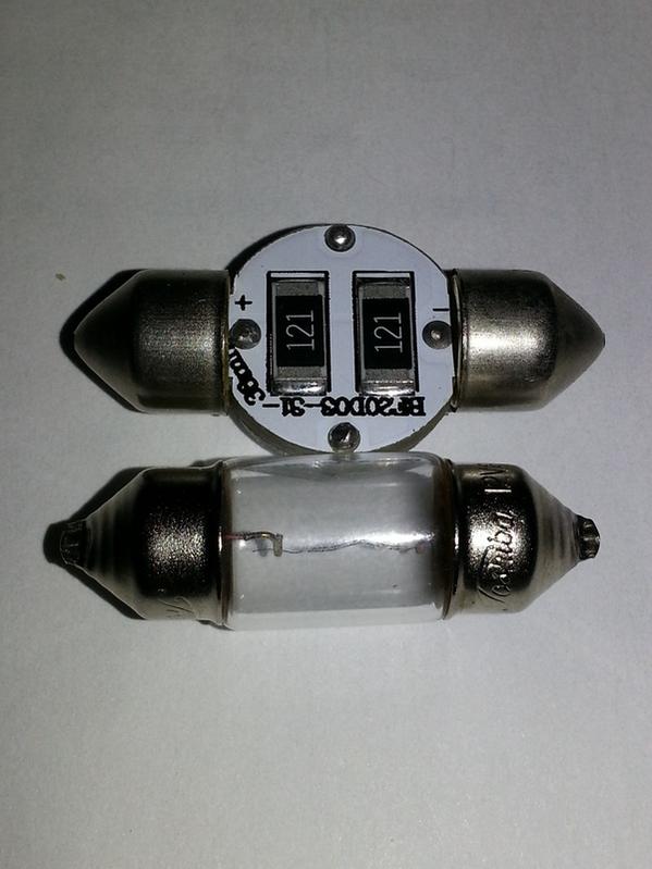

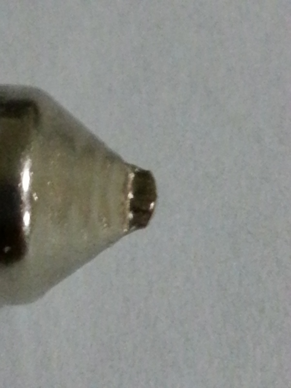

here are close up pics of the OEM dome light.

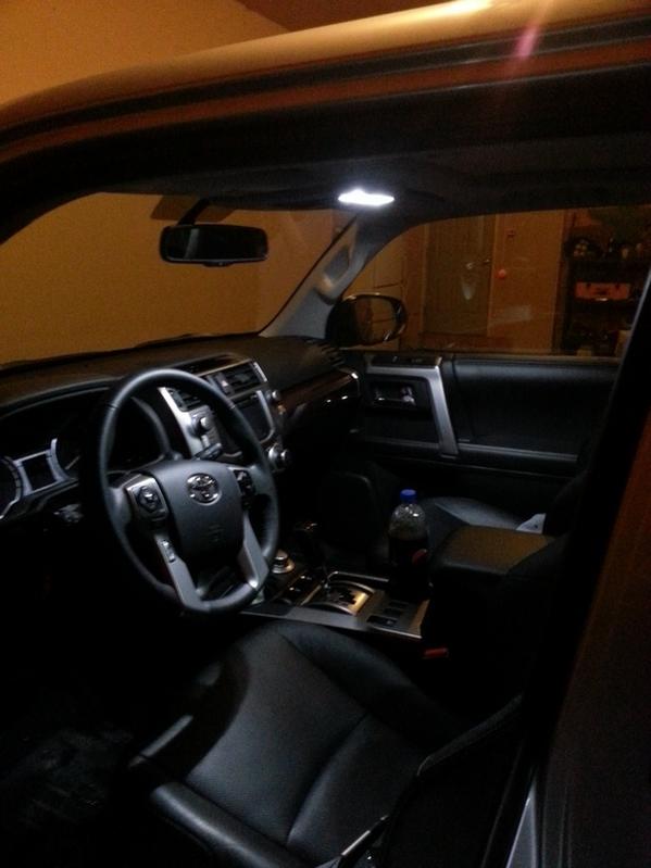

I will have to admit the vleds are just right in light output, not overly bright compared to the superbright pics I have seen.
also to add, it seems the vleds 3175 are about 1-2 mm longer which makes the install super tight. if you push it in and force it, you will hear a snap which in my case didn't cause any harm luckily. even though its in the socket now decently, it is cockeyed slightly pointing toward the rear passenger door and not horizontal like its suppose to be like the OEM bulb. looking from the rear driver side passenger door the light doesn't seem less than looking in from the rear passenger side.

got a pic of the vleds dome light install, haven't tackled the rear lift gate lights as I haven't had time or warm enough to install them yet. no flash used in this pic.

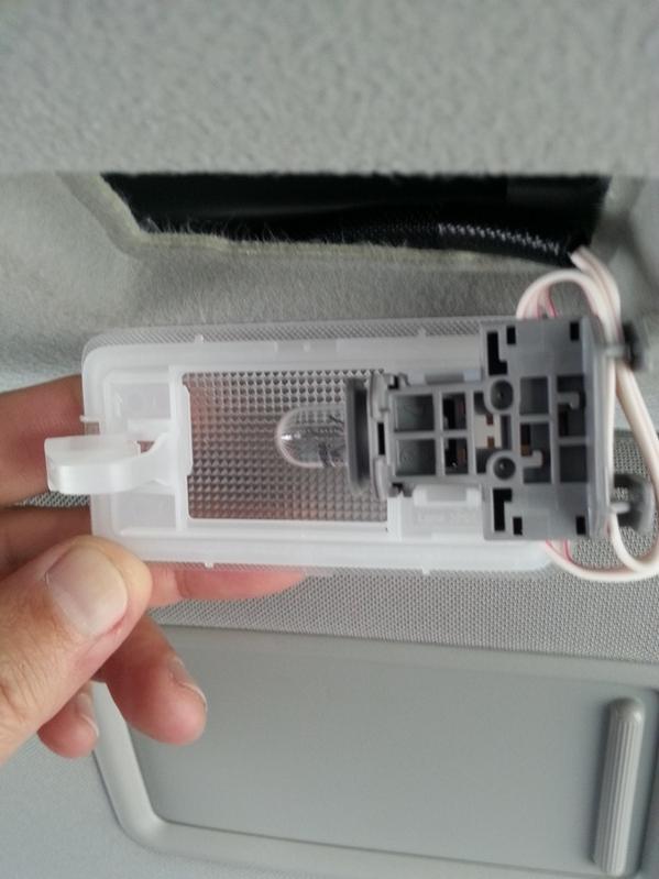

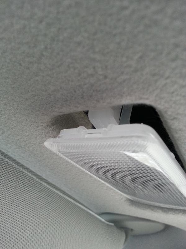

big write up to add to this thread. mind you this is on a 2014 LE. thanks to @philsey for removal of the door puddle lights, reference his post link a few posts back in this thread as a baseline.
1st pic :
vanity light partially removed, pry from the left side to initially to pop out, then push the retainer clip to pop it out the rest of the way. be careful as the guts are pretty thick on the right side, so you have to wiggle it out.
2nd pic :
this is the housing popped out. this slides directly outward, but be careful of the retaining clips, they are small. replace with 168/194 bulb (i used vleds 4 led p/n : 194_4_HPF_W_5K - 5K WHITE 4 LED 2 WATT HP FLANK BULBS 194 168 158 | 1 PAIR)
3rd pic :

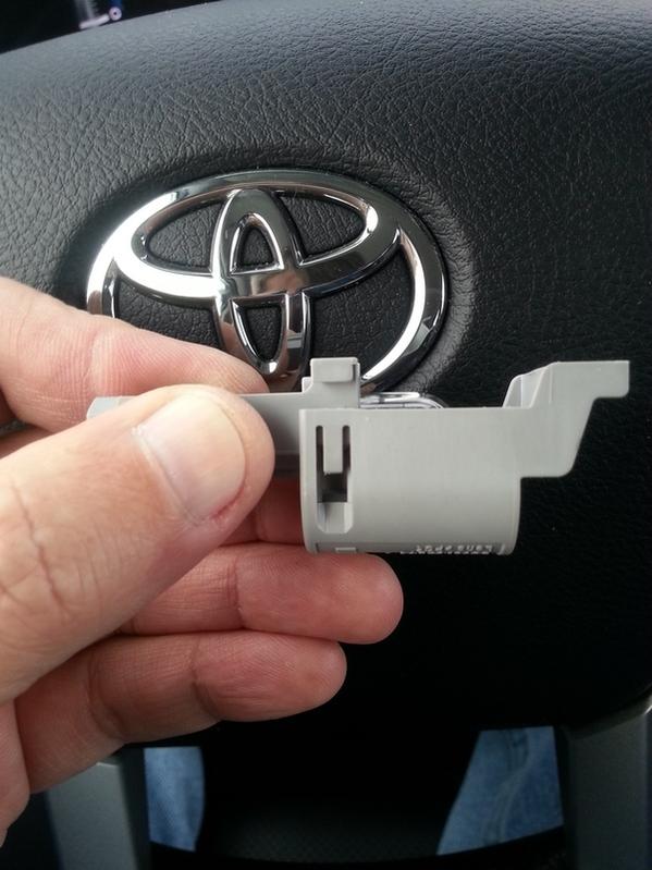

this is the housing on the 2nd row door puddle lights, they are a different housing than the 1st row door lights. this grey housing slides forward to remove it from the lens cover.
4th pic :
please note the small tab, push this to release the housing from the lens cover. its center of the picture and the only thing in focus.
5th pic :
housing removed from lens cover. inner housing is removed by pushing upward on the smaller protruding housing while being careful of the retainer clips on both side.
6th pic :
inner housing removed.
7th pic :
1st row door puddle lights removed.
8th pic :
  • 2014 LE Interior 4 - 2nd Row Puddle Light Housing Retaining Clip Cropped.jpg
  • 2014 LE Interior 8 - 1st Row Puddle Light Housing Retaining Clip Cropped.jpg

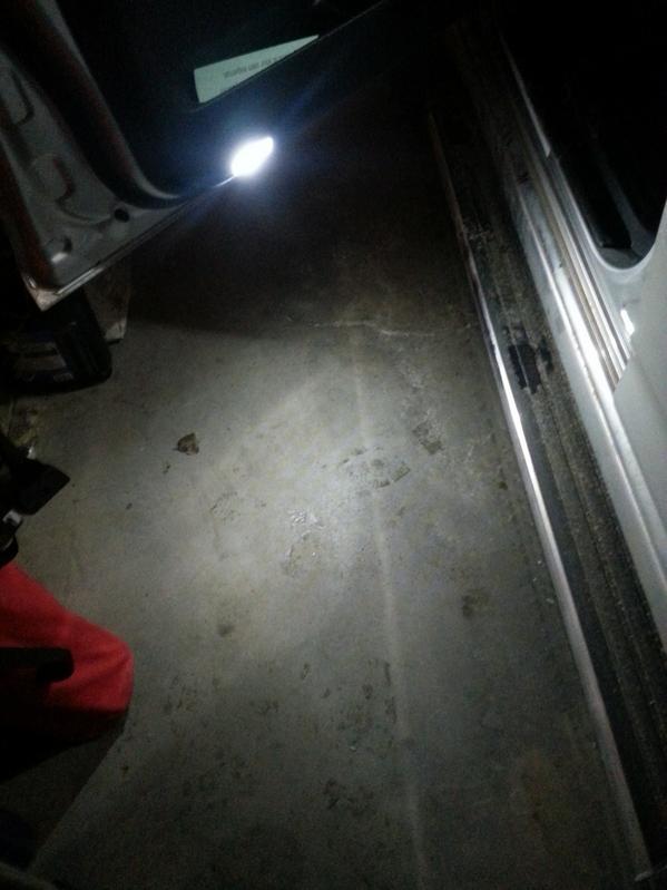

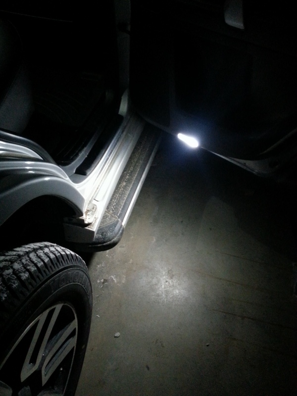

9th pic :
this shows the 1st row puddle light housing cover popped so you can remove it to get to the bulb itself.
10th pic :
driver side door puddle light installed. pic is in the garage so you can get an idea of the light brightness.
11th pic :
rear passenger door puddle light
12th pic :
map lights installed
13th pic :

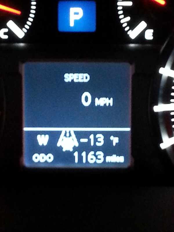

i did all this outside and this was the temperature. the installed pics where done inside the garage after i did all that outside :)

edit : forgot to add, the dome light removal of the actual lights is a serious PITA. i used needle nose pliers and gently removed them. the bulbs are pretty resilient to the plier if your super gentle. reference @philsey post of using electrical tape. i tried but man they dug in like a tick.

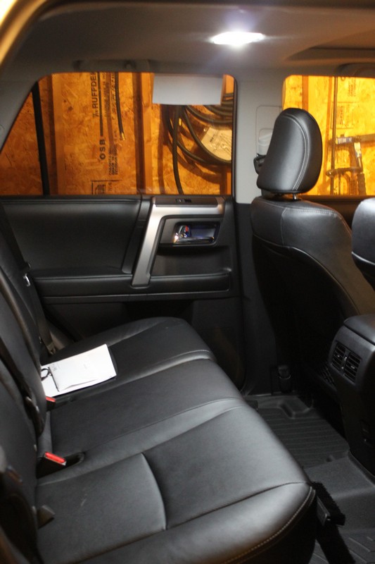

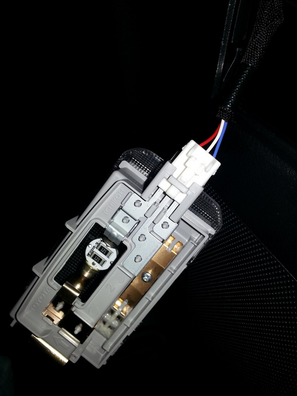

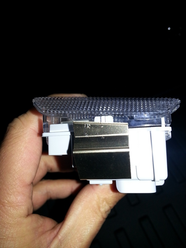

well since I reserved this spot for when it warmed up to actually finish out the part of the interior light mod, which is the rear lift gate/door lights.
as before please reference earlier post on getting the rear door light to pop out, trust me, its spot on and the driver side is a pita since you don't have the space due to body work.

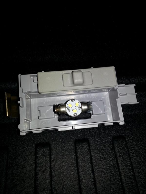

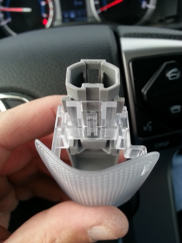

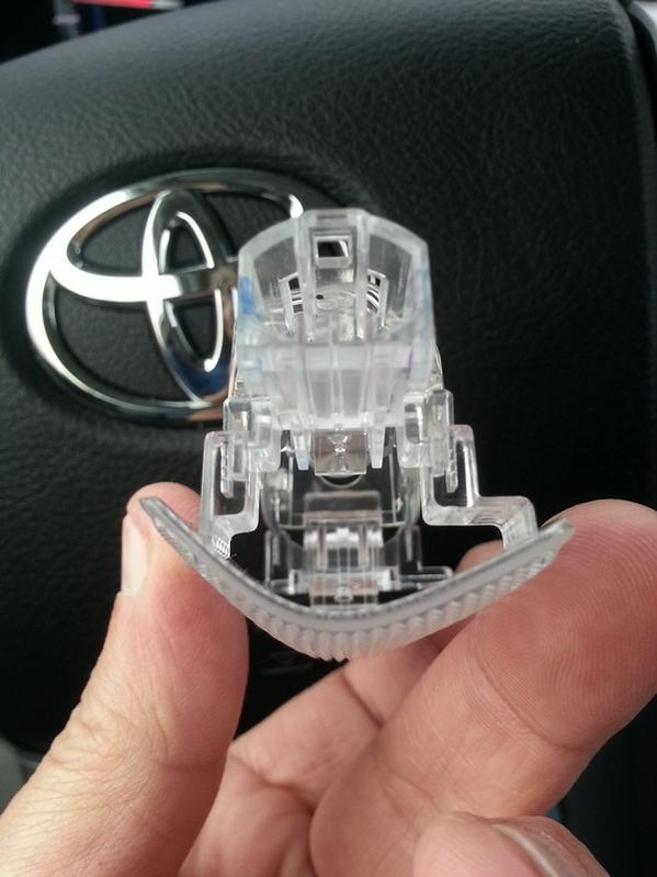

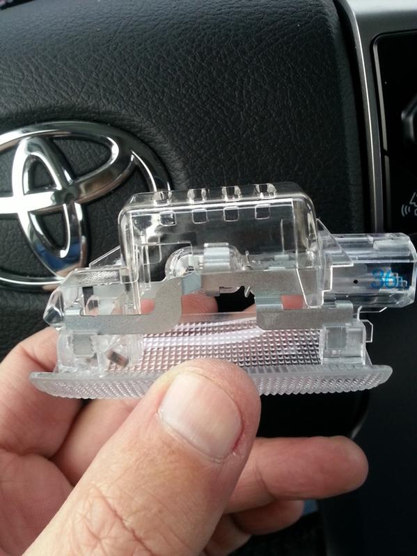

pic 1 : the housing removed, this is the big retainer clip you have to push in, in order to even get this to pop out. 2 thin flatheads make this super easy work with no plastic bodywork marring.
remember there will be a test if you don't follow directions later on :)
pic 2 : this is the housing still attached to the power cord, just push the retainer clip in and slide out
pic 3 : lens cover retaining clips, just pry with your fingernails nicely
pic 4 : since the DE3175 are not dual polarity, you have to make sure you install them, connect the housing to the power cord in pic 2 and slide the knob to the on position. if you don't get any output, swap the ends in the housing.
remember I said a test, if you don't do the above and put all that back in without testing, you will test your patience getting the housing out again.

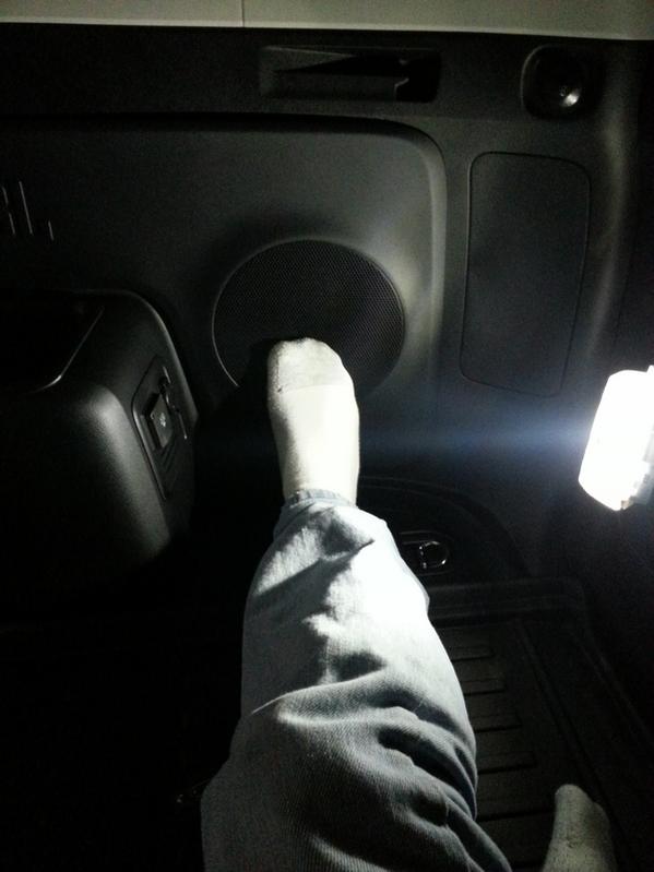

pic 5 : leds installed, feet basking in the output :)
btw these do faintly glow just like everyone else has said. but I think the amount of draw these have in this situation is going to be a mute point.
this concludes the simple interior mod for the 2014.
