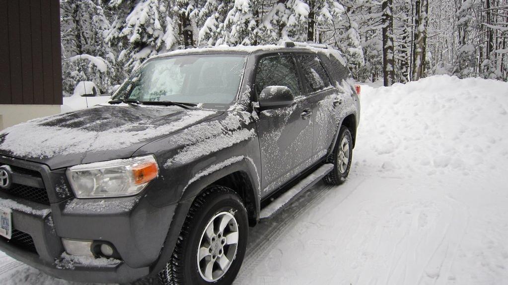

So far so good. It took me through few snowstorms, I was pleased with the performance on my ski trip to Vermont, even stock tires appeared to be decent, although I'm going to change them if I find a shop willing to buy my old tires. I turned on 4hi shortly after I crossed Vermont border and turn it off on my way back home a week after.
I was really impressed that during all my driving over snow covered higways, often at high speed, I got VSC beeping just once. I wouldn't mind to have full time 4x4 in winter, but it appears that I can live with part time pretty well.
