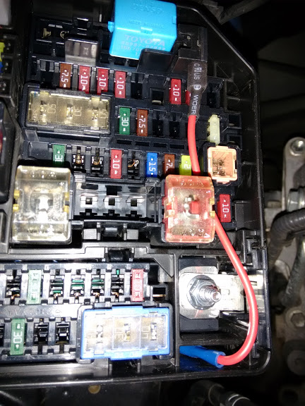

So I've been though lots of mod threads but haven't seen or have missed exact illustrations of alternatives for routing a fuse tap wire out of the fuse box under the hood.
Several nice secondary fuse boxes if one is going to go all out adding accessories but I'm probably just doing the one cct for the foreseeable future.
As I didn't want to hijack a build thread or perform thread necromancy I'm posting this new one just to see if there are any alternatives suggested.
My current plan, which you can pretty much see in the photo below, is to drill a small hole in the side, just below the lid lip, in the well formed by the bolt. I will then put in a rubber grommet small enough to get a reasonably water resistant fit around the 14GA wire I will thread through and run to a relay.
Any other ideas? Warnings? Suggestions?
Note the blue crimp on the red wire off the is not used. I will be clipping it shorter and splicing on the end of my wire run out to the relay. It is just lying there for fitting and planning.

I don't see any problems with your outlined plan but if it was me I would put a ring terminal on the end of the power wire and have an inline fuse harness ( I think you can buy these, essentially what comes on every accessory wire harness. This unit will be fused and it keeps you out of the factory wiring. Granted the style of fuse tap has been used for years without issue but if possible I would stay out of the factory wiring and it would prevent from having to drill or modify the fuse box.
I agree with what [MENTION=96008]Engineer[/MENTION] said. If possible, I always prefer to leave the stock fuse box alone.
How about just using the in-cabin fuse panel for your tap? What device are you planning to power using a tap?
^^^Exactly this. There is zero reason to tap into the fuse box under the hood. Every connection in there is hot all the time (not ignition sourced).
Run a ring terminal to the battery and use an inline fuse. Done.

Whenever I'm adding an electrical accessory to the truck I'll 'deliberately' avoid cutting into factory wiring in the fuseboxes because, #(1) There's no reason to cut into or disturb the tightly routed o.e.m. wiring bundle(s) path. And #(2) like [MENTION=96008]Engineer[/MENTION], [MENTION=65614]Antman[/MENTION] and [MENTION=130190]TrkyMfns[/MENTION] have offered... incorporating an Independent, properly sized 'in-line' fuse off of a main (POS) battery terminal aux (imho), is far better than 'Hitch-hiking' an existing, preloaded oem circuit fuse whenever possible.

I think there is some confusion here. I am *NOT* tapping into any factory wiring harness. For all the reasons given. However I am using one of the unused fuse positions in the factory fuse box under the hood. This is identical to what people do all the time under the dash in the cabin. However I am powering lights outside the interior cabin and it would be a long and pointless run though the firewall; hence using the fuse box under the hood.
The external terminal on the battery is arguably messier in terms of scattering fuses about and having more wiring and a "loose" fuse exposed under the hood. Yes I know you can get inline weather proof ones but why not put it with the rest of the fuses and keep the unfused wire segment essentially non-existent (best practice).
Essentially this mod could be completely undone with a piece of tape over a tiny hole in the fusebox.

This is hot all the time too. You had just suggested this was bad in the previous sentence but this is what quite a few mods need.
As I mentioned, unless you are making a major new distribution (as you have done), I think one more small fused circuit should be tucked with all the rest of the fuses in the factory weather resistant box. Protected, easy to find, no unnecessary, unfused wire segments.

Ok so I am really not getting the hate on for this. :confused:
Antman: I have the utmost respect for your work. Your varied and ambitious mods are an inspiration to us all. However I don't know if I missed your point. If I were adding lots of ccts under the hood, and/or some pretty high draw ones like a compressor, than tapping more directly onto the battery with a secondary fuse box distribution would certainly be the way to go (again like you did). However for a one off, what is wrong with tapping into the fuse box? There are probably a half dozen or more spare slots. This is exactly what you and others have down under the dash, eg.:
http://www.toyota-4runner.org/5th-gen-t4rs/92013-antmans-thread-4.html#post813452
Other than routing out of the box this is the same thing. A tiny, discreet hole and nice water resistant grommet are arguably no worse than going though the firewall, taping into factory wiring, etc. The usual mod stuff.
Sure I could keep it all by itself with an external fuse and directly off the battery, however by similar reasoning why didn't you come from the battery in the aforelinked mod? I suppose your point could be that there is inadequate diversity in the feed to the fuse box under the hood to support another <10A but I don't think so given all the other high draw, cycling, and intermittent loads. That's probably the only reason I can think of and, as I said before, if this was significant I would definitely go direct.

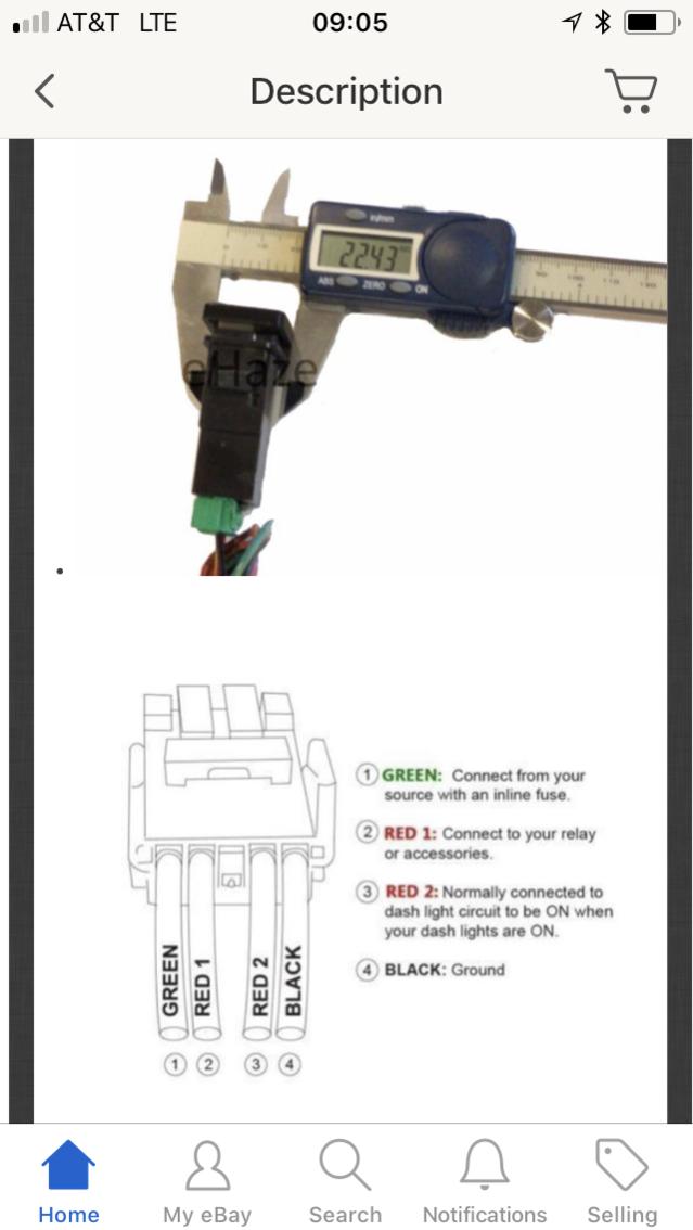

Sorry guys, only my second post. I appreciate all the threads and install directions. I have learned alot from this forum. However, I am having trouble with my auxillary fuse box install and can not find the answer on any thread. So, I bought the fuse box from ebay. Great box and made with quality. My fusebox came with a pos ignition cable I assume you connect to the battery? My problem is when I connected the pos ign cable, lightbar, and switches, the switch lights remained on without my key in the ignition. Any suggestions on how to fix this? What am I missing? I have mictuning push switches OEM style. I used a add a circuit to attach the green wire to the interior fuse box. I would like to connwct the 2nd red wire but I don’t know where to? Any help would be appreciated.
