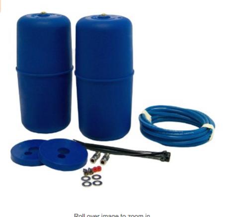

...airbags maybe?
I think that air bags may help.
Like some
air lift rear spring air bags
Or Firestone's version
called CRide Rite
coil rite.
You can get either brand for about $100 at amazon and other places.

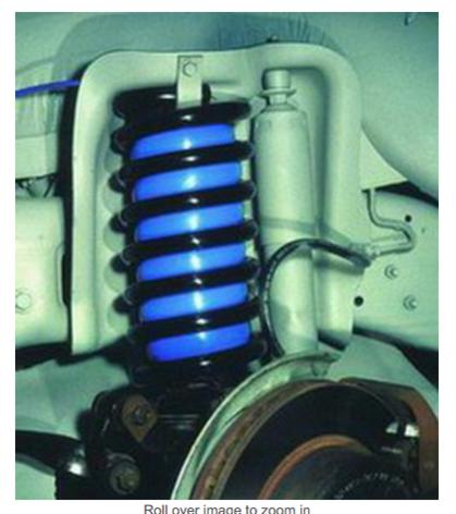

The fit inside your rear coil springs
and they have a hose where you can manually inflate or deflate each bag using a Schrader valve.
If you get the Firestone version, pay attention to when they say to cut the hose using a "sawing" motion. I used a sharp knife, and I also used wire cutters, and the hoses leaked right where they attached to the bags. I recut them,
and then I added a fair amount of nylog to both the connection point at the air bag and the hose itself, before I connected the two.
Also, be careful. These airbags don't hold much air, so it's easy to over-inflate them. I recommend a low-pressure air gauge so that you can get good readings. I've also considered buying a small, portable bicycle pump to use to inflate my air bags. My air compressor puts out some much air so quickly that it's hard to control it.
The air bags will provide extra support to your rear springs to keep them from sagging. Of course, for 30K miles, if you can get rear springs with out air bags that will handle the extra weight, you might find that you get a better ride. I think that the air bags can make the ride a bit harsh, although they will boost the rear height back to where it should be.
Great info, thank you. I get the feeling that the airbags are a bit of a band-aid. Or perhaps more of a "finishing touch" kind of thing. I may very well end up installing them, but I agree with your sentiment that if I can find the right springs for the job instead, I might be better off going that route.
