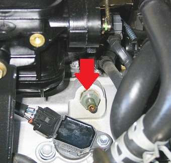

G ghs215 New member Apr 24, 2015 #1 For some reason, search comes up with nothing. Where is the PCV Valve on the 2006 V6?:frusty:
ben550 New member Apr 24, 2015 #3 Take off the black plastic engine cover and look on the drivers side above cylinder #5.
nasdamus New member Apr 24, 2015 #4 It's on the driver side bank, right above the #6 cylinder spark plug (furthest from the front of vehicle). See picture attached. Attachments pcv.jpg 47.1 KB · Views: 8,041
