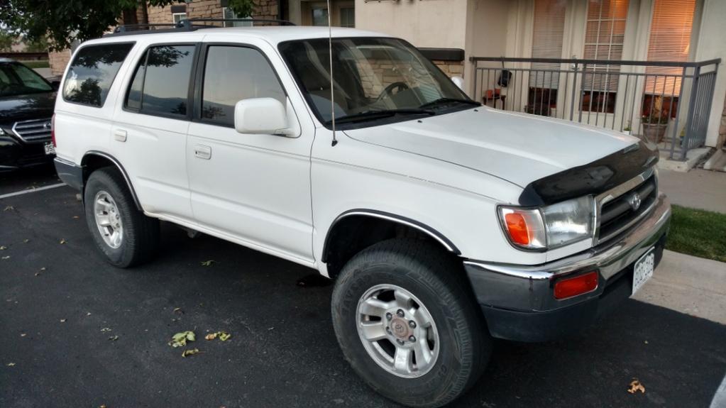

Picked up a clean 98 SR5 5 speed in Natural White/oak. 269k miles. No moonroof. No mods other than an aftermarket exhaust. It will be a camping/expedition/daily driver. I've got a bunch of projects planned for it and I'll add those to the thread as I start or complete them. Should be a pretty fun build for me.

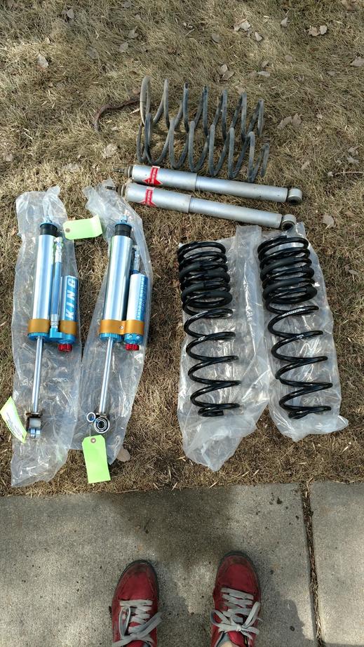

Trying to figure out which rear springs to go with. Talked to the guys at Toytec, but they weren't really sure what to recommend since the King rear shocks are made for a 2" lift. My rear drawer setup will probably be 100lbs unloaded and close to 300lbs loaded. Rear AOR bumper doesn't add much weight over stock if any since I lose the rear OEM hitch. I'm leaning towards the Superflex or OME 891 and using limiting straps. I'm open to any recommendations you guys might have. Not making a decision until my bumpers and shocks are done being built.

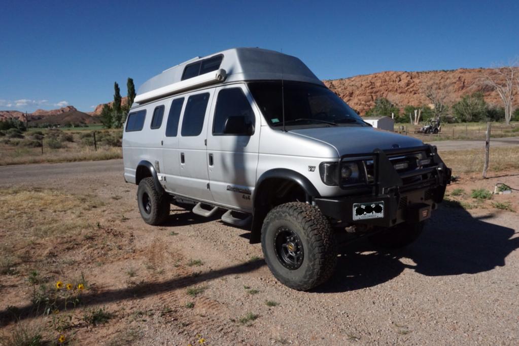

This rig will be replacing my Sportsmobile that I just sold. I'm new to 3rd gens, but not 4runners. I also had a 2007 4th gen Sport Edition.

You really need to go with longer rear shocks and lc rear or superflex coils. I agree the ford is beast mode. Looks like a good built start. Good luck.
Thanks Jayrolla. Ya, I kinda screwed myself by not ordering custom length shocks for the rear. It's too late since they are already being built by King though. Might just have to give the 906's a shot for now and see how they handle the weight. I prefer less of a lift anyway.

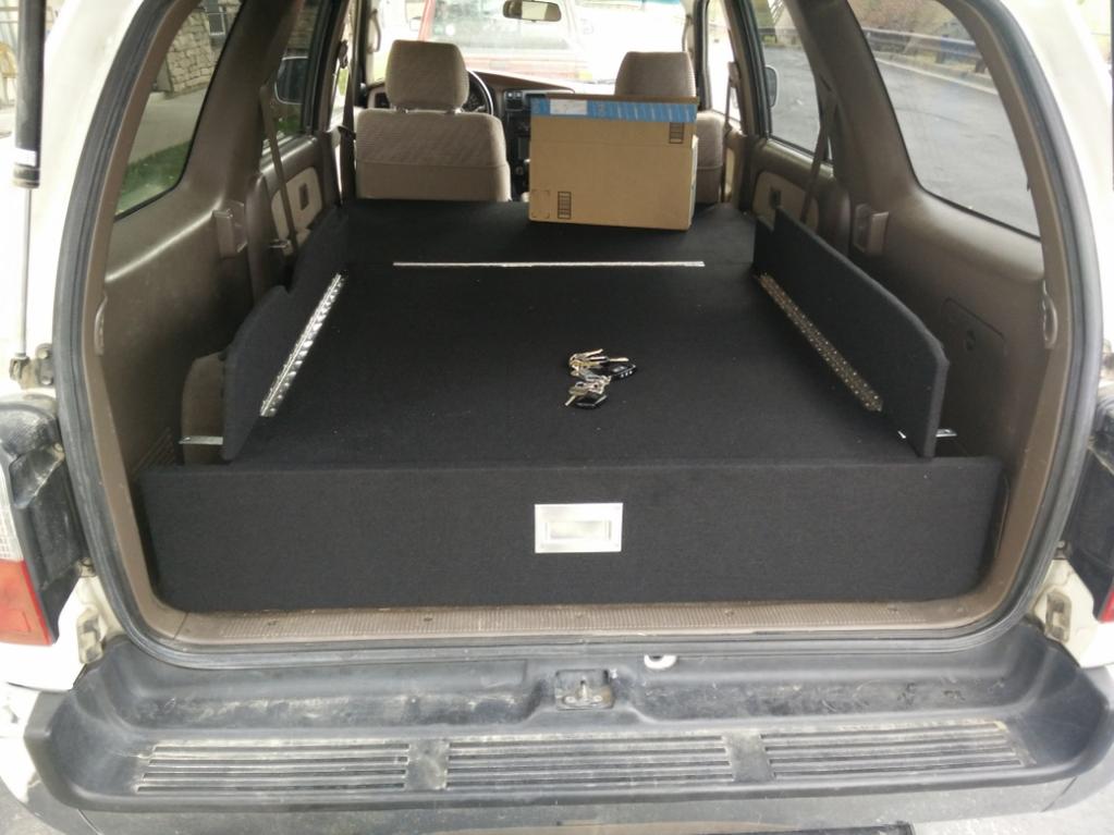

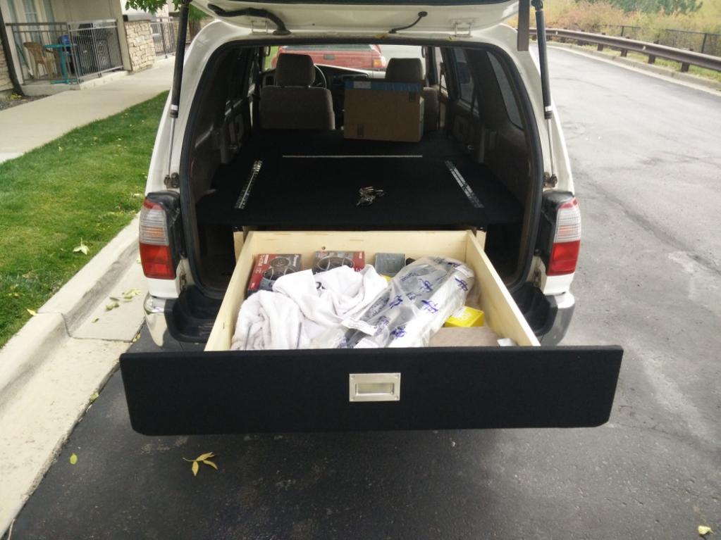

Made some progress on my drawer and sleeping platform. Took some inspiration from various other members on here. Still some details to finish up, but the main components are done and carpeted.

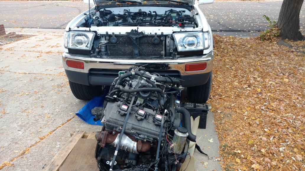

Engine failed the block test and is toast. Got quoted $7250 by the shop to install a JDM motor, new clutch and radiator.
The frame, body and interior on this 4Runner is so clean that I refuse to give up on it. So I'm just going to buy a JDM motor and do the install myself. Currently researching all the parts and gaskets I'll be needing. I've done a couple of EJ207 swaps on WRX's and worked on LS motor swaps in 3rd gen RX-7's so it shouldn't be too hard for me.
I was going to replace the clutch anyway so I'll go with the Marlin Crawler HD.

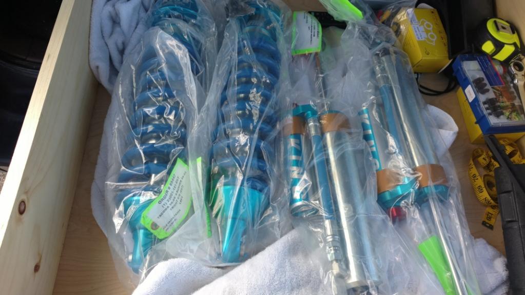

My Kings arrived today. Gonna roll the dice and order a replacement JDM motor from one of the eBay sellers with 100% feedback tomorrow. I'll keep this thread updated with my experience.

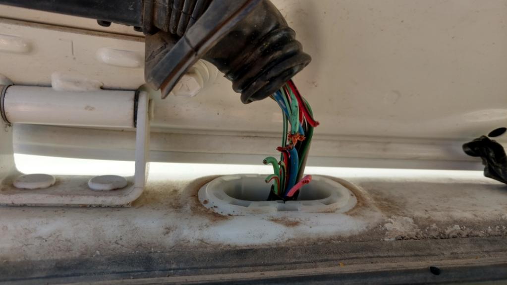

Figuring out why my rear window and wiper didn't work was even easier than I expected, lol.

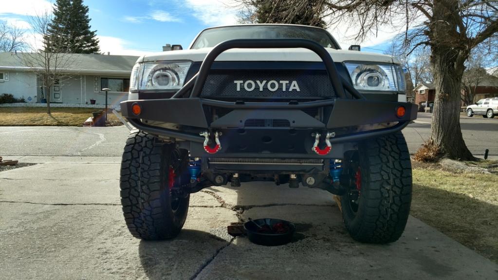

Made a lot of progress this week. Installed AOR bumper, King EXT coilovers, Total Chaos UCA, TBU with stainless lines, Whiteline LCA bushings, Diff drop, CVJ axles, low mileage steering rack with poly bushings, outer tie rod ends and Method NV with 33" Falkens. Doing the rear Kings and Superflex springs today.
