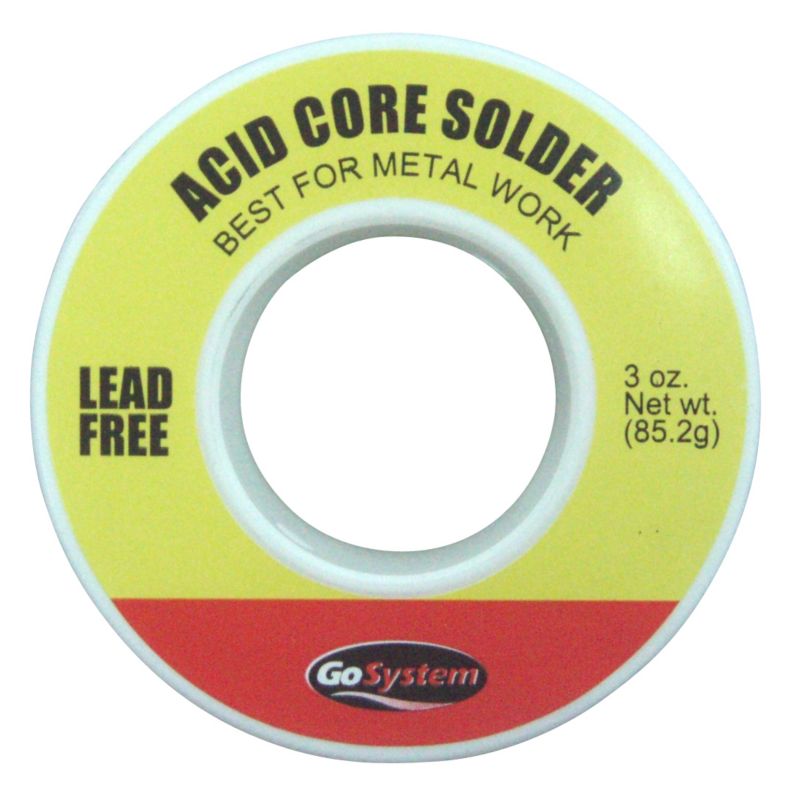

One point of correction though, for soldering the wires, you should apply electrical flux on the end of the wire and the inside of the crimp connector, crimp the wire into the lugs, then heat it up and solder it. But don't use too much flux, just enough to de-oxidize the copper surfaces. Also, don't use plumbers flux, only electrical flux. You could also use flux or rosin core solder wire from radio shack which wouldn't require any other flux to be used.

OK, guys, now you have me confused. I have acid core flux solder that I use for sweating copper tubing and metal repairs and I have rosin core flux that I use for electrical work. I see the NAPA label says acid in one place and rosin everywhere else. Isn't it one or the other, and always rosin for electric? I google acid/rosin solder and I can't find any. I think that NAPA label is effed up
I think you're right Durk, that NAPA label must be mis-printed. To be perfectly honest, the whole idea of acid flux vs. rosin flux was new to me before you brought it up. I've never worked on plumbing before so my only experience with solder has been with ROSIN core, which is why I identified as suitable, and bought, the roll that you see in the picture.
I did some research, and I would have to assume based on the following that it is indeed a rosin core solder, not an acid flux core.
1. It is specifically listed as "Electrical Repair Solder", with no mention of plumbing.
2. It contains 60% lead, and from my research, the use of lead solder has been disallowed in most areas for use in plumbing that carries drinking water. I think this would confirm it's intended use as Electrical Repair.
3. The "40/60 Rosin Core" labeling is consistent on both the outside packaging and the label on the roll itself.
4. The intended uses are Radio/TV/VCR/Stereo, Wires, Motors...all electrical uses.
5. According to what I read, acid fluxes are usually sold separately in paste/liquid form, rather than showing up as a core within the solder.
I did read that some Rosin compounds are slightly acidic. Perhaps they were trying to indicate that it was a Rosin core based on a slightly acidic Rosin compound?
Like I said, all this solder info is new to me. I'm just going to close my eyes and tell myself it was rosin core for now so I don't have to worry about doing it over again. :p

No sweat, you used the right stuff. It's definitely rosin core. They do make acid core solder; that's what I use to sweat copper tubing (along with the paste) and yes, it has NO lead. I would just edit out the 'acid' from your write-up so nobody uses the wrong stuff.
This is the WRONG stuff....
5036720730014_001c_v001_zp
Acid core is for very rough soldering, neither for plumbing or electrical. Rosin core is typical for both plumbing and electrical, but plumbing and electrical fluxes are very different. Rosin is just the carrier for the various acids and other de-oxidizers that the flux may use. The big difference between the different fluxes is the amount of acid in them, and how completely the acid burns of during reflow. Leave too much acid and it can continue to eat away at your base metals, and remain conductive.
