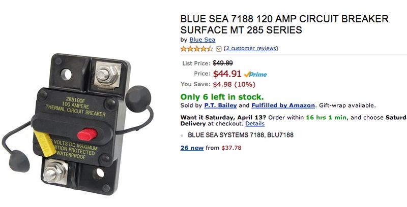

Since none of the local auto parts stores seem to sell a decent 100-120 AMP circuit breaker for around $30, I decided to order one on Amazon.
While I cringed at the $45 spent, I really want to protect against any possible engine fires and this definitely seems like a good way. It should arrive by this Saturday, just in time for my upgrade :party:
I also bought Les Mis for $23 (which I haven't seen yet) but that is way off topic.
Purchased (pic below)
BLUE SEA 7188 120 AMP CIRCUIT BREAKER SURFACE MT 285 SERIES

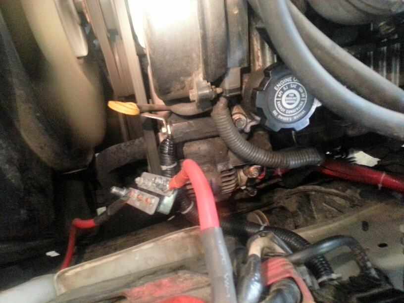

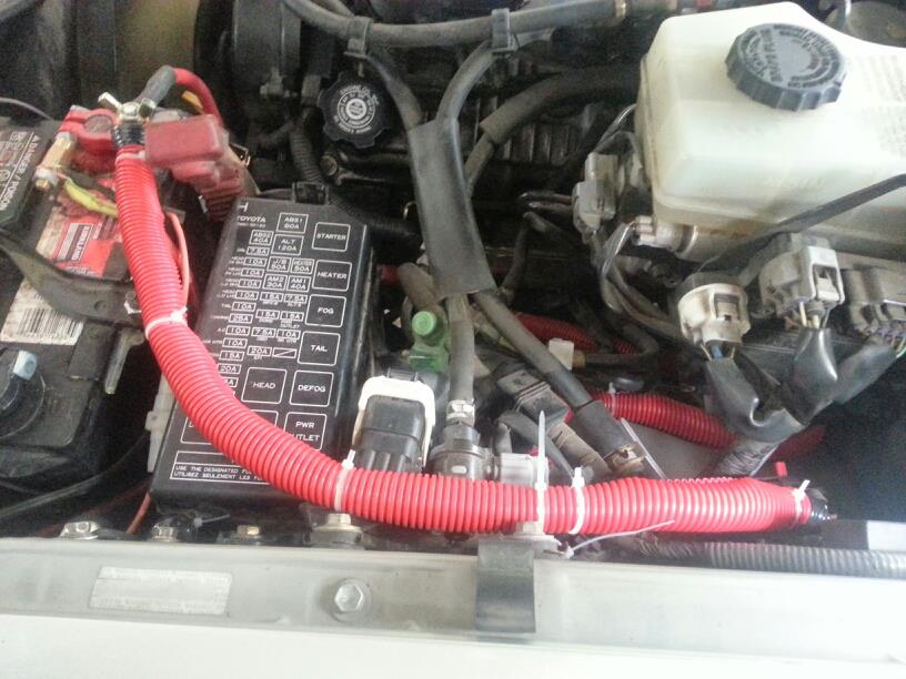

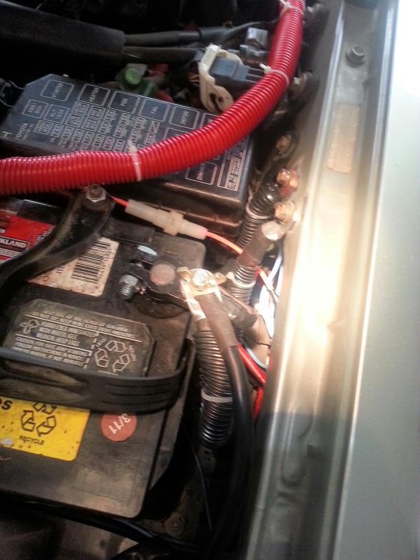

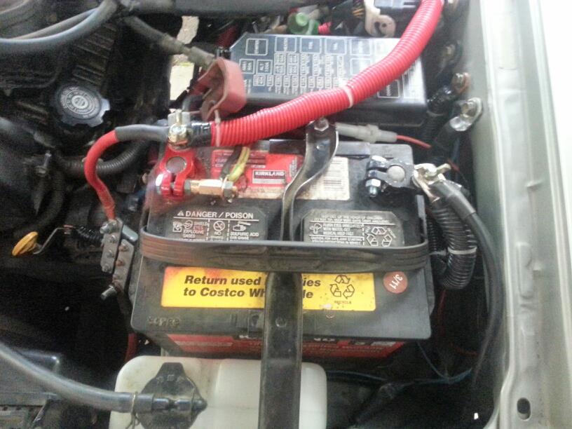

Did my Big 3 today. Went and bought a 150A breaker from Auto Zone for $30. My + to alt wire I wrapped in red fire protect stuff.. It runs back to the firewall where the breaker sits out of the way.. back in between some metal hoses and down to the Alt. The other two are wrapped in black. I secured my silver winch boxy thing by the battery too.. and added a positive terminal extension. Now with 3 wires just for my positive, the new ones are all 0/1 gauge (stick with 4 gauge - these are way too big and a huge PITA to move around) a winch line, stereo line and off road light wire, my battery looks like the central hub from hell. Anyways, I'm just winging it here.. Also put in a new PCV Valve, installed new headlights (one SS Ultra's died - never again) and Seafoamd the vacuum lines and gas tank. Anyways give me some feed back if you'd like. I could use all the help I can get. Thanks, Nate

Nate,
I'd recommend covering/insulating all of your positive connections, in particular everything on the positive battery post and the winch solenoid. If anything metal comes in contact with those and the chassis/engine (most metal on your truck is grounded) then you have a fire risk. For example, if your battery rattles loose and hits the hood, or if you drop a wrench, or if your solenoid comes loose. One option would be to make covers out of rubber sheeting zip tied in place. In general all positive contacts on the truck should be insulated.
- Matt
Yeah the positive side is out of control. there has got to be a way to clean it up.. I'll research it a bit later.. and I'll definitely get the winch box covered and insulated. Thanks for the response
Nate, has your 4Runner burned to ground yet? Just kidding but I hope you taped up that positive to positive connection. :peep:
I know right. :lalala: . I have been worried all week about it, but I did clean it up quite a bit after the pictures. What /where do I get that boxy thing all your wires are in? I went to Napa and asked and the guy kinda new what it was, but not really...marine store maybe? Anyways, bout to change out my plugs and wires and figured hell, why not replace the battery too.. So now I have a group 65 battery to install too and need to figure out how Im going to either flip terminals like BFAD or extend them out to the other side.. probably option #1 considering the angle of the hood and clearance.. SO anyways more updates soon.
Swapped out the battery and majorly cleaned up the wiring. Thanks for all the help. Finally started a build page too btw.. links in the doobleydoo...
