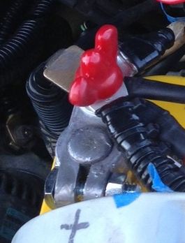

In prepping for the Big 3, I purchased the 'Marine' terminals, and hooked them up. There are 2 major problems:
A) The wires on the left (or positive side) do not move an inch from their spot. This makes it impossible when trying to pull them up to be able to push them down on the positive vertical screw. Is there just a zip tie or tape or something holding them from moving, anyone else experience this? [MENTION=65101]BrianSD_42[/MENTION], you have a 97 like me, any issues with this when you did your Big 3?
Here's a visual:
B) I noticed the cables don't even fit the positive screw even if the cables were able to move freely. I'm guessing I purchased the wrong one? This positive one from the link above is limited, I believe to 3/8 and 5/16 on the negative per the link description.

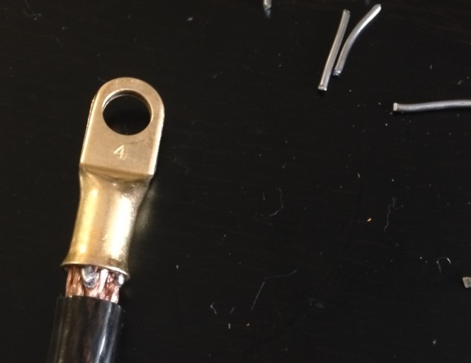

I tried to replicate putting cut up pieces of rosin solder in the metal battery lug in a C-clamp and putting a torch on it as BFAD did. The solder melts into hardness with the mini-torch instantly, so when you put the cable in, you are just pushing against hardened solder. You can't crimp anything at that point.
This is what I did .....
Take clean exposed 4G wire and 4G metal end piece, make sure it fits onto your battery terminal, meaning if it needs to be 5/8 (?) then make sure it fits. I don't know what your terminal bolt will be.
Take the wire, twist it, put it in the end piece, now shove in a few pieces of solder. I could only fit a few. THEN crimp so it stays in place. Then heat on the stove just long enough for the solder to melt. Now you have an end piece that is crimped and soldered.
Here is how I did it. Sorry I didn't post more details.

Here are the battery posts that I bought from Napa they are military grade. Negative post us on the battery and the positive is not yet, due to me not finishing the POSITIVE wires upgrade with 120amp.
NOTE: Stud for wires are facing sideways, compared to facing upwards.
