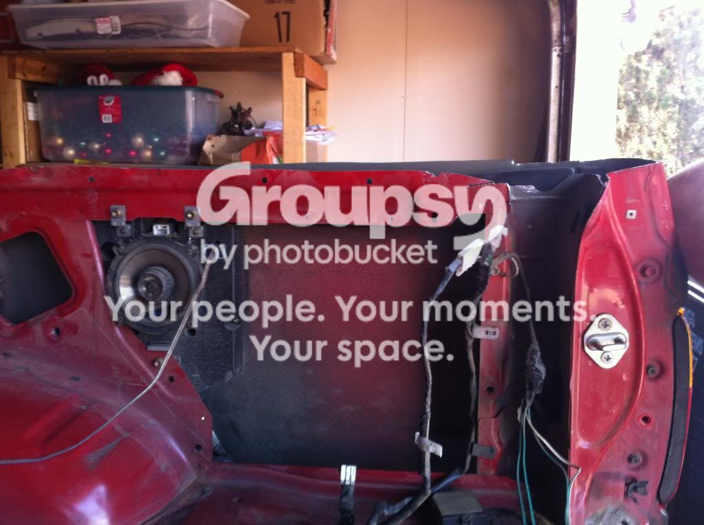

As we were cutting, I got the idea to install 12" speaker boxes here:

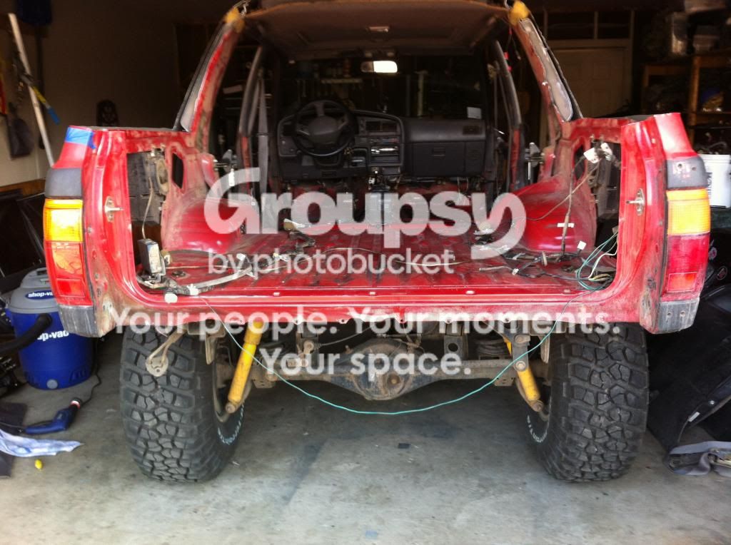

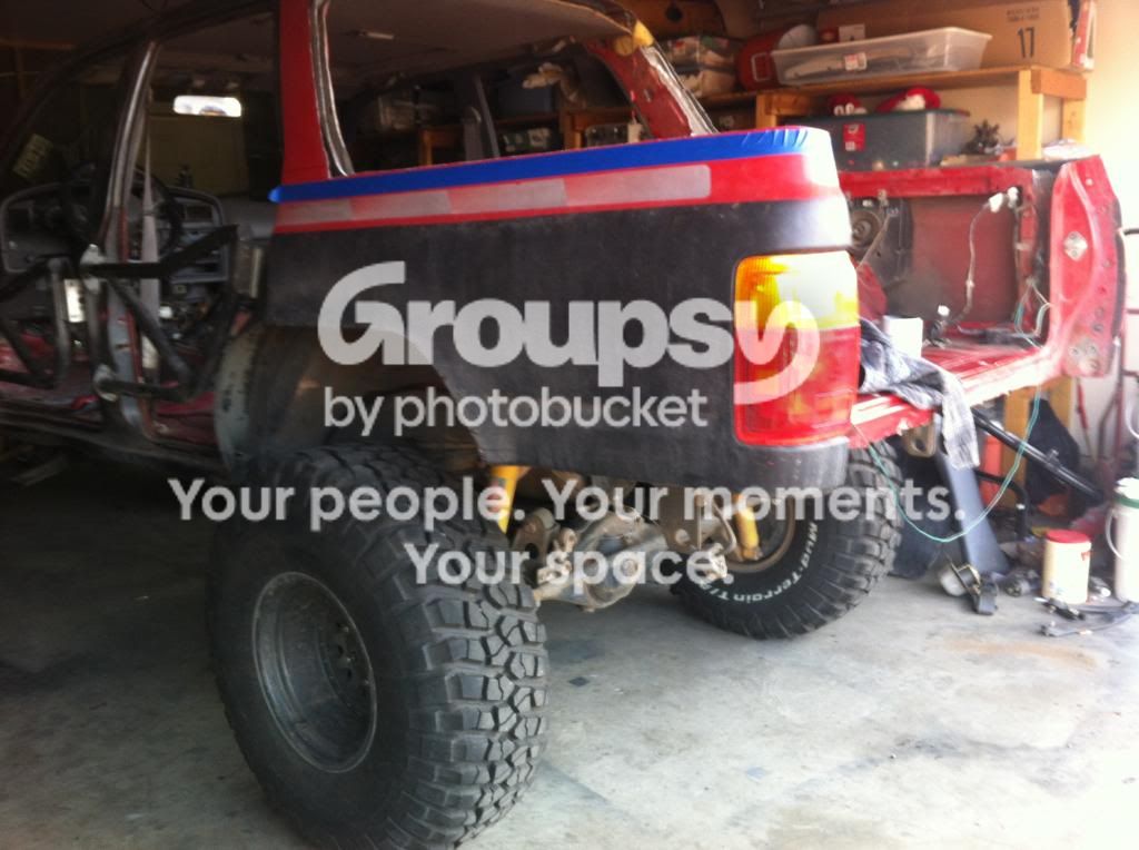

Also trimmed some more metal off the bottom of the body. The rear bumper plan is to come off the stock hitch mount with 2x3 steel, cross the bottom of the tailgate area, back towards the front right under the rear quarter and then tie it back in to the frame before it reaches the wheel well.

I'm curious about your speaker plans--you're not going to separate the bed area from the cab then? You know what would look really sweet on this--half doors that curve upward at the front of the front doors and the rear of the rear doors, to match the contours of the fenders, while still giving you a lower flat surface for your arm. Just a thought.
p.s. If you have any plans for a decent stereo system, this would be the optimum time to do the wire routing (hint, hint)

The only real wiring that would need to be done is for a sub and amplifier. As my final plans will be closer to a buggy than a 4 door SUV, half doors wouldn't be right, but I do like the idea.

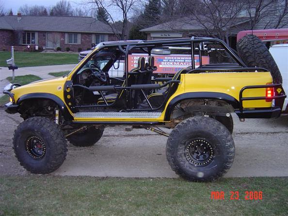

I'll want alot more off then just the back. No windows except for the front windshield. Tube doors. Full cage.
That is basically what I am eventually planning. Little bit at a time. This is kind of my inspiration.

A cage should almost be a priority, since that body lost a lot of strength with the rear portion removed--if it rolled now without those factory corners to stiffen it, the passenger section would be very vulnerable to collapse.
Looking in to steel. I won't put my passengers in danger, so a cage is in the works.
Oh, I already assumed that was on the list--you've been making smart decisions throughout this build. Creativity with intelligence makes for some pretty sweet project vehicles!
