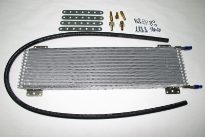

Had plenty of adventure/hassle installing a trans cooler over the past week or so. I decided to go a bit of an unusual route with the cooler, and created plenty of challenges along the way. In the end, I think the result is worth it, though I need a lot more testing to know the performance.
I went with a TruCool LPD4921, which is basically the width of the radiator:
To get it to fit between the hood latch support and the radiator, I had to space the AC condenser back ~1/2". For the top, I made new brackets out of some aluminum:
On the bottom, I reversed the side of the condenser bracket that the lower mounts bolt to (you have to reverse the bolt direction and slot the bracket to fit it all together):
I also had to cut off the unused tab on the condenser on the drivers side to be able to mount the cooler close enough to the condenser for everything to fit. Sadly, I first tried to bend the tab - which broke the condenser. So, ~$100 in parts later (new condenser, drier, R134a, etc.), I had to re-modify the new condenser and install it...
I was able to bolt in the trans cooler on all 4 corners fairly easily with the strapping included with the cooler:
I drilled new holes in the core support and fit rubber bushings that tightly fit the hose and holes in the panel to pass the hoses through to the engine bay:
Into the bay, below the battery:
The hoses are strapped to the lower fan shroud removable panel so that the shroud can still easily be removed for engine maintenance and those hoses will have minimal movement between the engine/body/frame movements.
I did not bypass the radiator trans cooler, as the radiator is very new. I did, however, install a thermostat for the whole system to avoid over cooling the trans fluid (and help it heat up faster in the mornings).
As of now, I haven't even driven the 4Runner since the install (just idled while refilling the AC system). I need to drive it, warm it fully and add trans fluid still (and put on the front skid plate). Working from home means not too much driving these days. I'll report how things work after a few drives. Stress testing will come later when I can get off road and/or summer really hits.
-Charlie
