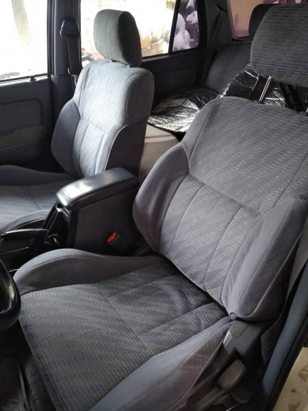

Hi Charlie,
I just changed my seats like a week ago too! Did exactly the same stuff. I got 2 sets from 2 96 Hilux Surfs and managed to build a good set from both.
Now both front seats have the lumbar support. I am only in need of the knob adjustment mechanism for the bottom on the driver's seat, as the sets where both from RHDs!
I will not find one around here, tho.
Here is a pic

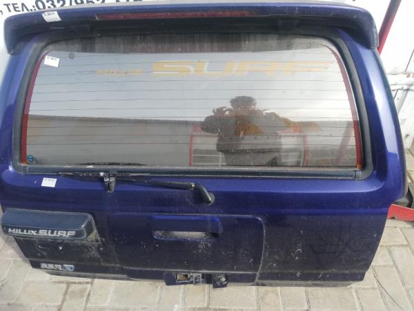

This is what I scored from one of the Hilux's too!
