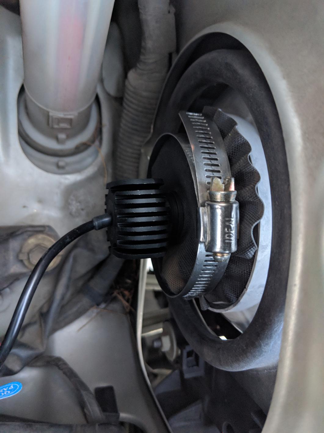

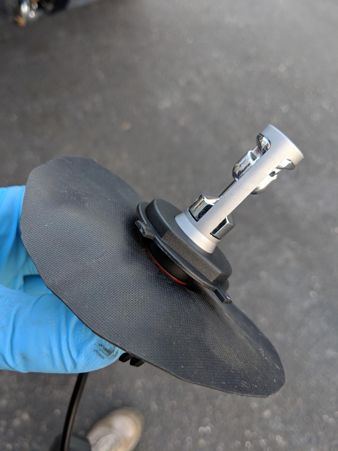

Recently installed "BEAMTECH H11 9005 9006 H4 H7 H13 LED Headlights Bulbs High Low Beams Fog Lights" purchased off eBay for about $33, super happy so far. Passive cooling so no fan noise, and they have little blinders just like OEM bulbs to control the direction of the light. The LED's are positioned to be in the same place as the original bulb filaments. Cutoff is no different than stock, and noticeably brighter than my tired old halogens. Haven't been flashed once by anyone coming the other direction.
Bought a thin sheet of silicone rubber and made dust boots, attached to the back of the reflectors with hose clamps.
Been waiting for LED's to be good enough, and it seems to have finally happened.
