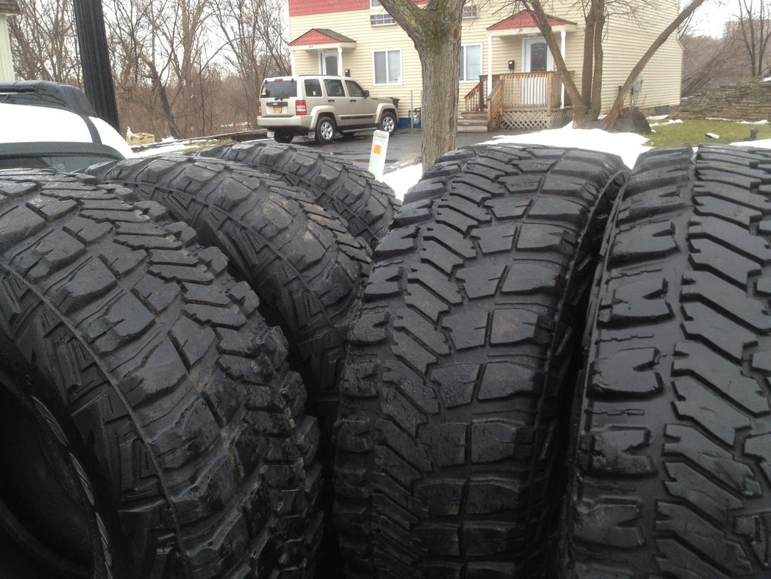

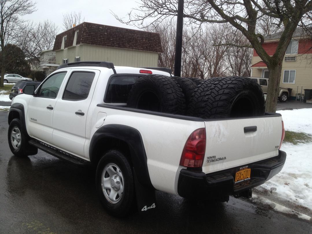

A road trip up to Syracuse and I ended up with a set of 5 Goodyear MTR Kevlars in the 35x12.50R17 flavor and about 60% tread for $400!

thats a sweet deal! :jaw drop:

Its starting to get exciting dude, definitely :snacker: worth stuff! And holy cow what a deal on those tires! Thats like what, 1500 new?

They're close to 1800 new, 21/32nds"
I paid 400, 14/32nds"
can't beat that with a stick
