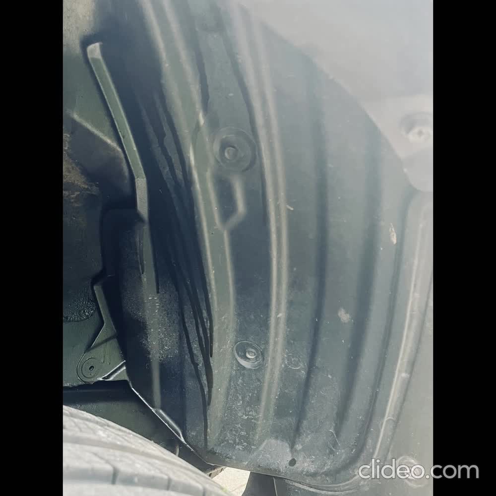

Pic attached. Help in identifying part number
Rpede
I’ve tried searching various toyota part websites with no luck. 2014 4Runner SR5P. The picture attached is the piece in the rear wheel well. Tire seen in pic to the front of this trim piece. This trim piece sits above the short plastic mud flap. I’m old school and perhaps they go by a different term now but I’m unable to locate it using specific and general terms. This piece on the passenger side rear wheel well apparently came off. It appears as if this piece is attached by plastic clips. Thanks for your help.

The piece in your picture is on the driver side, correct? If so it looks like it is p/n 77277-35040, fuel pipe shield.
#13 at this link.
Fuel System Components for 2014 Toyota 4Runner | Discount Toy
There is no similar piece on the passenger side, only on the driver side to shield the fuel pipe. The only thing on the passenger side is the mud flap so you aren't actually missing anything.
Wow thanks so much! Yes it’s drivers side on the abs located in the most rear part of the wheel well. I thought this piece was used to protect wheel well area from road debris, corrosion and more. Well that would explain a lot…here I thought the passenger piece fell of. You helped me a ton and appreciate this.
