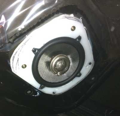

i run 6.5 in the rear doors and the sound great with my type x components in the front i run 100 watts to each door.
I made a mounting bracket out of a $2.25 cutting board. There was no need for a spacer.

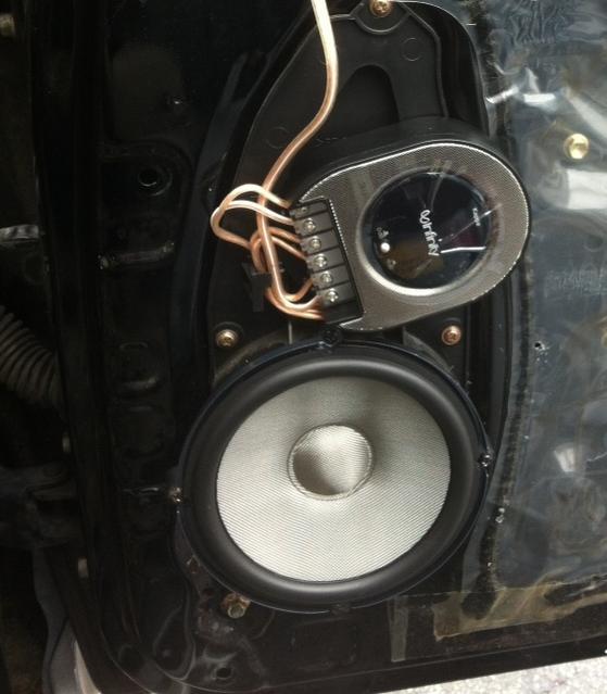

here's my install. I only show the front speakers in the pics sorry :)

Today I would like to talk about a few Stereo Mod's I've done. I put these speakers in over 2 years ago but last week I had my door panels off and thought I would take some pictures.
The panels are really easy to remove for anyone who hasn't done it before.

3. Infinity Kappa 6.5 Component Set
4. Alpine 75W RMS x 4 AMP
5. Ran new 14 (or 16g?) wires from the amp under the seat to all 4 doors (this is highly recommended by me)

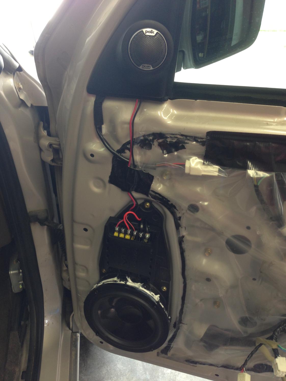

I got the Polks installed about 2 weeks ago. Here is a picture of the front door. I dont have a picture of the back doors yet.
front: Polk MM6501
back: Polk MM651
The rears took forever. I got the 6.5" speakers to fit, but I also had to attack the door with the dremel tool and cut out a good bit of metal to move the speaker down and toward the rear of the vehicle.
