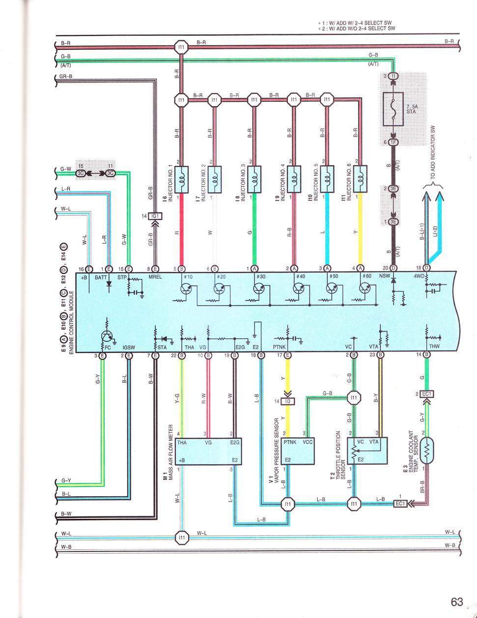

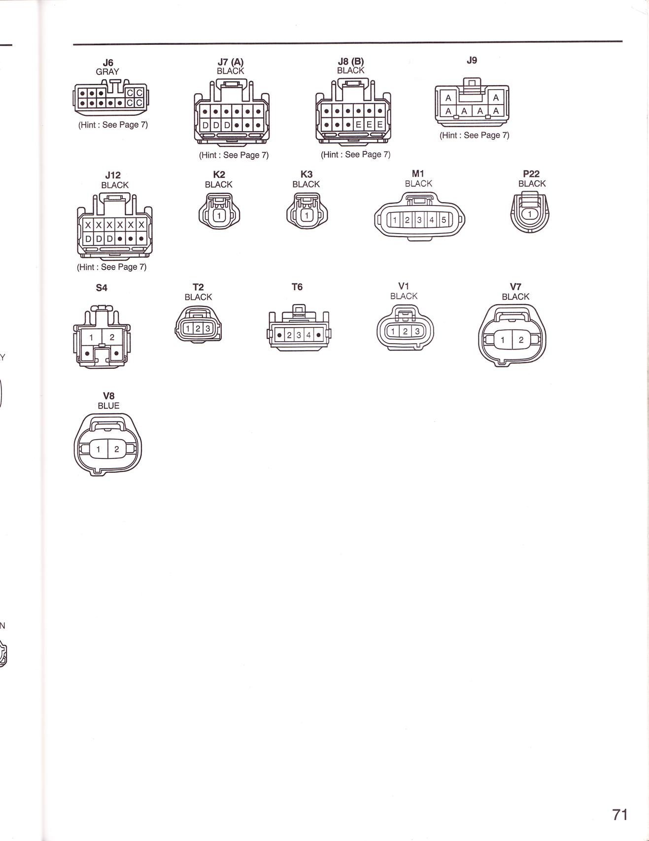

Could someone with a 1999-2002 4runner 3400 please take a picture of the wiring harness that plugs into the MAF sensor? A clear picture of the color of the wires would be great! I really appreciate it, thank you.
Aloha
The first attached page from my paper '99 EWD has your wire colors (see MAF at bottom left). The pin-out is plug M1 on the second page (match to the numbers on the first page.)
