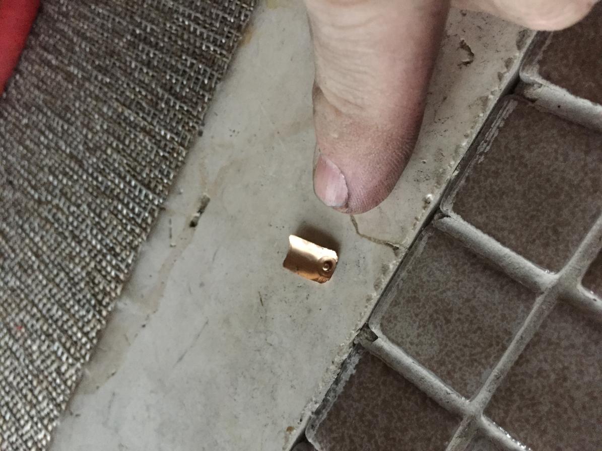

So I did the rear diff mod.. went smoothly until i got to running the tube up to the gas cap..
I took the cap off to make more room.. i couldn't squeeze the hose through the hole and my arm wasn't long enough.. so i attached one of those little magnetic screw picker upper thing that extends.. to the hose so i had a solid object to push through the hole... anyway worked it through the rubber grommet around the fuel neck where you fill up.. and the piece of shit broke.. and a little piece of brass fell into the tank! unbelievable..
whatever can and can not really conceivably happen will happen.. especially when a storm is coming in and you work in a parking lot.. lol..
ok so whats my play here.. its brass.. not metal.. its the size of about a pinky finger nail..
how big of a deal is it?????
does it sink to the bottom of the tank.. does the filter block it anyways..
or is it a huge deal that i need to drop the tank and fish it out, can you just yank the filler neck at some point before the tank?
thanks..
Little smaller than this piece.

Shouldn't cause much in the way of problems I would imagine. It'll probably get stuck near a baffle or just float around. The sock filter is big enough that it wouldn't block it off.
thats was my thoughts.. good news is it doesn't float, I checked..
so i figured it would sink to the bottom.. and the filter on the fuel pump would stop it from getting into any lines and blocking them..
my only thought was to remove the fuel neck, and maybe find it in the tube.. idk how feasible that is..
realizing I'm an idiot all together, i should of just feed the line down from there first..
If it makes you feel any better, my sister had a ex-boyfriend take off with her key to her gas cap. We broke the top off and the rest fell into the tank. She drove it for another 3 years with no problems.
This sounds like good advice.
Although, if you start getting any stuttering or hesitation, don't plan on driving much further.
It might just dissolve
b/c of the corrosive nature of the fuel and brass being a soft metal. Otherwise the screen on the fuel pickup should block it..:violin:
let us know of any horsepower increase or better fuel economy. I would not fret, there is probably worse in there.
thanks for the replies.. You basically confirmed my thoughts..
unfortunately no HP increases and my MPG is still poop
