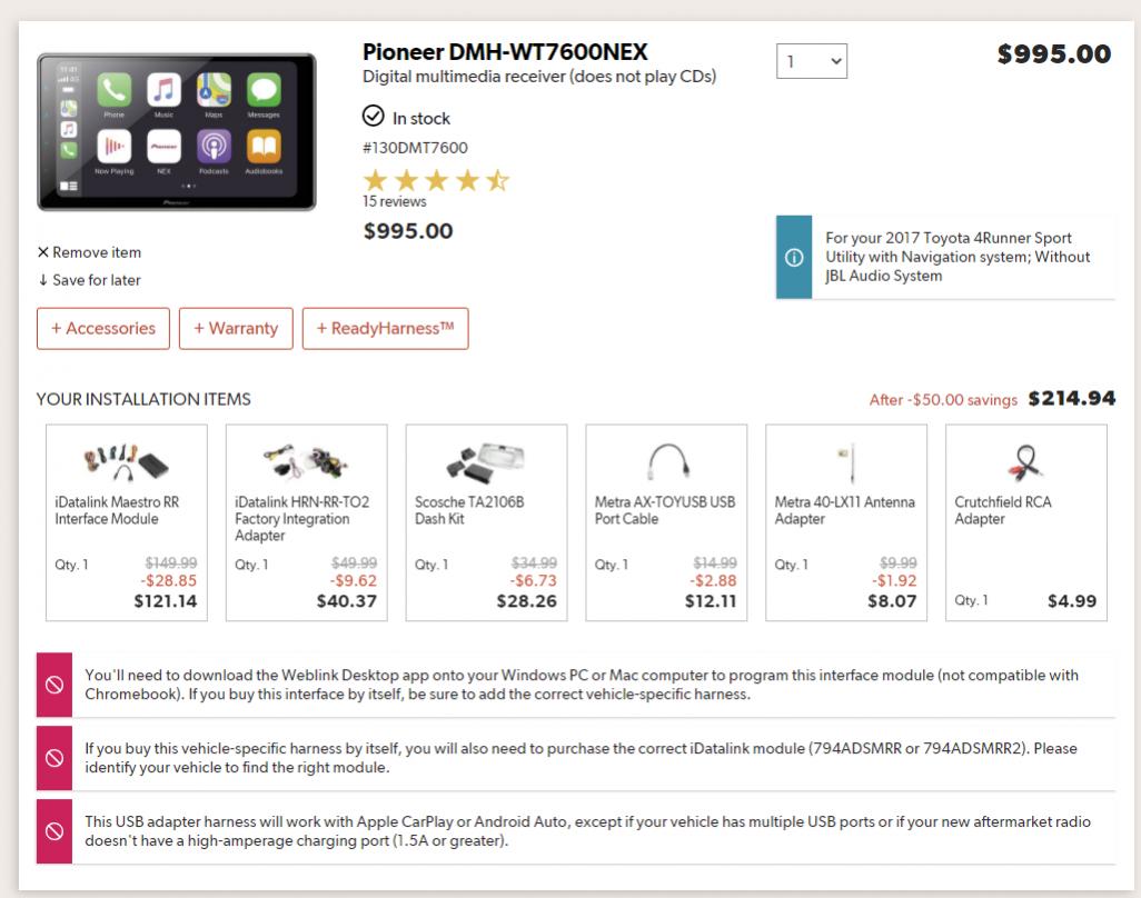

anymore feedback on this unit? im looking to purchase one. anyone else got this?
this is the kit from crutchfield..might swap the gray kit with the black one

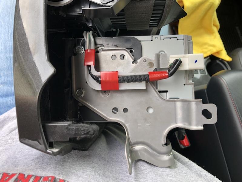

You can reuse your OEM metal brackets/hardware with the Metra kit. First, you'll have to drill out the alignment nibs so they sit flush with the plastic Metra brackets (you still use these to mount the dash kit to the head unit), but that should leave you with enough holes lined up with the threaded DIN mounting points on the Pioneer to screw/bolt the whole assembly together.
Trying to picture how to do tbis...couldnt i just take the plastic metra bracket off and reuse the metal bracket with less screws? Im sure it would be secure. Just finished my install..needs to be tweaked a bit. I think i can go one notch lower on the display. Think OP is a tad lower on his screen than mine.
Also need to get new yellow clips..mine wore out during install... Lots of trial and error

Can you take a few pics of the OEM bracket modifications when you do them? Not really clear on this...do yo find your current install is stable?
Yea i can take photos. Its stable but if i were to forcfully pull it out i can get it off from the metra kit. only thing holding it is plastic clips
Sent from my ONEPLUS A6013 using Tapatalk
Here's a pic of the OEM brackets used in conjunction with the plastic Metra ones. You may need to drill out or grind down some alignment nibs so they sit flush. I decided to use both together because I wanted to keep the ability to reinstall/remove as a single assembly like OEM. I have a standard double DIN and don't have any direct experience with the newer floating style head units, but it looks to me like the best course of action may be to install the chassis first reusing the OEM brackets and skipping the metra ones all together, install the trim piece over the chassis, then mount the floating display last.

Awesomene ill be doing this as well
