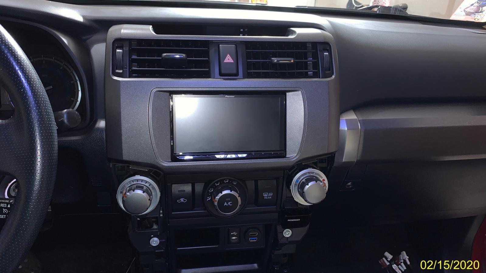

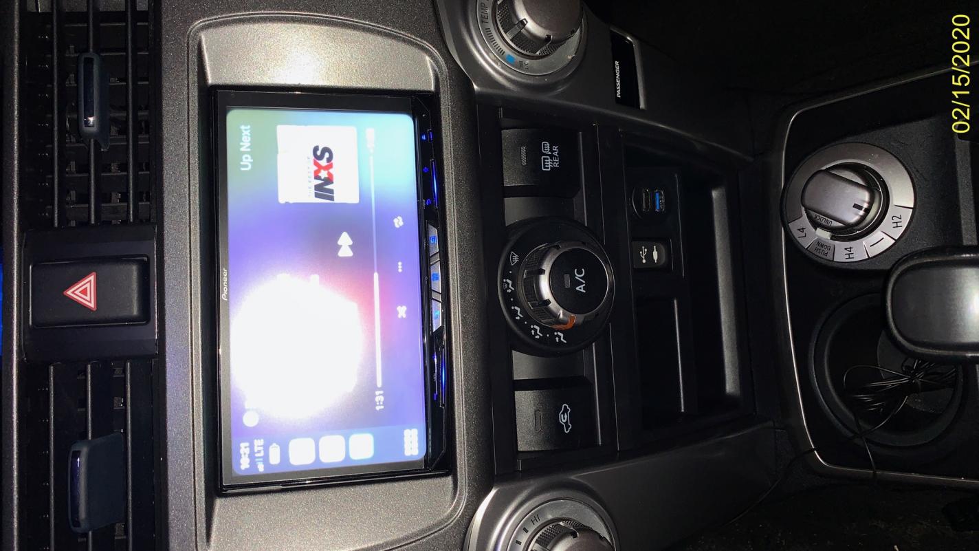

Here's the metallic silver that I used, may be a touch sparkly but it's not bad....

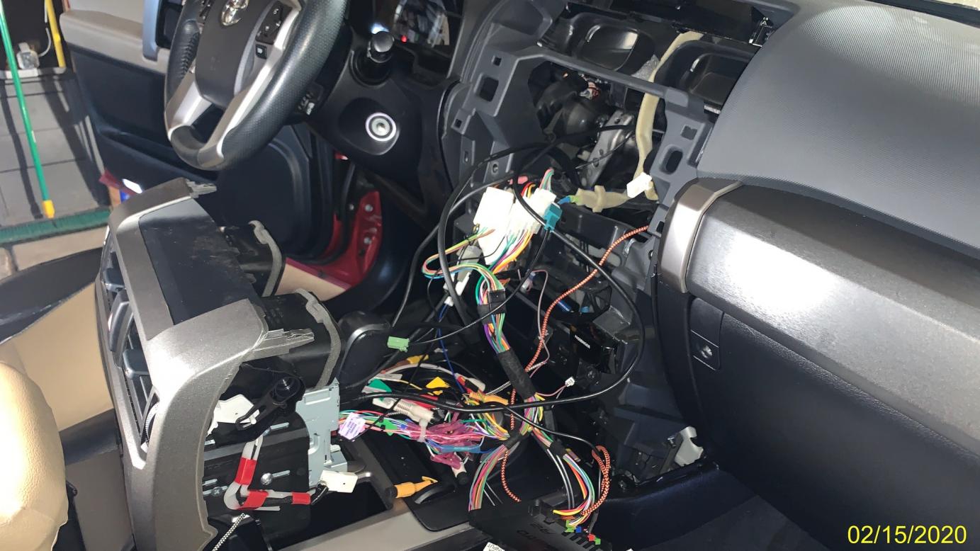

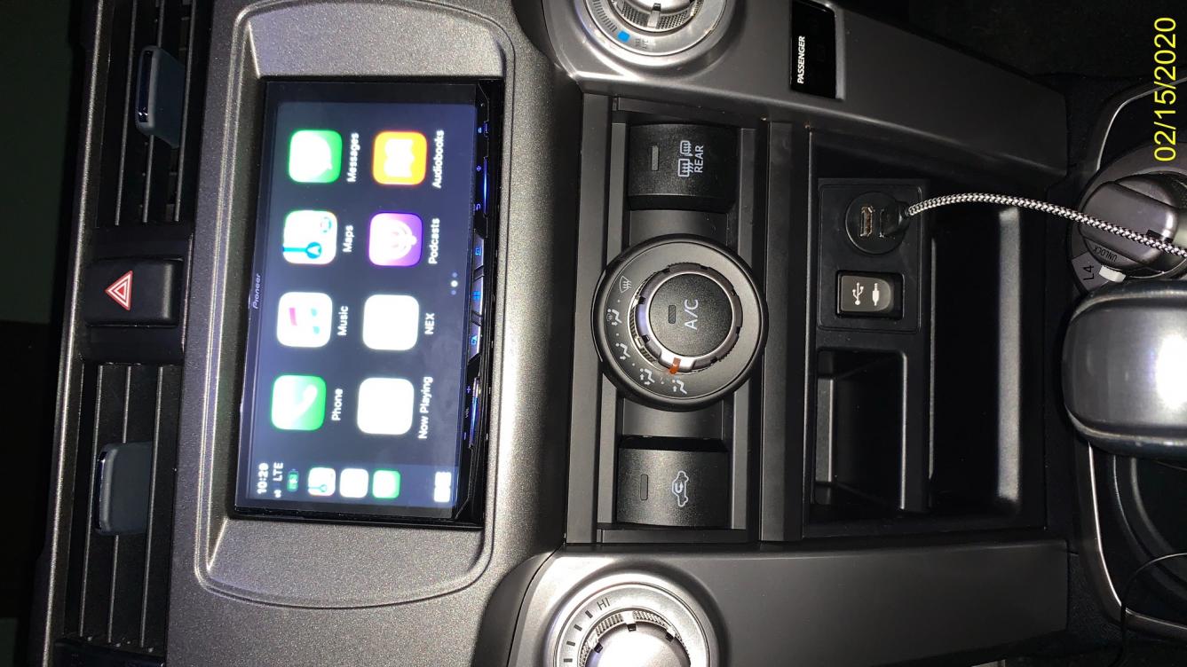

great info in this thread. was able to do my first ever install with the help here, other threads and youtube. Had to look at the 1000 wires in the harness, wiring diagram about 50 times, but got it. I got the newer maestro rr2, although not sure what future benefits it would provide me - couldn't find much info on how to use/program the three new options, and I didn't use bluetooth to flash. If anyone has further info on the RR2 other than the one youtube video, feel free to share.
I also took out the 12v lighter and replaced it with a USB / HDMI input on the center stack. Might reroute the 12 v socket to the glove box later. I added the siriusxm, although not activated now. Had to change a few things and re-flashed it. I also ran a usb like zcruiser to the glove box to flash. Learned the hard way and figured out you have to take out the radio fuse in order to flash it once installed since there can't be power to the rr in order for the laptop to recognize it. Zcruiser - thanks for the recommendation on the paint. Looks more sparkly in the photos than it really is - i like the color. again, awesome info and thread - when I first saw all the wires when initially researched the install and didn't know too much about maestro and idatalink either - i thought no way....... Had a heck of a time to get the rr2, sirius tuner, and the bundle of wires shoved back in there.
