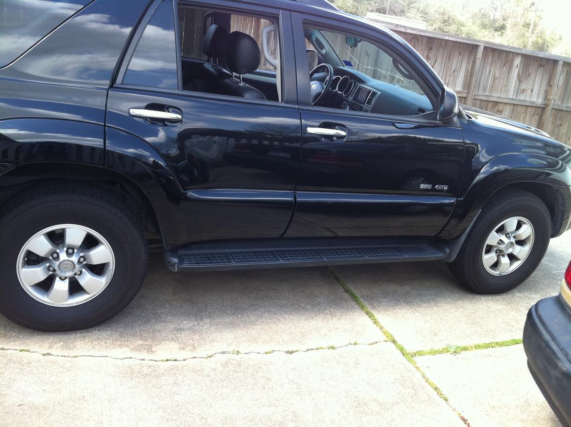

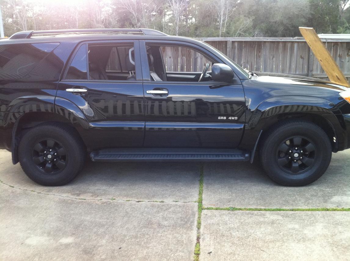

Just finished applying the Plasti-Dip to my 06 SR5.
^^^Very Nice! That looks awesome TacMedic. It's amazing how something so cheap and simple can completely change the look. How many coats did you use?
Off topic: Is that a tree branch on the other side or is your windshield cracked!?
Thanks! I did about 4 coats each, using a total of 3 cans.
