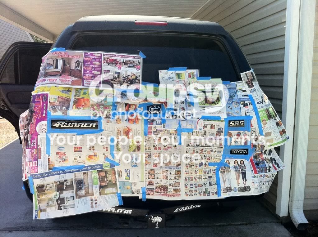

Thanks. With Plasti Dip you don't have to take them off. Once the stuff dries it just peels off.
Sweet! I've never used any of that stuff yet- i just painted the spoiler. So obviously tape everything off, if it somehow gets on the paint will it come off easily without causing any damage?
Lets just say that I did a halfass tape job yesterday to redo my emblems (saw some spots I missed) and I had a good amount of over spray and it came off. It wasnt as easy as when you have a clean edge to peel from but I did get it off without damaging the paint.
Just don't hold me responsible if yours does mess up.
(I doubt it will)
I have tried to plasti dip my emblems and am not having much luck. It won't stick and I keep getting little divots on the letters. I didn't have any trouble blacking out my chrome grill. Help!!
With plastidipping, Did you need to spray a clear coat? I plan on doing my stock wheels as well and wanted to know if I should shoot it with clear coat. On the emblems, did you guys shoot it with clear coat?
I didn't use clear on my emblems as the whole point of using plasti-dip for me was the fact that I didn't have take the emblems off. I recently did my air deflector and roof rack and I did use clear on those, got the idea from childrenofbodom. He says that it will stain easily and gets scuffed up too easy without it. I am very pleased with way the plasti-dip clear combo came out, seems very strong from what I can tell so far.
:withstupid:
Just kidding Plametto. I meant to say :iagree:
kinda of a stupid question but do you need to tape around each letter on the emblem or do you just spray then use a razor to peel off the over spray
I just roughly taped around them and peeled off the excess when it dried, didn't even use a razer but it probably would have been easier.
