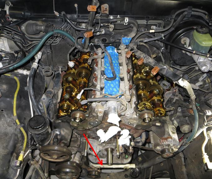

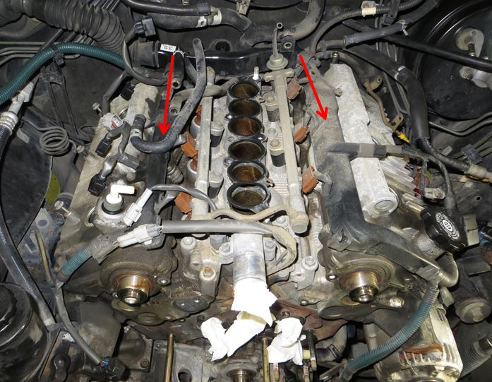

Hi Guys,
I'm doing the TB, WP, and Cyl Head Gaskets and the plastic wiring harness "protectors" are all very brittle and partially broken. I cant seem to find a part number for these - are replacements available at all? I would like to replace both of the uppers, as well as the lower starter wire protector.
The only alternative I can think of is to wrap whats left of them in self-fusing silicone tape.
After looking at the parts breakdown, it looks like those covers are only available with the entire wiring harness they are protecting. Sucks, I know because those things are impossible to not crack. I tried taking them apart to remove them. How they clip together on the bottom is impossible to take apart without breaking their little clips or holders. I was thinking about just breaking the little holders and removing them instead breaking them, then just taping them up like they already are in some places.
For the starter wire, the harness thingy was literally dissolved from oil and grease in my truck. I removed it and zip tied the wire to the mounting holes for the nonexistent plastic. It has held up fine for the past six months.
