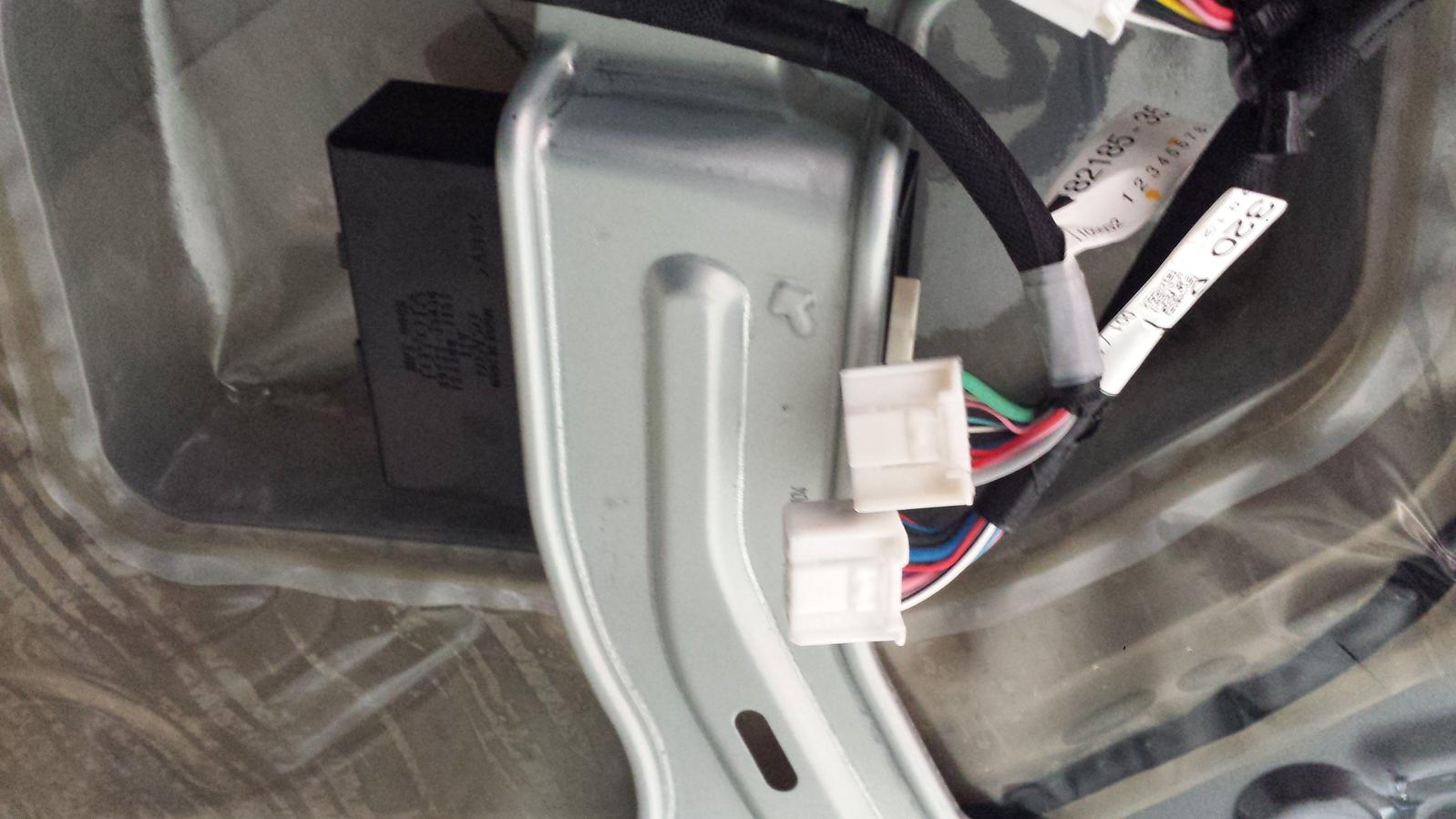

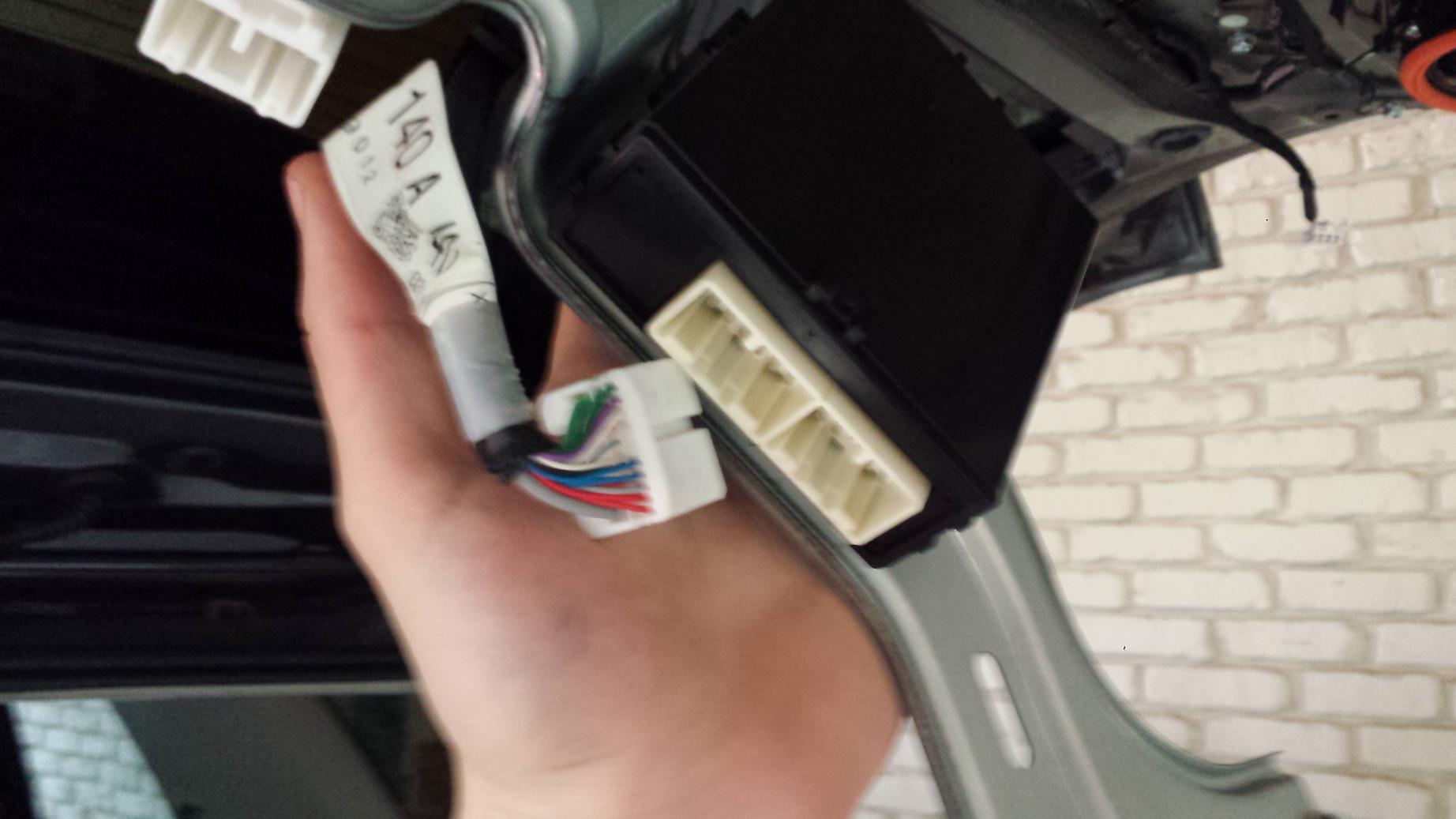

There's a "Multiplex network ECU" in the lower rear tailgate that manages the exterior lights, tailgate functions...etc. Make sure you remove the rear cover and dry the multiplex module and ALL electrical harnesses that you can to prevent any permanent damage. Best!

There are a couple of screws holding the cover on (just look around) and then it snaps off; no big deal... it's been a while since I saw them.
Like rydr1 says: Be careful not to overheat the "Multiplex Compu" in the lower rear tailgate... it won't like too much heat and they are very expensive!

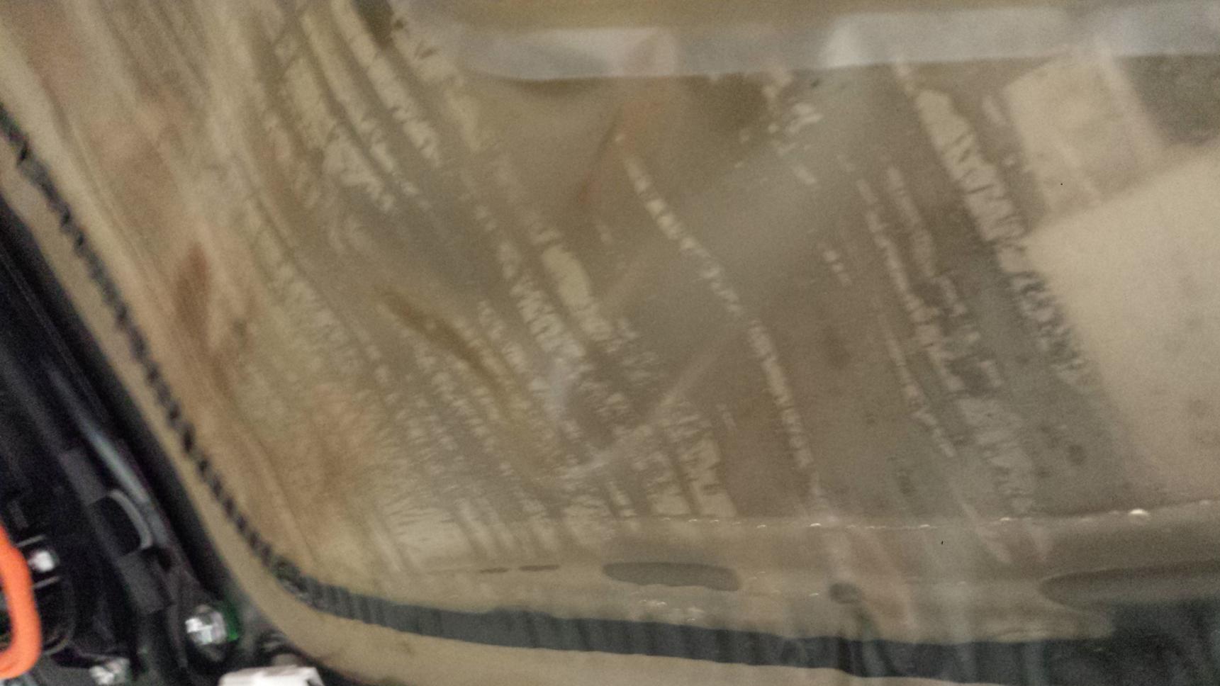

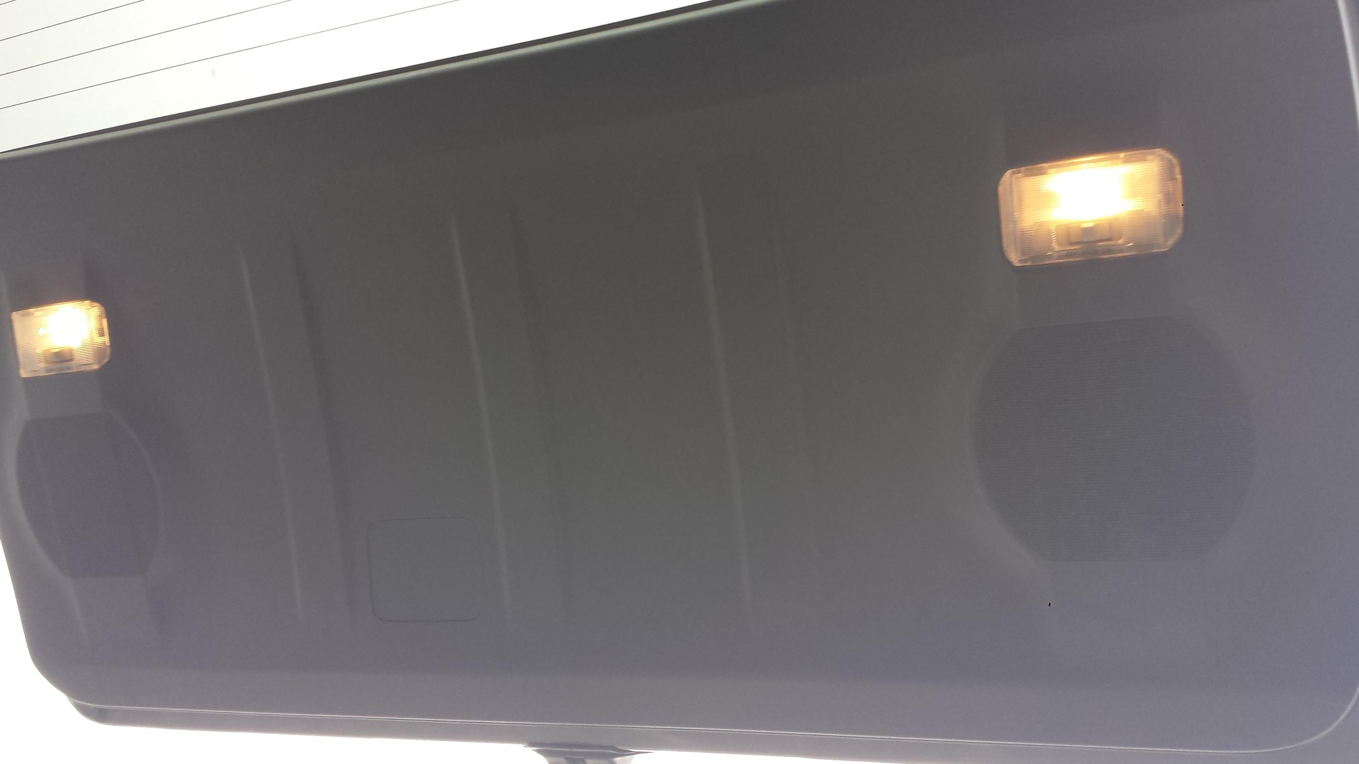

finally was able to get to it... there was a bit of moisture in the hatch but it looked like the seal held up. just to make sure i dried everything off and put it back together. and it works fine! not really sure what happened, i just do not want it to happen again. thanks for all the help from everyone!:banana:

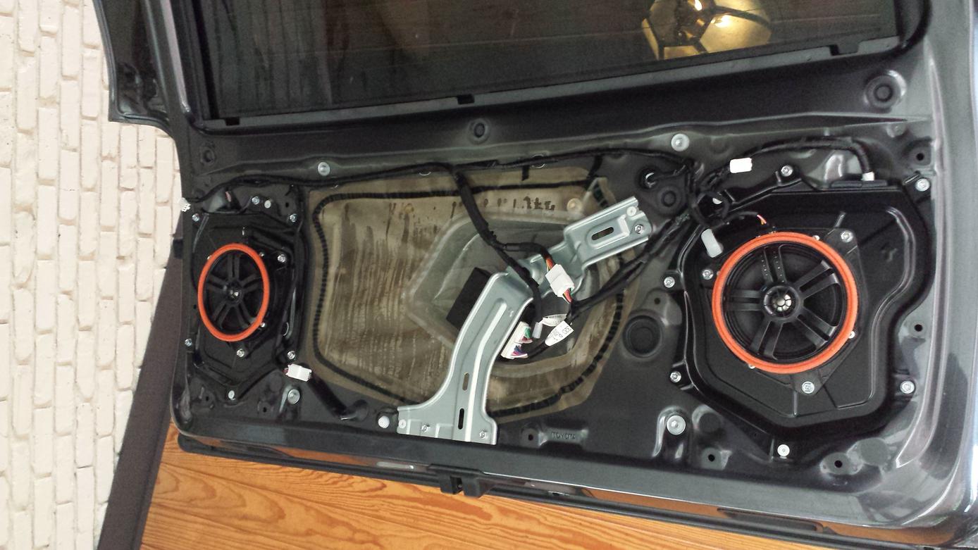

You gotta explain pic #2 brother. Did you take the entire lift gate off? I am stumped at looking at that pic and what it is showing.
sorry about that. no the lift gate is still attached to the truck, i took the inner hatch panel off so i could get to the Multiplex network ECU and dry it off and check for water damage... i did not see any
