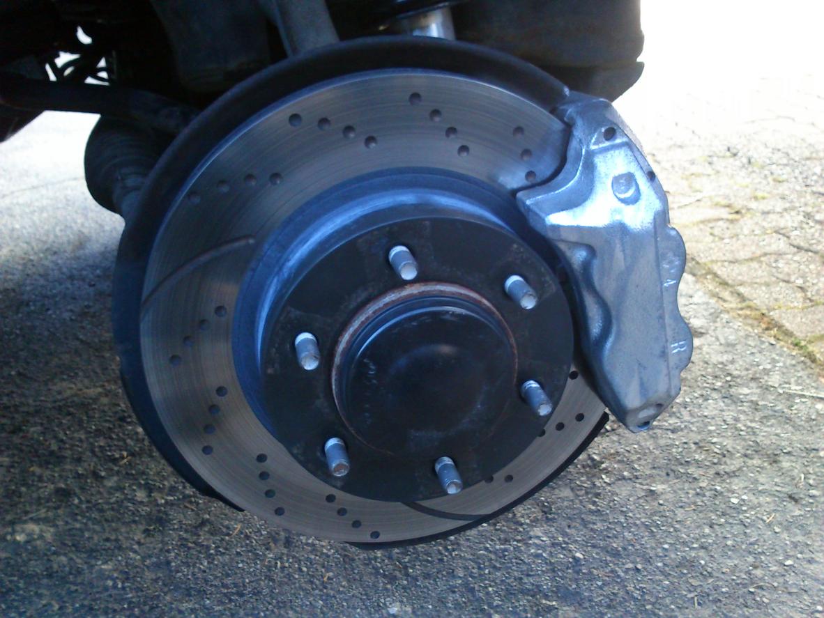

heres a pic of them on my truck...
they have like 2x the power of the oem stuff IMO I really like them
plus I also have them on my 99 Range Rover and they are fantastic.
