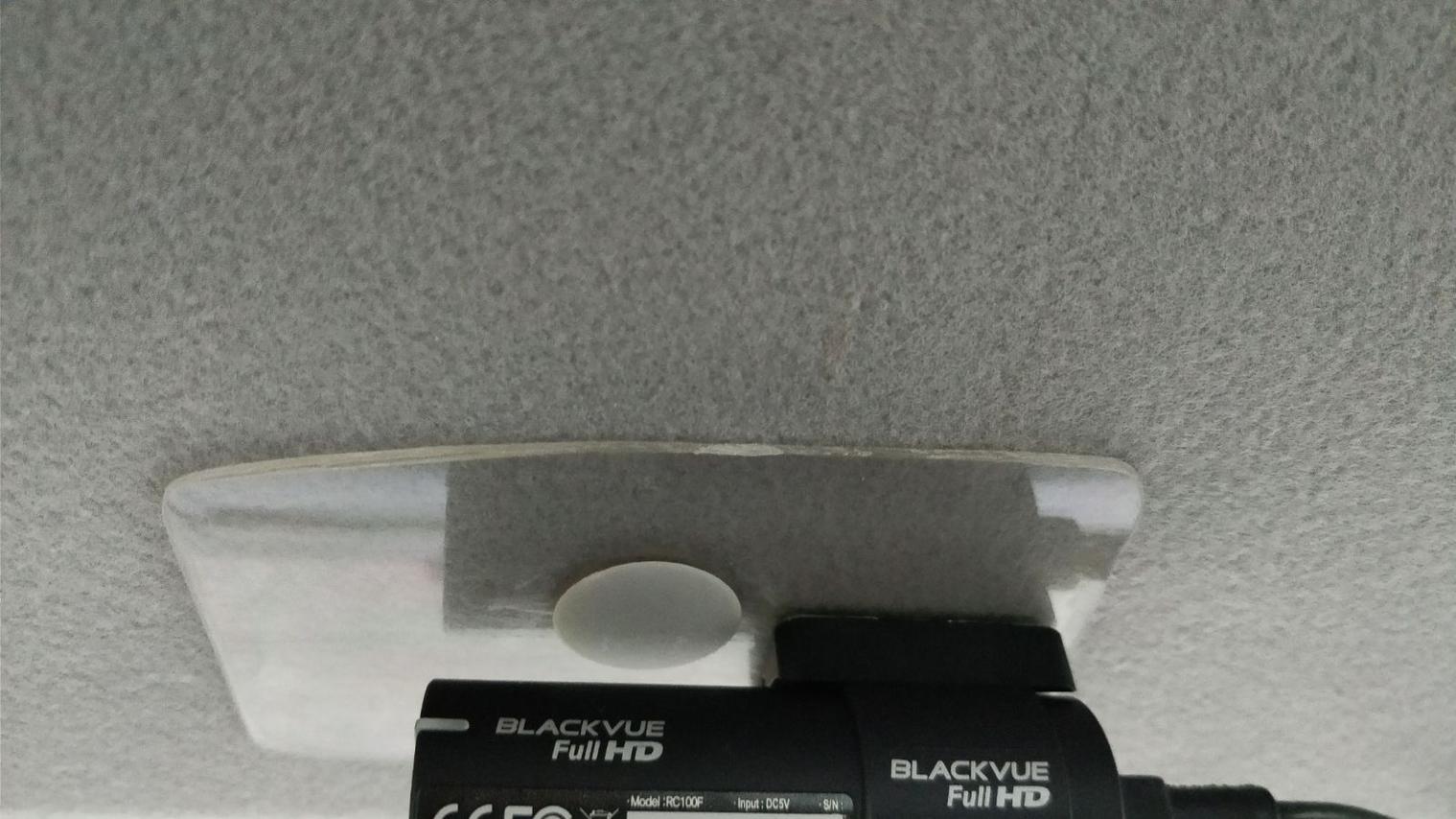

There's a thing called the headliner button mod. I (and others) used the center headliner button to hold a piece of plastic fasioned out of a piece of thin, flat plastic with a hole drilled in it (through which the button goes, reinstalled up into it's hole to hold the plastic tight against the headliner). This gives you a small platform you can stick your rear camera to. The rear camera is very light and mine has never shifted simply being held by one headliner button. You can make this as small or large as you want, mine is about 3 inches long, dremeled out of an old Apple earbud package with the hole drilled in the middle. Has worked beautifully for me since. If this doesn't make sense to you shoot me a PM and I'll send you a picture of mine.

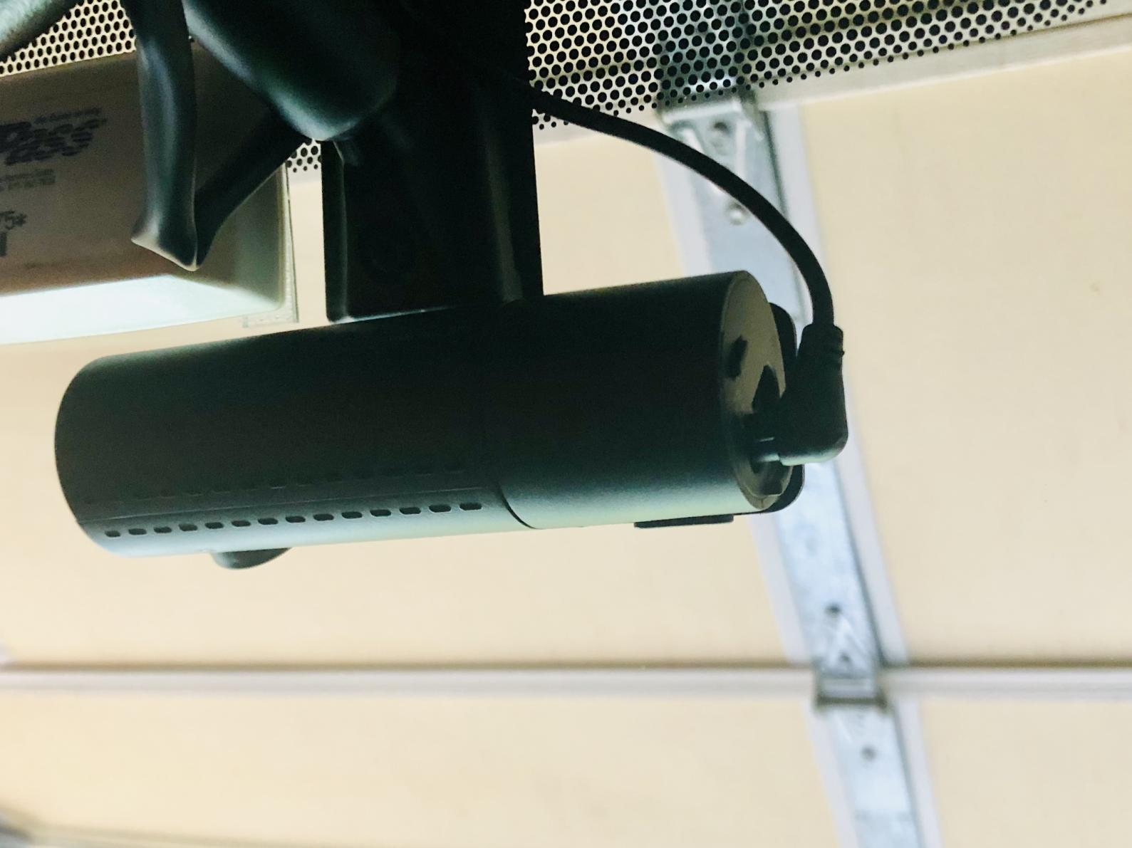

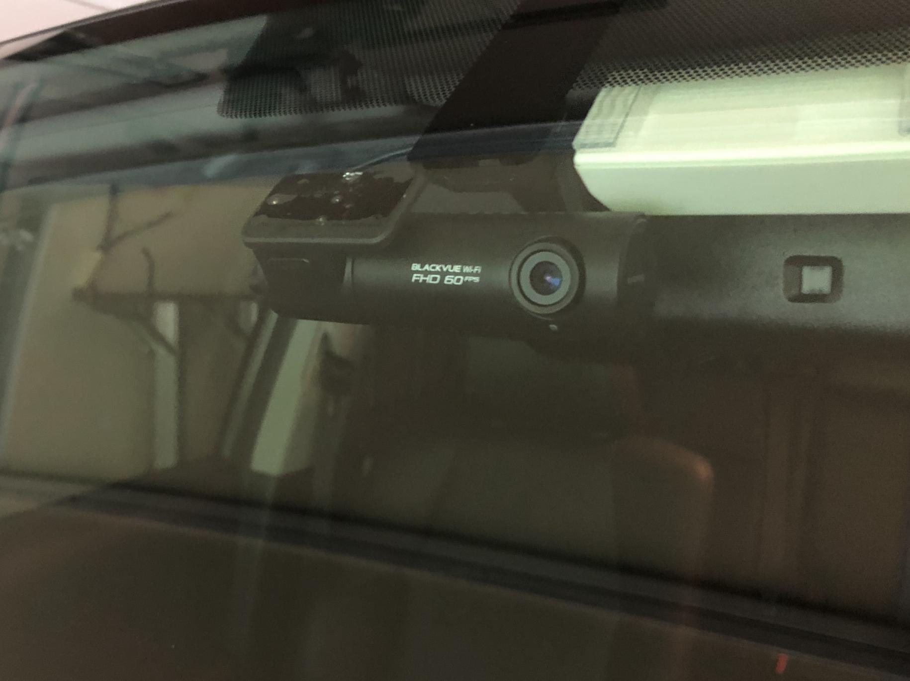

Just a couple of pics of the hardwired blackvue for anyone interested.

Well, it's much easier for me to do a simple search for the one already on the forum so here it is for anyone interested. How do you know I might not happen to be close to a camera and/or my car right now? Another member who posted his elsewhere, who used a larger piece and a "3-button" mod, can also be had with a simple search for "button mod dash cam".

I mounted it very similar to the pic J.F. shared below.
