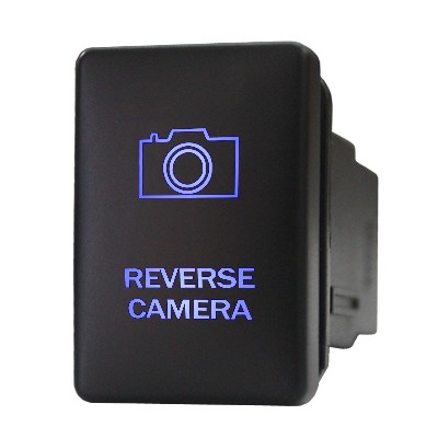

I have a blue/blue on/off AOB switch on the way now.

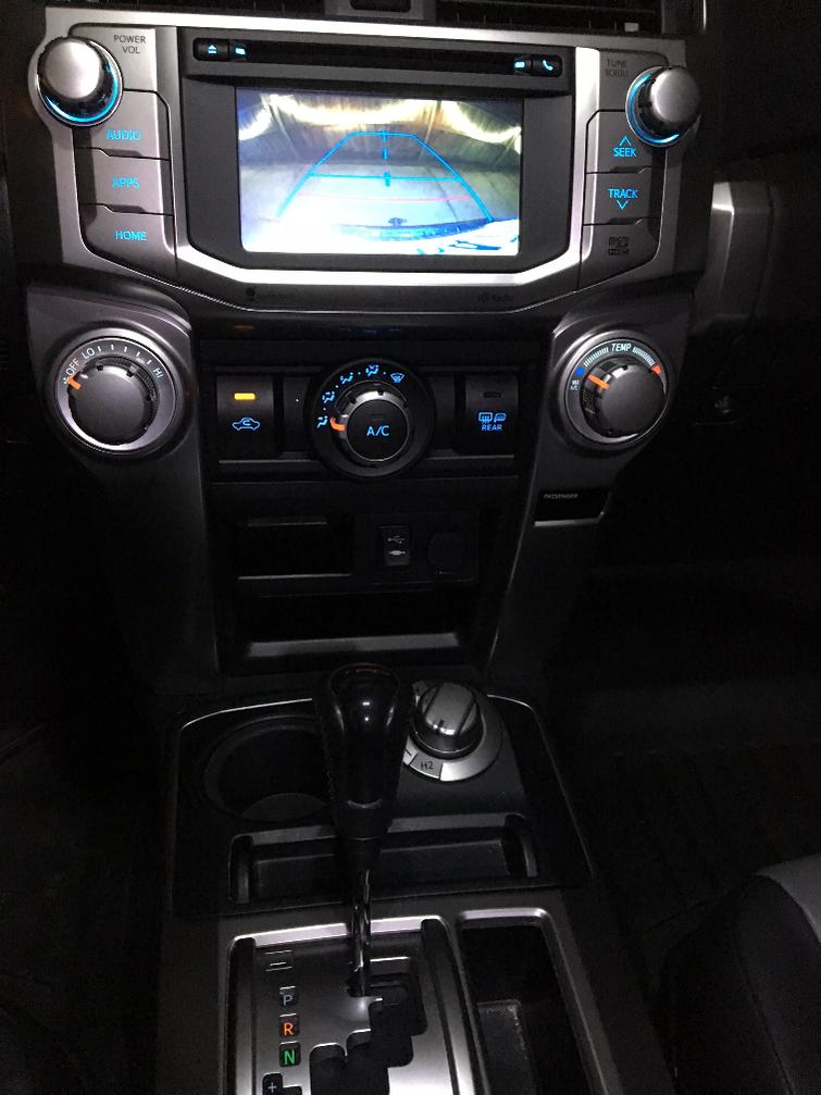

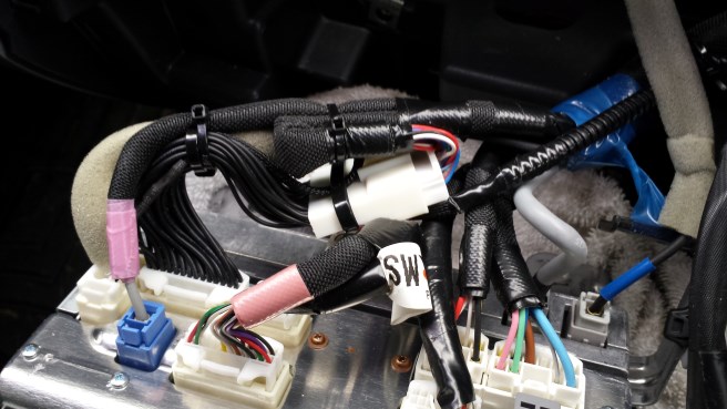

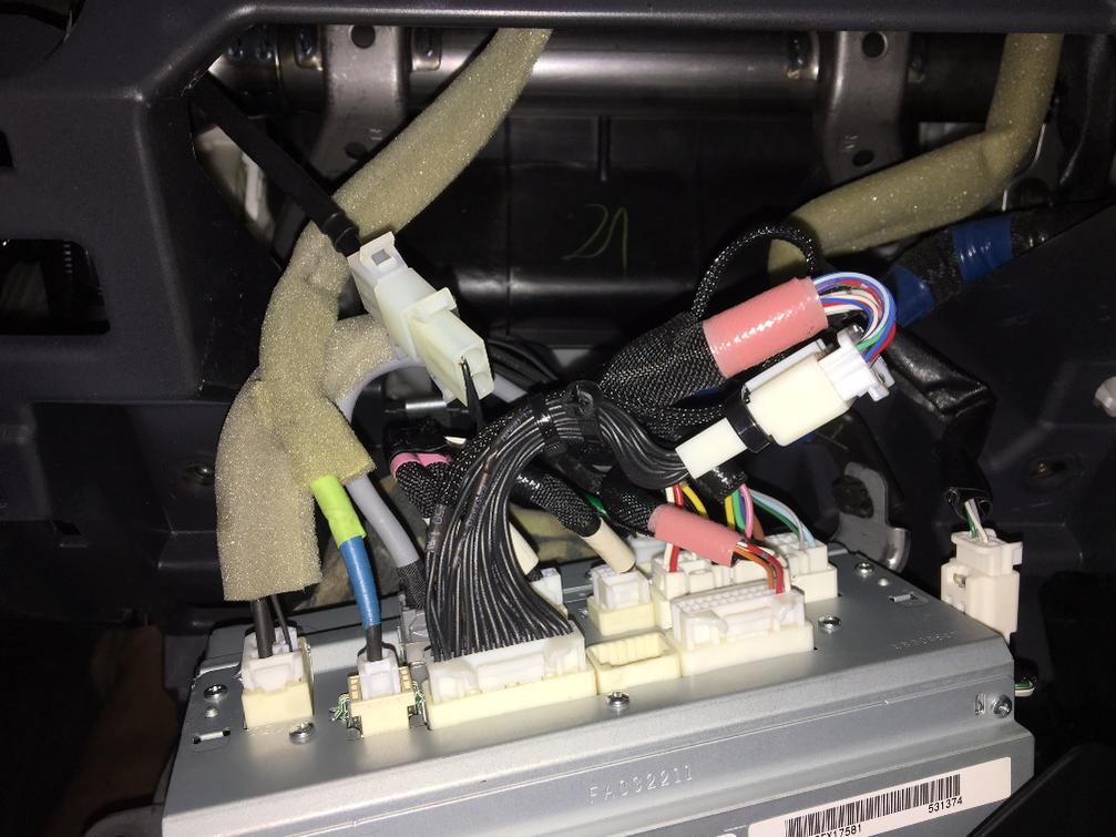

As requested [MENTION=103267]Saker[/MENTION]..................
Dongle installed

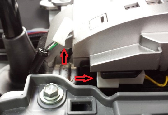

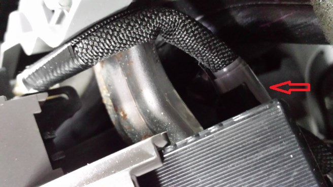

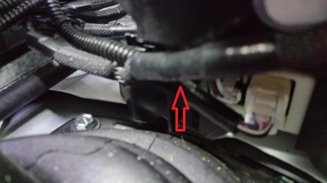

Unplug shifter illumination harness (driver side).

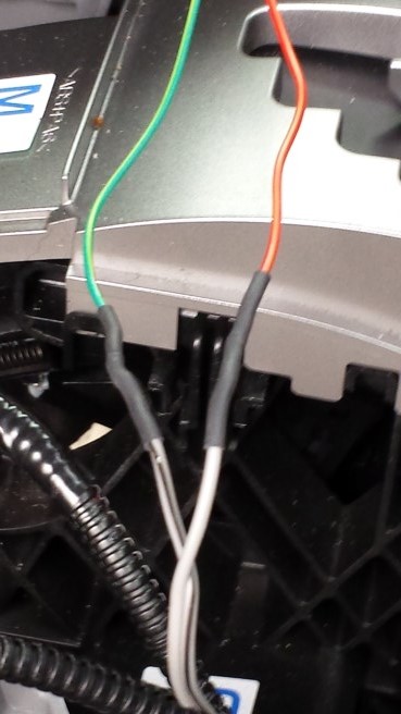

There are two plastic tabs that hold harness to shifter housing, one white, one black. Release both, this will allow harness to be pulled back giving you room to splice into green (+) and gray (-) wires.
Then protect with loom and route wires to AOB switch. Connection to green and gray wires were made just beyond black tab as indicated by red arrow.

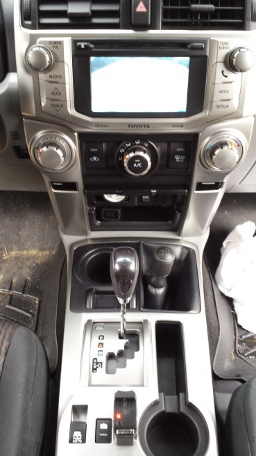

Connect dongle wires to AOB on/off switch, protect with loom. Test for proper operation prior to reassembly
Back together and working slick as sh!t
Many thanks to [MENTION=129513]bjohnston115[/MENTION] for quick shipping, and a quality product! :thanks: :thumb: :becky: :cheers:
Highly recommend to anyone interested!

You can also tap into the 22 pin harness under the center console. This supplies the illumination wires for the factory seat heaters that are not used for the majority of trucks. That is where I tapped into for mine. Thanks for the praise.
I have contacted a supplier and will be working on bringing in the switches to fit the factory cutouts. Keep checking my site for updates. They will be less expensive than AOB switches.

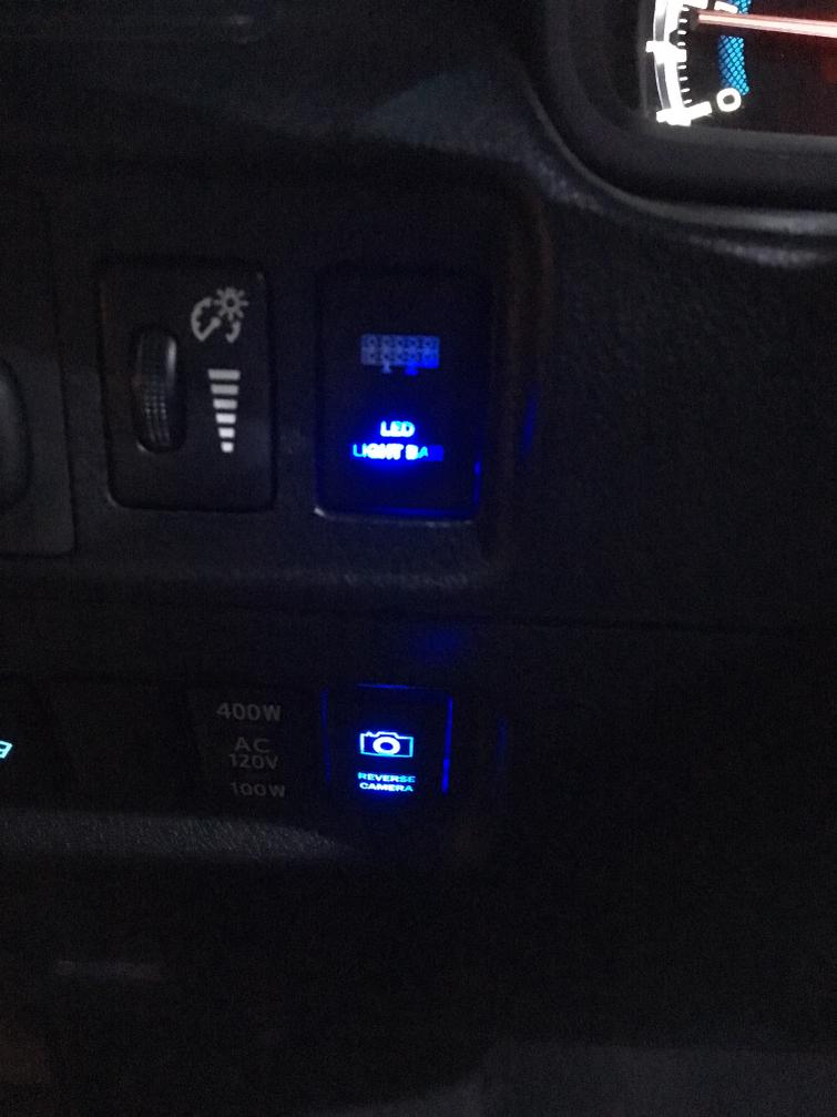

Thanking [MENTION=129513]bjohnston115[/MENTION] again for this mod!
My install went off without any issues. Rear camera still works as normal.
Depress the AOB Rear camera switch when in any gear, camera comes on.
AOB Switch dims properly just as the other switches do.

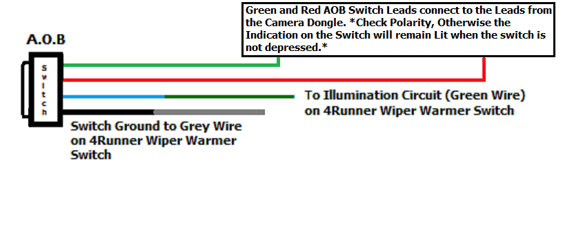

Wiring diagram and install pics.....
EDITED to reflect polarity when wiring switch so the Camera Indication on the AOB Switch is not lit when the AOB Switch is not depressed and rear camera is not in operation.
